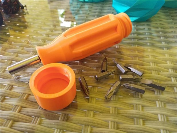

    This is just a screwdriver handle with few magnets on the inside to hold the metal part, I put a screw on cap on it to keep all of the things inside, I love love this thing.

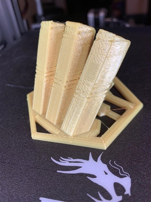

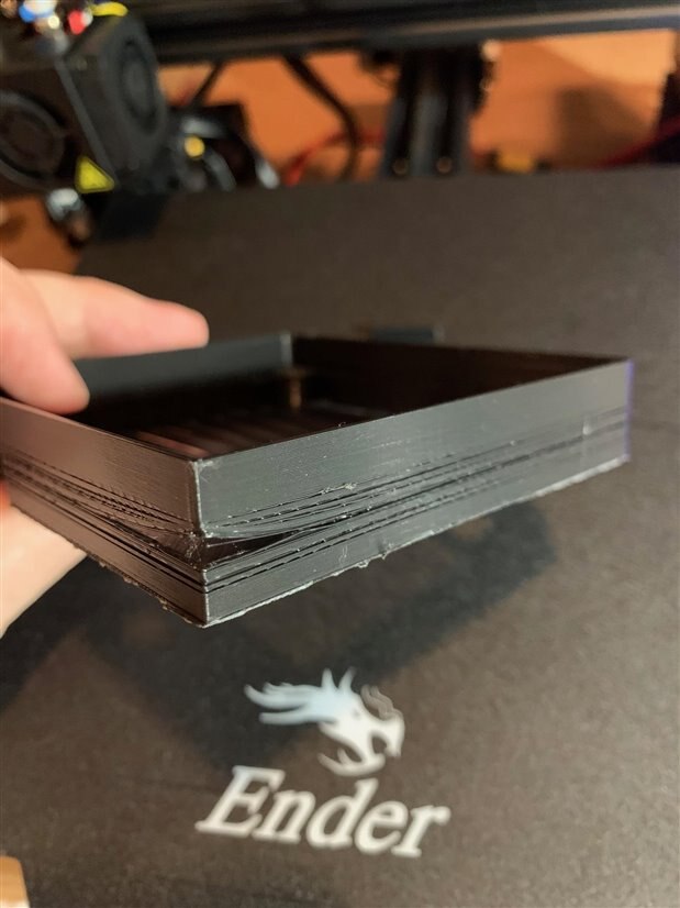

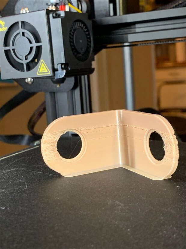

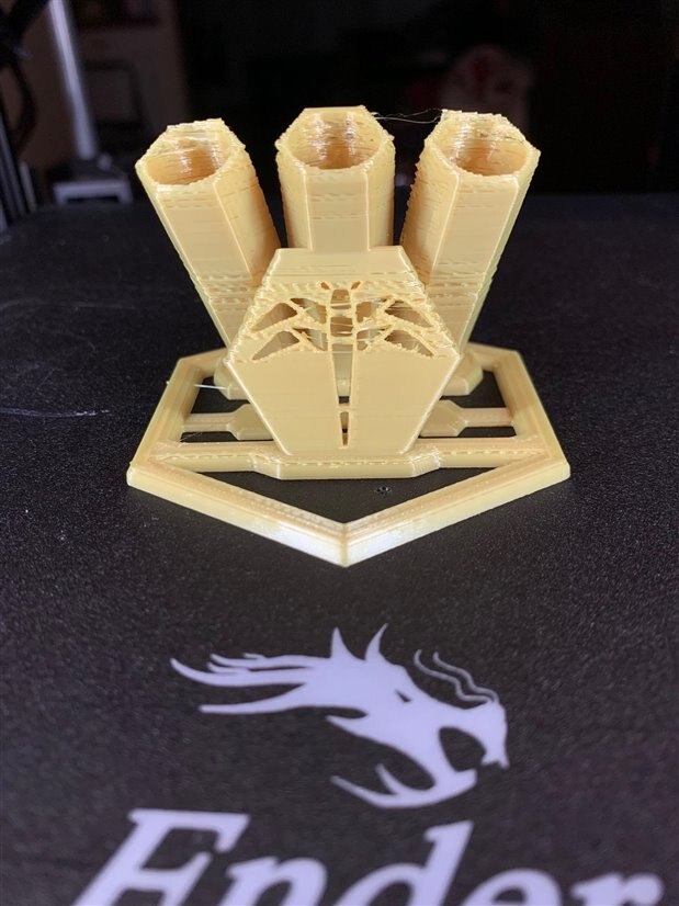

    Hey look, pictures!
    Here's some of the under extrusion problems I've been having. I think most of it is due too retraction settings, although I was having some problems with clogging until I redid my hot end. I'm still tinkering around with it, but took time to print a bunch of face mask ear-savers, which I had no problems doing.

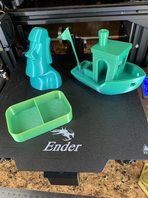

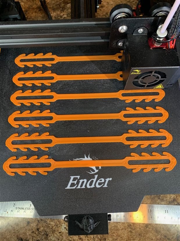

    I posted some pics of the bad prints in another post here. But also, here's pics of the ear-savers I'm making along with some of my better prints. The bench is at 200%. My daughter loves it. The black ear-savers I'm giving out to people that need them, the orange are for my daughters school, orange is one of her school colors.
    I haven't installed the extruder yet, I'm waiting on a direct-drive kit that the US Postal Service seems to have lost somewhere between Florida and Texas. I would just install the extruder first, but I'd like to be able to work out all the bugs at once.
    I have the Creality enclosure, but haven't put the coving on it yet as it's not needed for PLA. I just have the tubular frame set up and it holds my LED lighting. I'll be sure and post my experience with the extruder when I install it.

    It seems too fast and/or too cold the extrusion.

    rstone over 6 years ago in reply to balearicdynamics
    Thanks!
    Most of those were before I figured out the hot end and tube. But yes, the tube needs to be tight against the nozzle and not move. The best way I've found to deal with it is in this youtube video,https://www.youtube.com/watch?v=7tCxO17XZtw
    He explains it better than I could, and after I did what he suggests it helped a lot.

    Those are nice clean parts.
    DAB over 6 years ago in reply to rstone
    Very clean parts.
    Now I want one.
