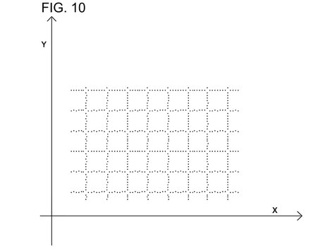

  • morgaine
    morgaine over 12 years ago in reply to shabaz
    shabaz wrote:
    if there was (say) a rule with (say) markings every 0.1mm, and numbers printed every cm just like a normal rule (or some barcode type pattern instead of a number), and if it was parallel to a linear rail and close to the travelling block, then a camera on the block with 1000x1000 resolution that was focussed on a (say) 2x2cm area could easily precisely measure where it was, and use OCR to know the exact position because at least one number would always be fully visible.
    Yep, that sounds entirely viable, and I think it can be done in two different ways.  One way (1a) is to make the absolute position markers for OCR occupy a defined box size and have a known positional relationship to the grid pattern between them and OCR being performed continually during movement, and another way (1b) is to scan for an area within the field of view containing self-syncing blocks of reference pattern (no OCR) and use those for the relative speed and direction reference --- OCR areas can then be ignored during traversal but used for calibration and periodic confirmation, which is less intensive.  I like both ideas.  (There is a downside though, namely low precision since the camera senses a relatively wide field of view.)
    Another approach (2a) that I was considering uses spaces in a regular reference grid of dots to carry metadata about absolute position of the reference grid.  This would allow for very high magnification (tiny FoV) so that only a very small area of the pattern needs to be examined at any time during traversal (3x3 dots should be enough), which would result in very high sensitivity and precision and very low processing overhead at the same time.  If any one of the 9 dots is missing it is simply ignored for speed/direction feedback, yet a pattern of such "holes" can be used to carry metadata which builds up during traversal, so no OCR is needed.  I like this idea not only because of its high precision and sensitivity but because the speed and direction processing will be so fast that the feedback will have very low latency and hence will cope with faster movement of the head.
    And since the cheap cameras that one would be using would inevitably have colour sensors, there's another very obvious variation to this theme:  use the 3x3 dot array for fast speed and direction processing, but use the colours of the dots to encode absolute position labelling (2b).  This would even increase the already high speed advantages of 2a, since there would be no exception cases of missing dots for it to consider.  But colour can be used for a lot more than that --- imagine encoding two orthogonal graticules using different colours (2c), or using multiple colours to encode reference grids with different resolutions simultaneously (2d).  There's an awful lot of new flexibility obtained once colour is added to the solution space.
    I've labelled these approaches in case we want to reference them, but I'm sure there are countless others.  This is a really fun area where the mind can be given free reign to seek alternatives.
    Morgaine.

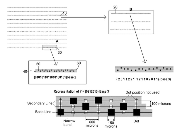

    shabaz over 12 years ago in reply to morgaine
    Here is one method someone devised.
    It would be nice to have some open source engine that could be used to detect position from an image, and some software to generate the co-ords of where to print dots on a surface.
