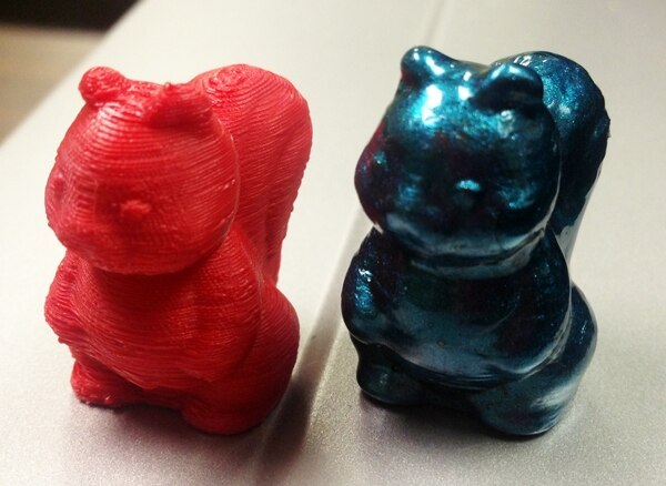

fustiniadmin was kind enough to print me up a cute little squirrel, then stick it in acetone for about 30 minutes to smooth it out.  We had long wondered what they would look like painted, so over the weekend I whipped out my (giant) collection of nail polish and painted this little guy a metallic teal.
I really like it. It smooths out the lines nicely and give it a good feel. What do you think??

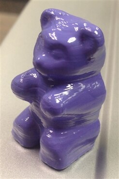

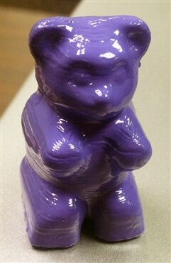

He has an aceton-ed gummy bear I'm painting later this week.....

    Here's the the latest critter... community.element14.com/.../7633.contentimage_5F00_176373.html
  • Nate1616
    Nate1616 over 12 years ago +2
    Acetone baths make the parts look as though injection molding was used. This is also a great way to clean off any artifacts that is left on the part after printing. Nate

  • fustini
    fustini over 12 years ago in reply to Nate1616
    Nate1616 Do you get discoloration?  For PLA, I've found it turns white after coming out of 100% acetone bath for 30 minutes.  It seems to react with the air.
    Is there specific brand of acetone?   I just bought 100% acetone nail polish remover (clear, no color) at Family Dollar

  • Nate1616
    Nate1616 over 12 years ago in reply to fustini
    PLA and acetone do not work like ABS and acetone.  The white you are seeing is actually from small bubbles when the PLA comes in contact with the acetone.  PLA is normally amorphous but when in contact with acetone turns into a crystalline. The parts will become very brittle.   Slightly off topic but interesting is if you adjust the Ratio of Acetone/ethanol you can have influence on the crystalline layout (sorry  my Chemical Engineering background coming through). If you want to smooth PLA the best chemicals would be Tetrahydrofuran (THF) or Dichorlomethane (DCM) but would recommend using THF as its safer to use.  THF has better results with PLA 4032 not 4042/4043.

  • Problemchild
    Problemchild over 12 years ago in reply to summerella_nonadmin
    Good effect, almost looks enamelled!
