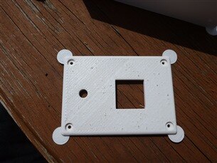

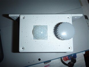

    I agree with IP, it is not necessary to leave it to the slicer, see this example of something I did for my Kitchen Full BOX and lid Hope this will help

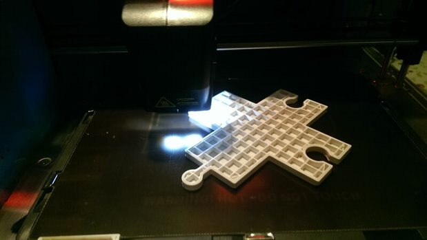

    IMHO i would not leave anything upto the slicer. There are two ways about going into print for an object.
    1. For a hollow object, just split it in two and then shell both the halves. Then print them as separate objects. Make sure you add some notches to align the printed halves and then use super glue.
    2. For hollow grill like objects or the like, export an STL and then add supports in mesh mixer. It allows you to do supports, and all that stuff.
    Hit print, fingers crossed and tongue at the right angle... image
    Bam!
    Full BOX and lid
    Hope this will help
