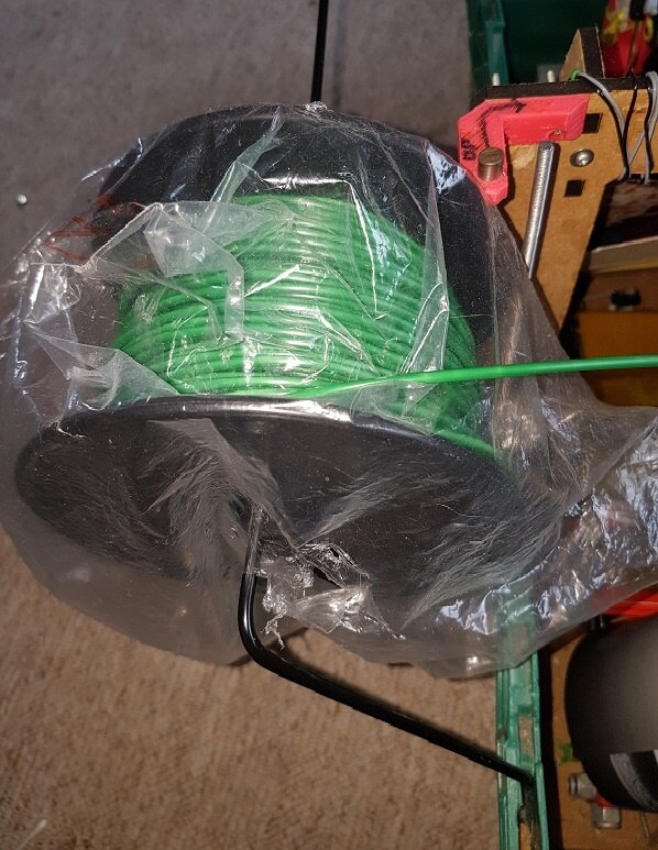

    0 gregoryfenton over 10 years ago
    I regularly change the colours of the materials I use meaning that I have lots of partly used rolls.
    The simple technique I use is to put each roll in a bag, pierce a small hole for the filament to pull through and a hole through either side to mount the spool.
    Drop a few silica gel packs into the bottom of the bag and you're done.
    When you want to change the spool for another one push the filament back into the bag, tape over the holes and you're done until next time you need it.
    This also has the added advantage that dust and other contaminants are kept away from the spool.
