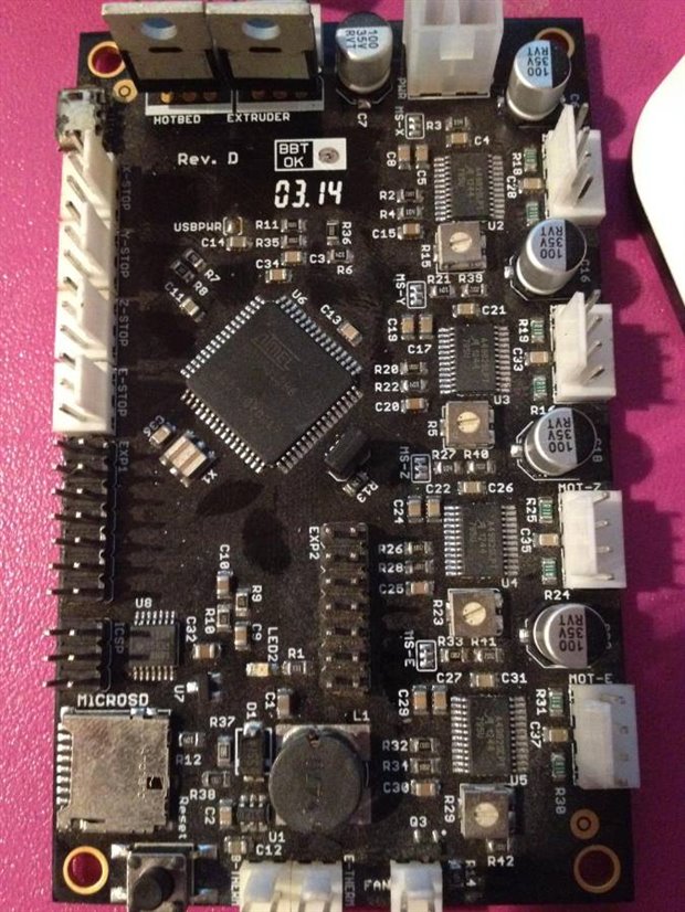

Hi there
I recently found this at a local goodwill store:
I instantly recognized it as a control board from a 3d printer because the MOSFET are marked as Hotbed (left) and extruder (right) and picked it up for $3. However I cant locate what type of board it is and would like some help finding out what board it is so that I can build my own printer
  • clem57
    clem57 over 10 years ago +1 verified
    Printrboard - Geeetech Wiki Clem
    balearicdynamics over 10 years ago in reply to clem57 +1
    I have one of these and works fine. If you need help, let me know. I have also a good contact with Geeetech tech support and a couple of copies of the firmware sources (Arduino based) that may help. E…
    e14 Contributor over 10 years ago in reply to balearicdynamics +1
    Hey thanks and I will take you up on the offer

    0 e14 Contributor over 10 years ago in reply to clem57
    Thanks now I can get started
    0 balearicdynamics over 10 years ago in reply to clem57
    Enrico
    0 e14 Contributor over 10 years ago in reply to balearicdynamics
