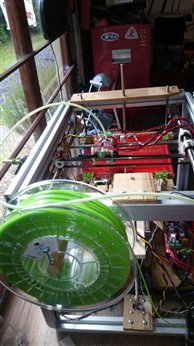

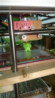

  • danielw
    0 danielw over 9 years ago in reply to rachaelp
    I've built one, from scratch, and you're right.  I spent ages, and ages, buying bit's and designing parts, over engineering, and messing about and not actually building anything.  In the end one weekend I thought that's it, and whacked it together out of that parts I had and bits of wood.  A year later and I'm still updating bits and improving it, but that's part of the fun and I can print stuff too!  and it's surprisingly good!  I think the sturdy frame to hang bits off made it all a lot easier.
    One of my issues is Z Wobble caused by a wobbly Z axis.  I'd expect to see the same with the machine above.  It's one of the next things to address!
    EDIT:  I ought to say, this was one of my first prints.  even with all the wooden parts it got a lot better as I tweaked it.
    Also thought to add, we have a CEL Robox at work, and it needs maintenance every now and again.
