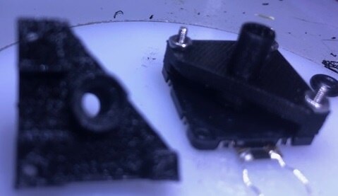

I am still having fun with my 3D printer!image  But I have run into a bit of a challenge.  I am trying to build a 'Hat' to sit upon a tiny Micro Blower, so I can plumb up a airflow meter for testing.
Here are some (out of focus) pictures of the part (mounted and un-mounted) along with the design images:
The problem is with the small inset port on the bottom of the part.  This is a cup for a tiny o-ring.  The opening is very rough (like due to the scaffolding added by cura, as the port is on the bottom), and air appears to be leaking around the seal.  I have heard of people using Acetone to soften and smooth out ABS, but is there a similar way to do this on PLA?  Has anyone had any luck sanding surfaces smooth with PLA?  I guess that I could invert the part (scaffolding along side of the exhaust port), so that the finish might improve. Might that help?

    Acetone works for PLA aswell. You can try tetrahydrofuran, or THF, also. Clayton

    Hi Gene, I don't know the answer but I have used silicone glue in the past to seal the back side of an o-ring in some dental equipment situations. I wanted to reply so I will follow this thread in case…
    0 jw0752 over 8 years ago
    Hi Gene,
    I don't know the answer but I have used silicone glue in the past to seal the back side of an o-ring in some dental equipment situations. I wanted to reply so I will follow this thread in case someone does have a good answer.

    I hope all is going well for you.  Thanks for the reply.  I have tried to use a little light oil (food grade grape seed oil) and I have ordered some food grade grease to try also.  The grade seed oil helped but did not eliminate the leakage. I am currently re-printing the part upside down to see if the cup for the O-ring comes out any smoother (without the extra scaffolding inside the cup).  I might also try the silicone glue as you suggested.
    Funny how all this works.  I am doing this project for a client and halfway through it I can now see better ways to do this.  I have already approach the client about a slight re-do on the PCBs to eliminate multiple interfaces where air might be escaping.  Live and learn.
