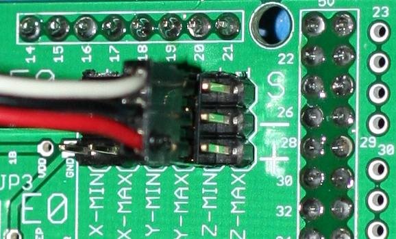

I've been trying to get a Rostock based delta printer running, but am having problems with the firmware. I'm using an Arduino MEGA with a RAMPS 1.4 board. Right now the main problems seem to lie in homing and heating the hotend. The wires are connected to the hotend as I've been able to heat it using an external power supply.I have also tried the modified Marlin code that the Rostock has pointed to, and only been able to make the motors move individually with no real intelligent direction, mostly just gcodes and putty commands. I was told to use repetier, and I'm starting to use it now, but it's still not fixing these problems.

    Hey Garrett
    I would have to say that you don't have the marlin delta firmware correctly configured.  It sounds like you have the right firmware but make sure this is the one you're using https://github.com/jcrocholl/Marlin.  Here are a couple more links to check out http://reprap.org/wiki/Rostock Reprap development and further adventures in DIY 3D printing: Rostock Delta 3D printer build.  Now as far as if you need Repetier or lets say Pronterface that shouldn't be causing the problems you're seeing.  Let me know if this helps you.
    Nate
    0 e14 Contributor over 12 years ago in reply to Nate1616

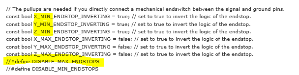

    Thanks Nate, i compiled a new copy of the firmware to my printer. It will start to home now, but it only travels about 38mm before stopping short of the endstops. When I do repeat the homing command and allow the carriages to hit the endstops they don't respond, and continue until the command is completed or I reset the board. The endstops are currently wired to be normal open, and complete the circuit when when struck.
  • Nate1616
    0 Nate1616 over 12 years ago in reply to e14 Contributor
    Hey Garret
    Just off the top of my head did you happened to change  X_ENDSTOPS_INVERTING to be true in the configuration. h file.  Since you are using "Normal Open" this needs to happen otherwise like you state when the endstops are hit nothing happens.  Otherwise can you send or add your configuration.h file so I can look at it.
    Nate
    Below is the configuration.h file.

    // The pullups are needed if you directly connect a mechanical endswitch between the signal and ground pins.
    const bool X_MIN_ENDSTOP_INVERTING = true; // set to true to invert the logic of the endstop.
    const bool Y_MIN_ENDSTOP_INVERTING = true; // set to true to invert the logic of the endstop.
    const bool Z_MIN_ENDSTOP_INVERTING = true; // set to true to invert the logic of the endstop.
    const bool X_MAX_ENDSTOP_INVERTING = false; // set to true to invert the logic of the endstop.
    const bool Y_MAX_ENDSTOP_INVERTING = false; // set to true to invert the logic of the endstop.
    const bool Z_MAX_ENDSTOP_INVERTING = false; // set to true to invert the logic of the endstop.
    //#define DISABLE_MAX_ENDSTOPS
    //#define DISABLE_MIN_ENDSTOPS
    // Disable max endstops for compatibility with endstop checking routine

  • Nate1616
    Hey Garrett
    Sorry I haven't got back to you on this as it was thanksgiving and now I am away on a business trip and haven't had the time to dig into your configuration file.  I will look at it later this week or the weekend and hope to get you up and running as soon as I can.
    Nate
  • Nate1616
    Hey Garrett
    What happens when you send command M119 to the printer.  What does the command return on the status of the endstops?  Are they triggered?  Now send the command again and press a endstop.  what is the status now.
    Nate
  • Nate1616
    Hey Garrett
    I looked through your firmware and did notice a couple of things.  One this is I noticed you have the x-min, y_min, z_min set to true so this would mean that on your ramps 1.4 board you have these connected to the min connector heads.  Is this true? These should be connected to the max connectors as the firmware looks for max in the pins.h file.  Here is another good website that steps through the setup Kossel Mini - Build A 3D Printer.
    Nate
  • Nate1616
    Hey Garrett
    Nate
