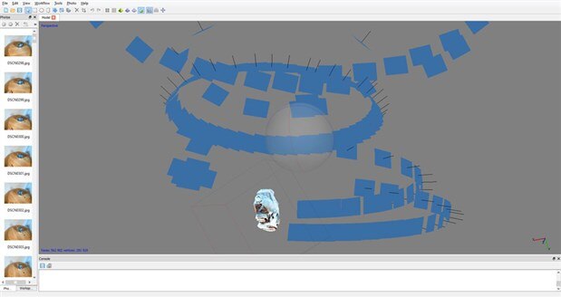

    For the book, I used both the FARO scanner that's best for museum curation because it captures full-color images, as well as the Creaform Go!Scan which provided excellent physical body images of people. both of those are commercial systems, so their use resulted in the highest resolution output, but from hobbyist level equipment, the Kinect did a decent job of mapping my office, all of the stuff on my desktop, my hat on a rack, etc. I have seen the results from hand-build DAVID laser scanners and the MakeBot scanner Bre Pettis put out, and both of those do a fine job for smaller items that fit in their scan space.
    I also had great luck using photos from a common camera (I use the same Nikon to shoot pics of the kids usually) together with photogrammetry software. I had similar results from the free "123D Catch" from AutoDesk and the low-cost commercial PhotoScan from Agisoft. Agisoft's products just made stitching the photos together a little easier between the two. The image above is a capture of the "Oscillation Overthruster" from the movie prop for Buckaroo Banzai using the Agisoft Photoscan package.The resulting OBJ file can be translated into STL for printing, and carries the complete full color details as well as the manifold shape definition.

    Nate is very correct with regards to reflective surfaces - and the same is true whether you are using photogrammetry, laser scanners, structured light scanners, or IR scanners like the XBox. An easy way to capture the shape of a reflective surface is to cover it with an opaque medium - from paint to powder, anything that renders the surface opaque to light will allow it to be captured into a 3D reference model.
    And, yes, for photogrammetry, the AutoDesk Cloud processing is much nicer than running the same process on your own machine's resources. The rendering I posted before took almost 8 hours using a dedicated i7 Quad-core Ivy Bridge CPU, 32 GB RAM and a NVidia 740 GPU.

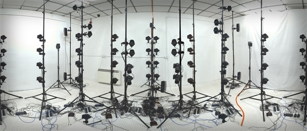

    The artist Lee Smith who put me onto Photogrammetry at his Infinite Realities studio (Infinite-Realities - 3D Scanning and Character Creation) has a blog that talks about 3D model capture of living subjects that may help give you some ideas of techniques. His rig is a bit nicer than most of us will have, of course:
