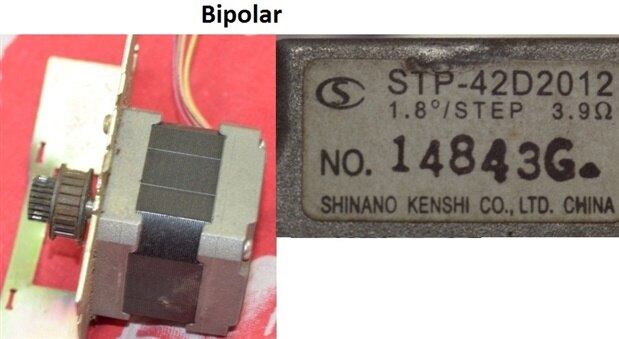

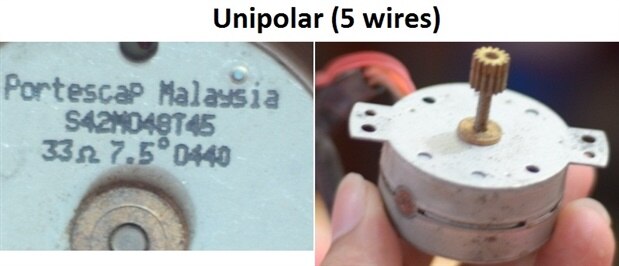

Its quite a hard project as I have no idea about the electronics related to this thing. I still have few months to decide, so... anyway, first I am building a desktop plotter to try out my limit and I bought two old dot matrix printers and got two bipolar stepper motor assemblies (along with the carriage and belt) and two unipolar motors.
I tried to run these with a L298D IC with an arduino, but the IC burnt after a few seconds. The current might be high. How do I measure the current? These look like NEMA 17 motor. Can I use a ULN2803 IC for running these? How about the easy driver shield from sparkfun? (http://www.ebay.in/itm/EasyDriver-Shield-stepping-Stepper-Motor-Driver-V44-A3967-For-Arduino-/261670095717?pt=LH_Default…)

    Brad, that's 300 rupee's not $300 so about $5.
    Rajdeep, you can get a rough approximation of current from the 33Ω and 3.9Ω labels, I = V/R
    Assuming a 5v supply.
    First motor 1.2A x 2 coils so that's 2.4A.
    Second motor 0.15A = 150mA, you have 2 coils energised per step so that's 300mA.
    To measure the current you can use a multimeter in series with the coils or use a resistor and measure the voltage over it.
    The ULN2803 is rated at 500mA so should be able to drive these but the sparkfun driver should give you more control. Here's a couple of posts about driving some much smaller stepper motors.
