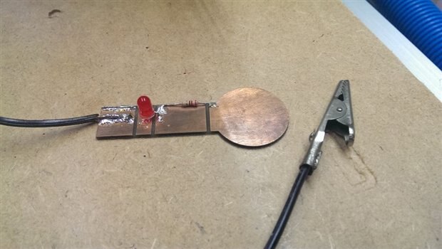

    0 balearicdynamics over 11 years ago in reply to e14 Contributor
    Hello Cheung!
    As I told you before you can't find this specific tool I described just as this has been done by me. Please check the links below to have an idea of how the principle works. I have done the same with a PCB and a silly contact, nothing more.
    http://www.cnccookbook.com/CCMillTipsTechniques.htm
    http://es.aliexpress.com/item/NEW-PACK-OF-2-Z-Axis-Auto-Zero-Touch-Plate-CNC-Router-Mill-Mach3-Engraving/1757239512.html
    And the following image (using the PCB as explained before)

    0 clem57 over 11 years ago in reply to balearicdynamics
    Good photo! Thanks Enrico
    0 balearicdynamics over 11 years ago in reply to clem57
    Thanks Clem,
    this ia a very primitive version. The only thing that should be absolutely well known is the thickness of the PCB as when the tool / nozzle is at zero point, the z-axis should be sent down of the support thickness to reach the real zero of the surface. In the case of the nozzles this detail is meaningless as you need only to align the two pieces together, I suppose.
    Enrico

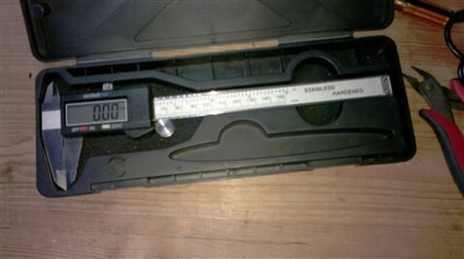

    0 e14 Contributor over 11 years ago in reply to balearicdynamics
    Thank you so much Enrico. Today I am thinking if we can use vernier calipers to test their height difference.

    0 lotusf33t over 11 years ago in reply to e14 Contributor
    You may have better luck with a feeler gauge.
    Vernier will give only as good results as you can hold alignment well. The feeler gauge measures exactly what you are after with no chance of tilt related inaccuracies.

    0 balearicdynamics over 11 years ago in reply to lotusf33t
    I have experienced all the solutions, Jack both with Vernier caliper (almost good quality) and thickness gauge.
    The first is almost unusable and is absolutely not useful when you don't need to make measures in conditions like inside a small space; it is not though for this kind of applications. The thickness gauge instead it is as you say: limited to pre-defined thickness. This may not be a limit in the specific case where an alignment is needed but excluding those very expensive the implicit resolution is poor and there is not option to control the pressure of the tool while going down. Actually I use it only to avoid to read too faster the working surface with the tool. Then when I am at almost the right distance, I use the electronic (or electric image ) tool that react immediately as there is the minimal contact and the test can be repeated many times in the same conditions with the less possible human error.
