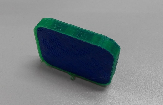

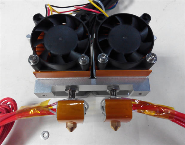

I bought a dual extruder from Geeetech, now I am confused by a question. Because the 2 nozzles are not at the same level, the printed item looks not so good.
As you can see in the picture, the peirimenter is printed by extruder 1, infill is printed by extruder 2. Because the distance between the nozzles and hot bed are different, the perimeter was printed not perfect.
Do you have any idea to have them at the same level?? I will be grateful if you share your ideas. Thank you.

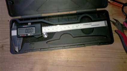

    Thank you so much Enrico. Today I am thinking if we can use vernier calipers to test their height difference.
  • lotusf33t
    0 lotusf33t over 11 years ago in reply to e14 Contributor
    You may have better luck with a feeler gauge.
    Vernier will give only as good results as you can hold alignment well. The feeler gauge measures exactly what you are after with no chance of tilt related inaccuracies.

    0 e14 Contributor over 11 years ago in reply to lotusf33t
    What's the precision of feeler gauge? Can it reach 0.01mm?
    Also, there is another thing we have to mind, that before we use feeler gauge, we must confirm the hotbed itself is level.

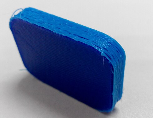

    This is the printed item after I calibrated the height difference by vernier caliper. It looks much better than the former one.
  • clem57
    0 clem57 over 11 years ago in reply to e14 Contributor
    Much nicer except the color image

    Just thinking out loud from my twenty+ years as a mechanical engineer, machine designer/builder-
    1. First adjust one nozzle intentionally clear by 1-2 mm
    2. adjust the other one close to perfect
    3. level the deck
    4. re-adjust first nozzle
    5. adjust second nozzle
    6. have a malt or hop based beverage of your choice (could start this at step 4)
    Regards,
