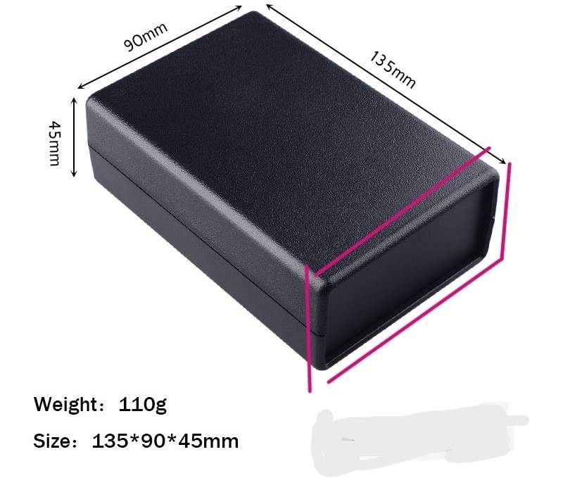

Hello 3D Printer Experts,
  1. Do you think that this mini 3D Printer machine is capable of printing rear and front panels of a plastic enclosure?
  2. Can it print thin panel with small hole, narrow slot such as USB-C 9mm slot, microSD card slot, etc.
  3. Are the printed panels strong enough against standard human handling and shipping?
This is my chosen enclosure.  The size of the panel is about 9cm x 4cm x 2mm.  The red-lined area is the target panel which is detachable.  The factory quoted me US70 for customising a batch of 50 items of this enclosure.  I am considering a 3D Printer for this extra money.  Grin
Thanks for your opinions. Pray

    shabaz 2 months ago +3
    The best thing about those types of enclosures is that the end panel can be a PCB.

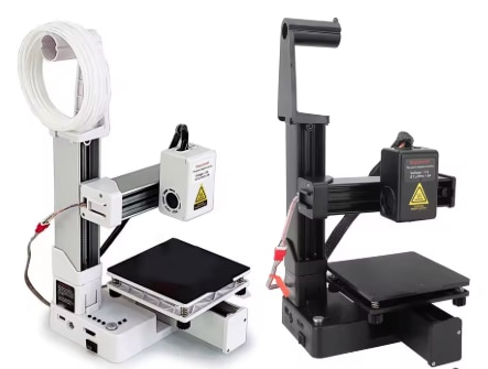

    The two concerns I would have are bed leveling (this seems to require manual bed leveling) and It doesn't mention a heated bed which may make bed adhesion an issue. 3D printing loses its appeal if you…

    Inexpensive 3D printers can be extremely useful tools, but I would pass on this particular one. It is clear that the vendor does not know what he is selling and could not provide support if you needed…
  • HKPhysicist
    HKPhysicist 2 months ago in reply to shabaz
    Did you suggest the front and read panels to be made by the PCB factory instead of a 3D printer? Thinking
    It is clear that the vendor does not know what he is selling and could not provide support if you needed it.
    I don't like the way the filament feeds and in this picture, the holder on the left is shown mounted incorrectly.
    And the speed is extremely slow.
    I guess you could make it work, but I don't think it is worth it.
    dougw 2 months ago
    3D printing loses its appeal if you have to print 3 times to get one good print.
    shabaz 2 months ago in reply to HKPhysicist
    Yes (I often specifically choose those types of enclosures with removable panels, so that I can replace with PCBs).
  • HKPhysicist
    Your suggestion is a COOL option!  I can order PCBs with silk screen for no extra cost!  Heart eyes  I am also able to design simple PCB with Kicad v10!
  • HKPhysicist
    HKPhysicist 2 months ago in reply to dougw
    Big issue of reliability.
  • arvindsa
    arvindsa 2 months ago
    These type of 3d printers aren't big on accuracy out of the box. And and others suggested ,  end panel can be a pcb. Cheaper and accurate and you'll have silk screen also. you can get many panel mount components also which will work well the pcb.
