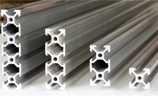

I've been looking online and excluding adds from 80/20 and promotional videos I cannot find much on using aluminum extrusions. I'm building a CNC mill (technically rebuilding a terrible wood version) and I'm just wondering if anyone here knows the basics of using t slot extrusions. I know it should be simple, but there are dozens of various connecting devices and I'm not entirely sure each works, especially the cheap ones which are the ones I'm looking at. I just need to connect some 45mm extrusions end to end, side to side, and attach a couple plastic parts along the sides. Anyone now the simplest, easiest way to do this?
Thank you and have a nice day.

    As it happens I am in full swing with a CNC tutorial series and I am using 40x20, 60x20 and 80x20 V rail extrusions which is one of the goto aluminium extrusions for home build CNC machines based on the OpenBuilds standard parts
    https://www.youtube.com/watch?v=xruKeUHLCC4
    https://www.youtube.com/watch?v=l1uCW46pxK4
    https://www.youtube.com/watch?v=dgkmq3th3ho
    And I am currently editing the electronics footage and making my first cuts
    posting your plans would be a good start so I can see your intent and I will be better able to help with your initial question
    also openbuilds can be seen here http://www.openbuilds.com
    So if you have questions, please ask away
    regards
    Peter

    One thing to note is that quite often each profile of extrusion will come with it's own set of fixings corner pieces, brackets etc so you really need to know which ones you want o  use or at least keep it as generic as possible.

    The V Rails of Open builds and the 8020 rails are of the same nominal dimentions for many of the parts
    ie
    80mm x 20mm
    60mm x 20mm
    40mm x 2mm
    20mm x 20mm
    the difference being that the v rails have a V in the slots to allow the wheels to run true, self centering and with more surface contact and does not require additional bearing surfaces to be added, at least not for lighter use solutions
    Now if your going to make a large build like mine (1500mm x 1500mm) then you may need to double up on parts or add standard T 8020 based rails in say an 80x40 size for additional rigidity etc.

    Thanks guys for all the info, Peter that is an awesome project, and those open builds look great. If I can find someone that sells open builds in Canada I'll definitely go with that. One question though; I've been looking at 80/20 and similar extrusions and a lot of them have things like these;Buy 80/20 Double Flange Linear Bearing | CPI Automation. Anyone got any opinion on those? They look easier to set up than bearings and wheels.

    There easier but not as accurate in the long run. the wheels and bearings will allow rapid and accurate travel over the rails without having much friction, that is part of why the open builds are so popular, for a small to medium test jig they may be ok, but for CNC work, nope.
    Stick with bearings and wheels as a start and if you need more robustness go to linear bearings (Much more expensive though)
