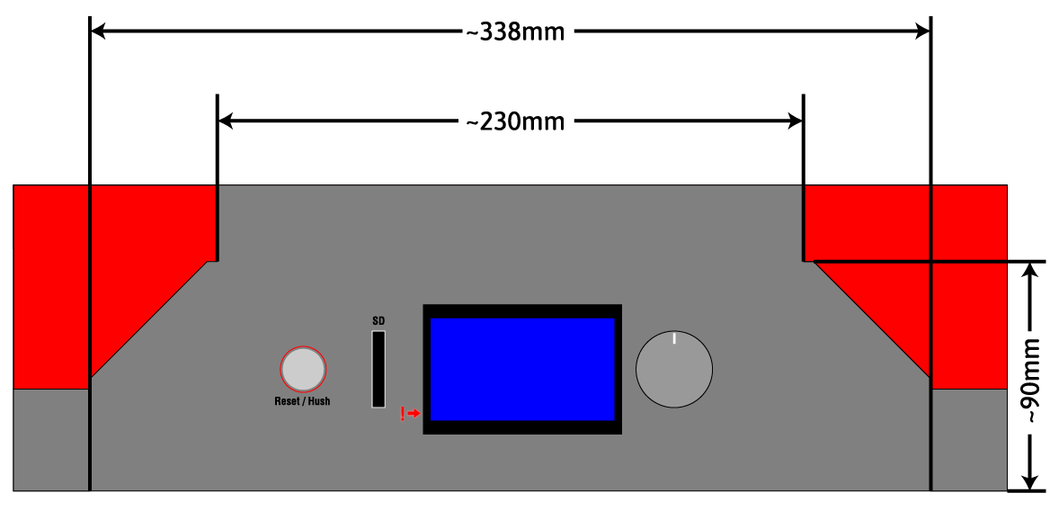

The control panel layout looks like this, and I can use up to 20mm thick module:

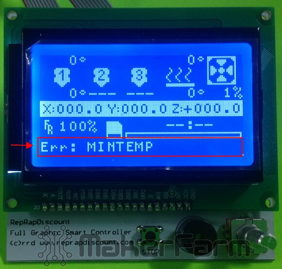

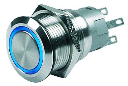

    Yes, that's correct. It'll have a "listener" board that plays sounds and taps into Reset pin of the controller board so it can kill the printer when the main button is being held down.
    The UI is actually displayed on this line through Show Message command:
    And the button is separate from the main knob and controller board, and it's one of these:

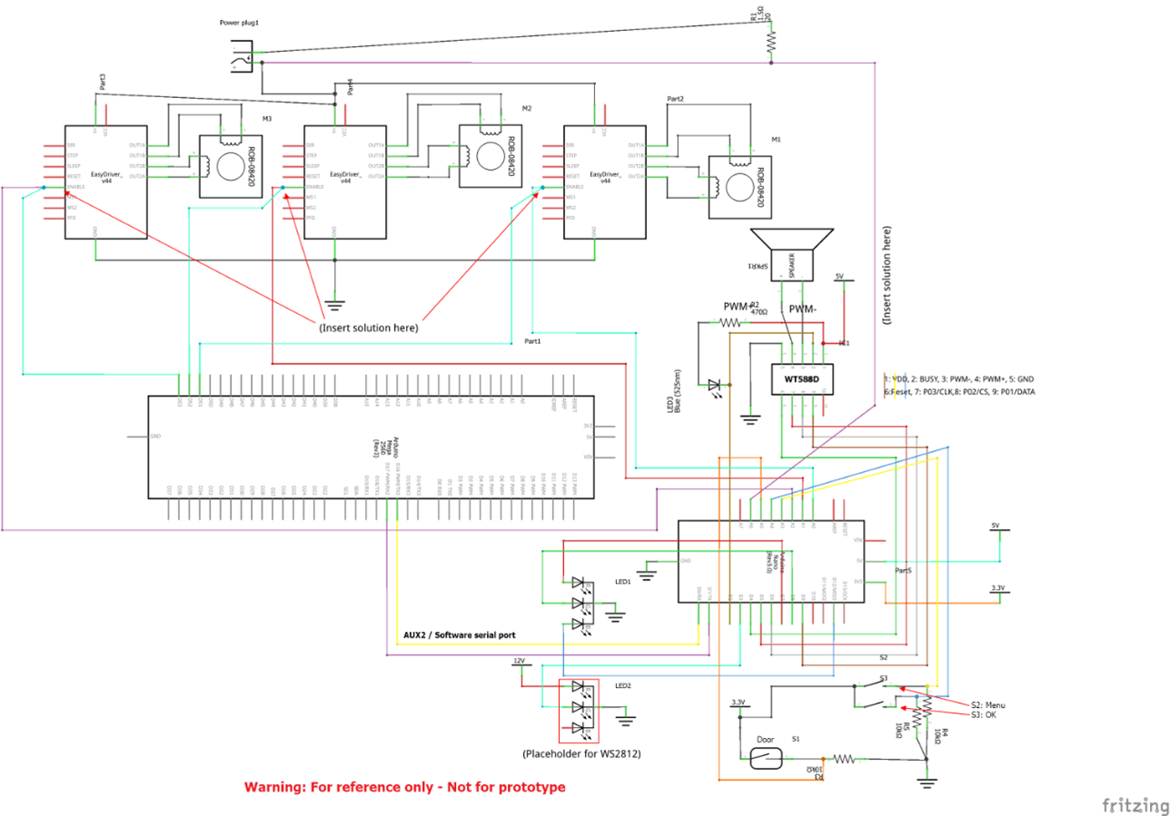

    pathfider1998 over 7 years ago
    I don't know how helpful this will be, but here's a little mock-up of the wiring:
    (Please, click on the image)
    I've also attached a Fritzing project file just in case the wiring is too cluttered to understand.
    The Arduino Mega board represents the RAMPS 1.4 board, and the 10-pin chip labeled WT588D is the sound module I'm going to use (refer to the pin list on the right side of the placeholder)
    The small resistor on the top of this mock schematic is the bed/nozzle heater.
    project_fritzing.zip
