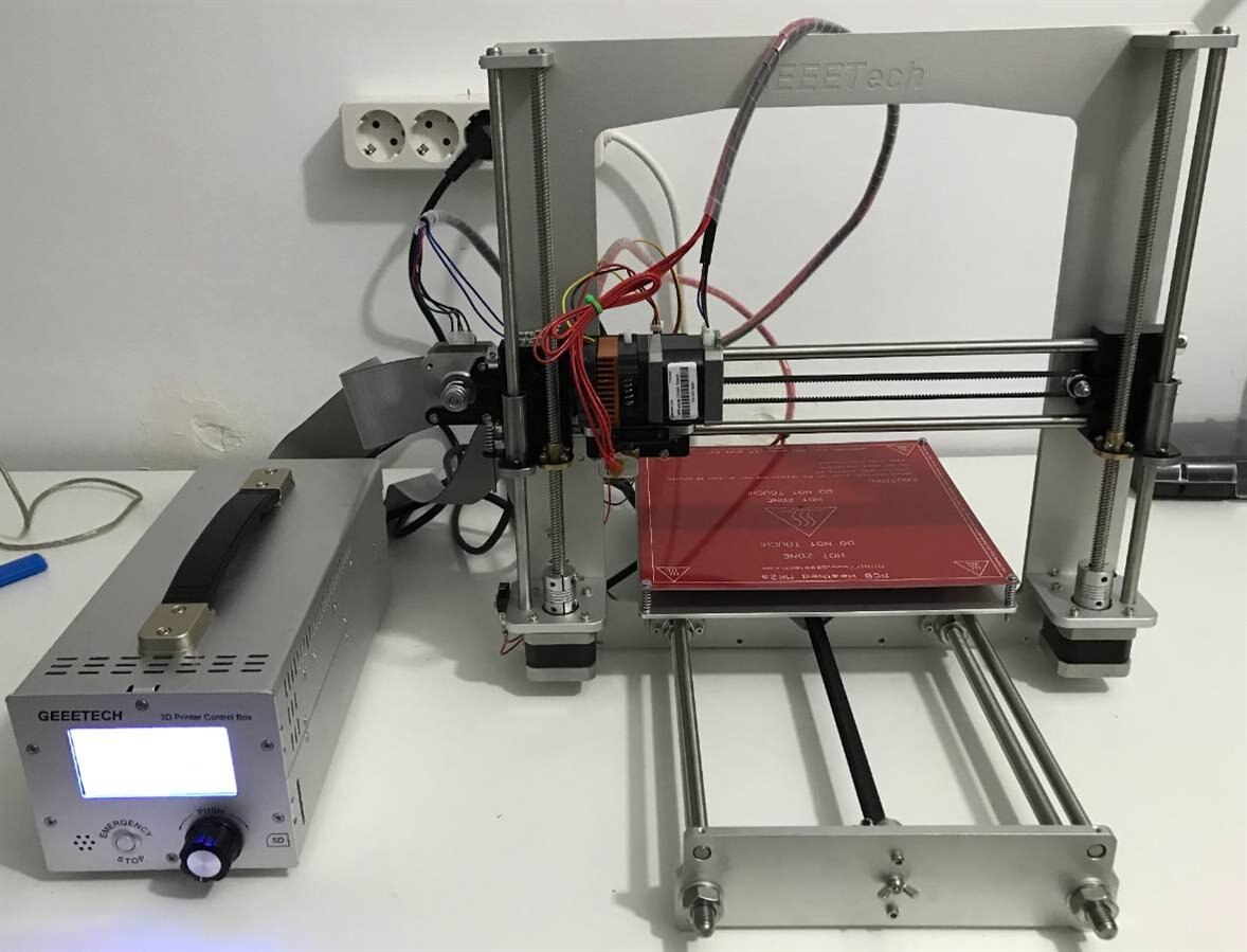

In past I have tested several 3D printers models in the range for personal use, the classic desktop 3D printers. Having had the possibility to see the different mechanical designs and solutions  (from XYZ printer to Rep Rap, Prusa, Robox etc.) I have definitely reached a personal opinion on what should be the essential characteristics of a Desktop 3D printer.
Last month I had the possibility to put my hands on the most recent model produced by Geeetech: the 3D Printer Prusa I3A Plus. Until now I have always used the previous model I3A (without "Plus"). They launched this new version on the market pointing the attention on the most evident innovation: the external control box including all the electronics; Power unit, front panel LCD and rotating control, SD Card slot, main board controller and motor controllers and the switching power unit. This improvement seems a very good solution making the life easier for both assembling and using the printer but there are also other meaningful aspects in the mechanics and electronics not so evident but important as they increase the printing quality and performances; so I thought is was the worth to take a look more in depth to this product.

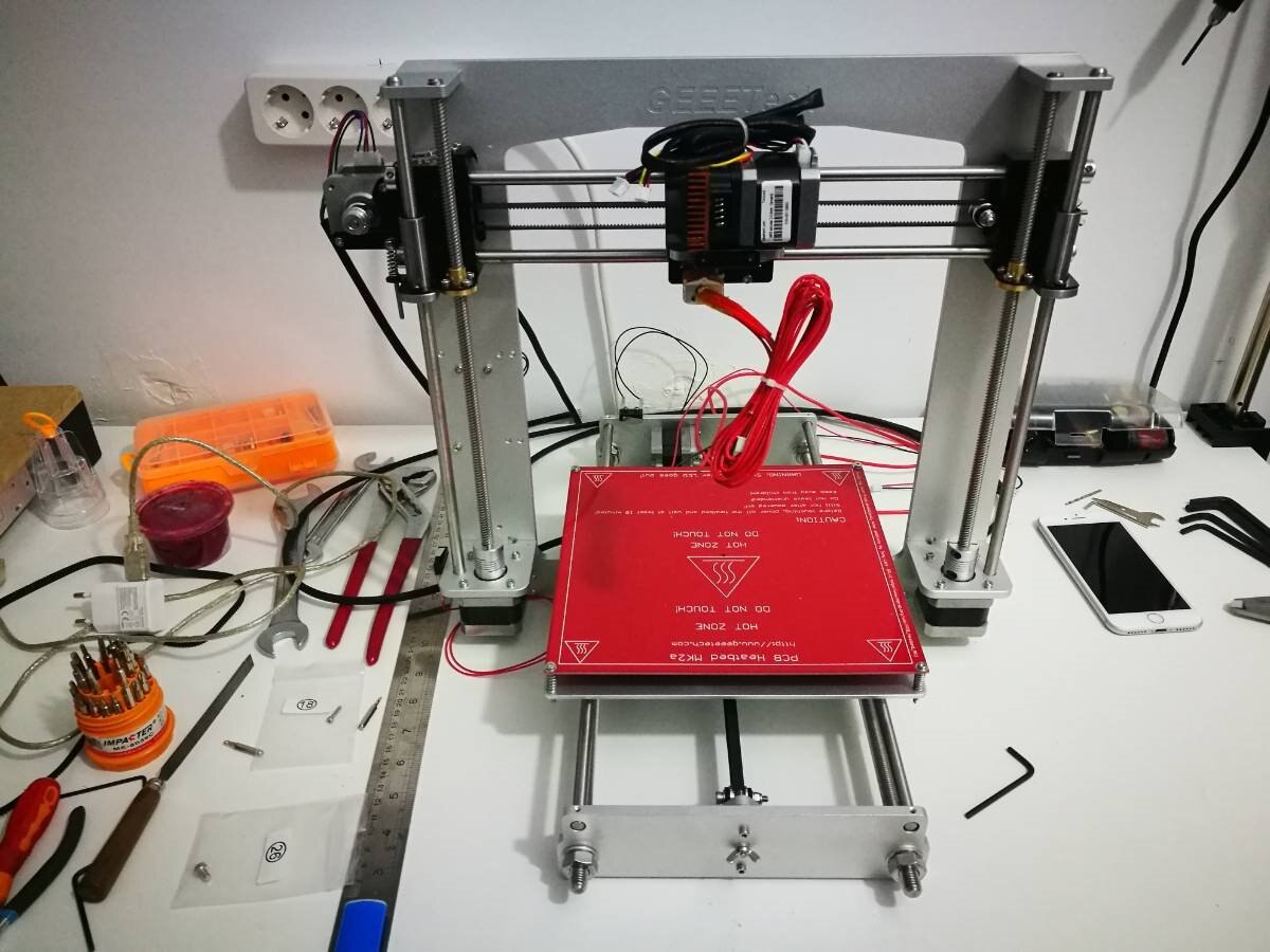

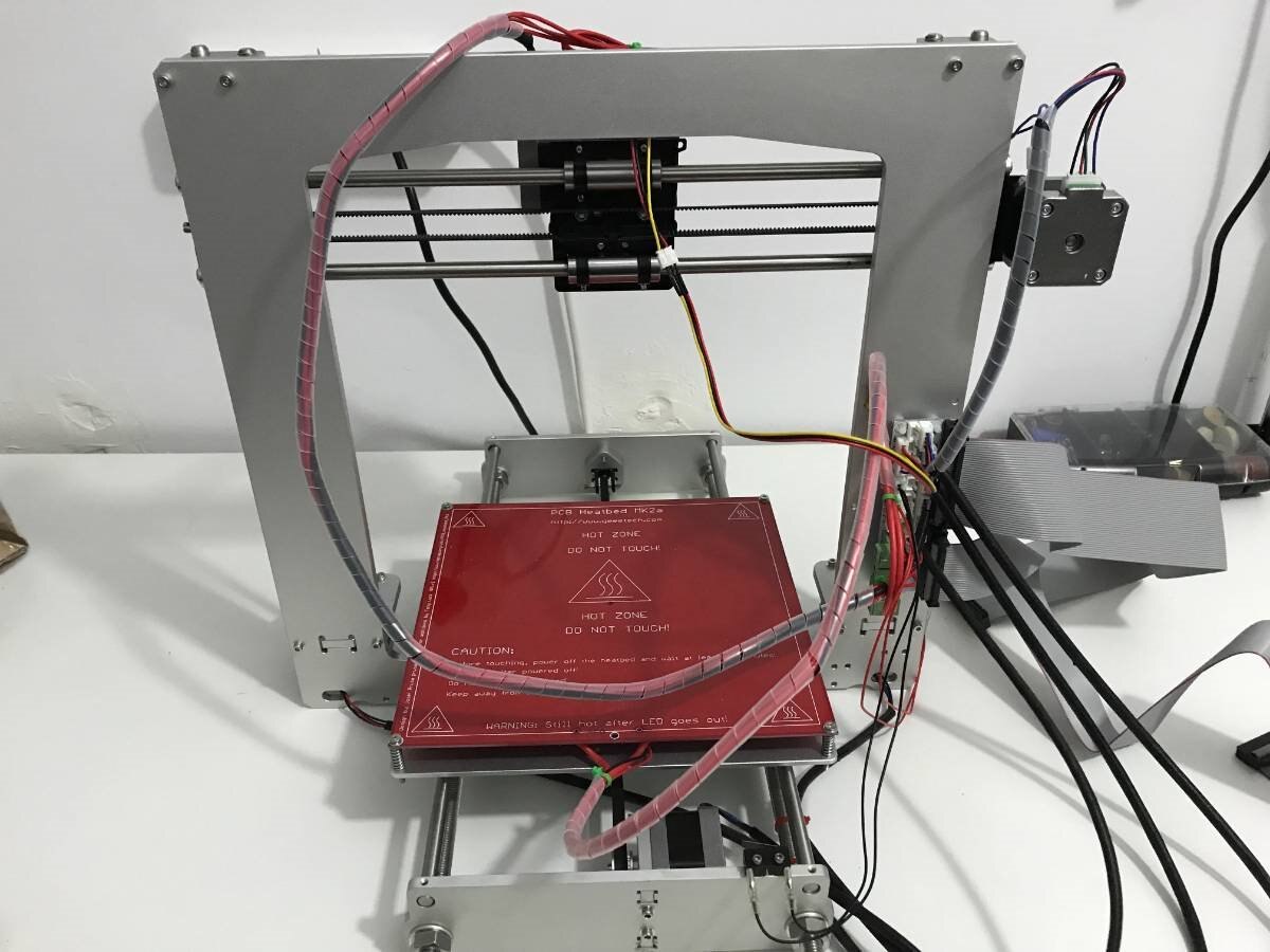

Unboxing and assembling
After ordering what do you receive? A flat box of about 12 Kg weight including almost all the parts and tools needed to assemble the 3D printer. Really the included tools are just a set of screwdrivers not sufficient to complete the assembly; You need also a tester (maybe useful in the final part o to check the cabling if something goes wrong), a set of Allen keys if you like to work better than using the provided tools a plier and a 17 key for the y-axis nuts. Take a look to the work in progress image below
Assembly of the printer is not so difficult but a minimal mechanical experience is a plus especially for the registration phase of the axis parts and motors and the tooth belts tensioning.
To assemble the printer I have followed the support material provided by Geeetech.com freely downloadable from their site and the videos available in a progressive playlist on Youtube.

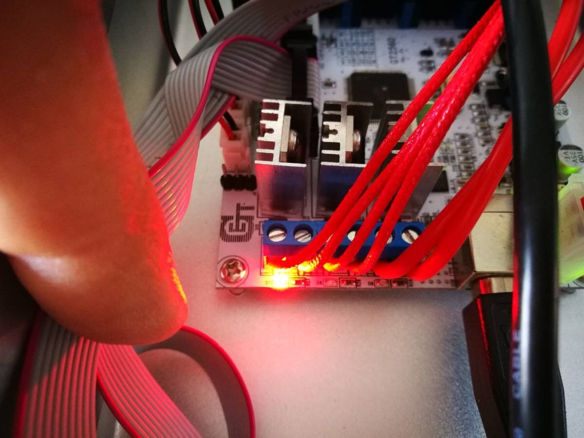

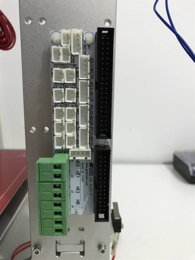

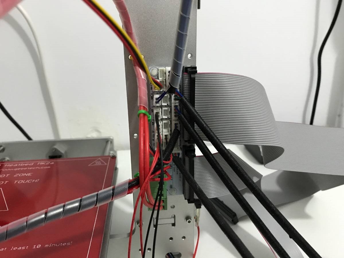

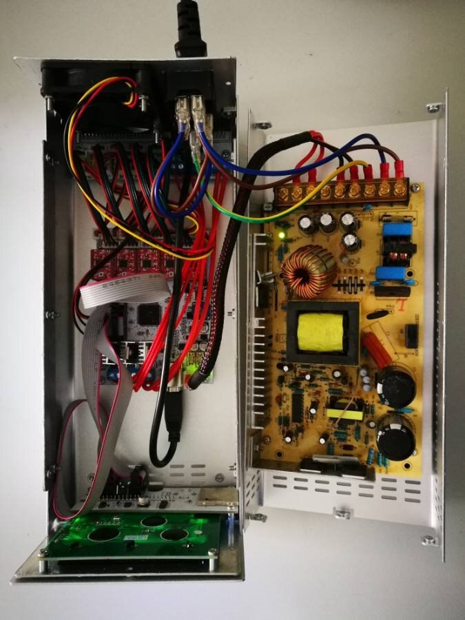

As mentioned above this Prusa has the entire electronics in a separate box connected to the printing frame through a couple of flat cables to a connector board. This part is very appreciable not only because it is easier to work but also because it reduces the number of wires on the printer making the movements easier to control.
What's in the box?

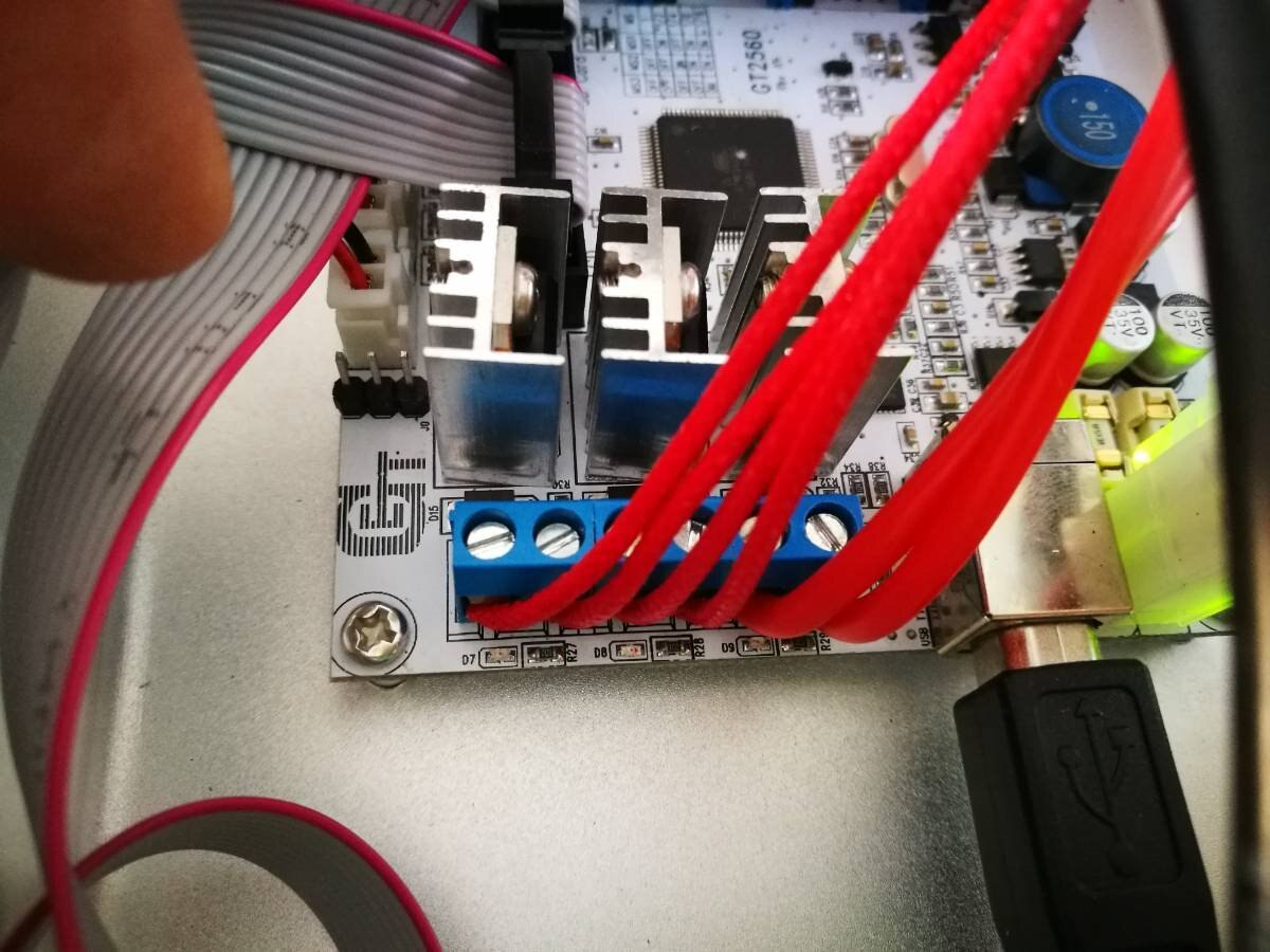

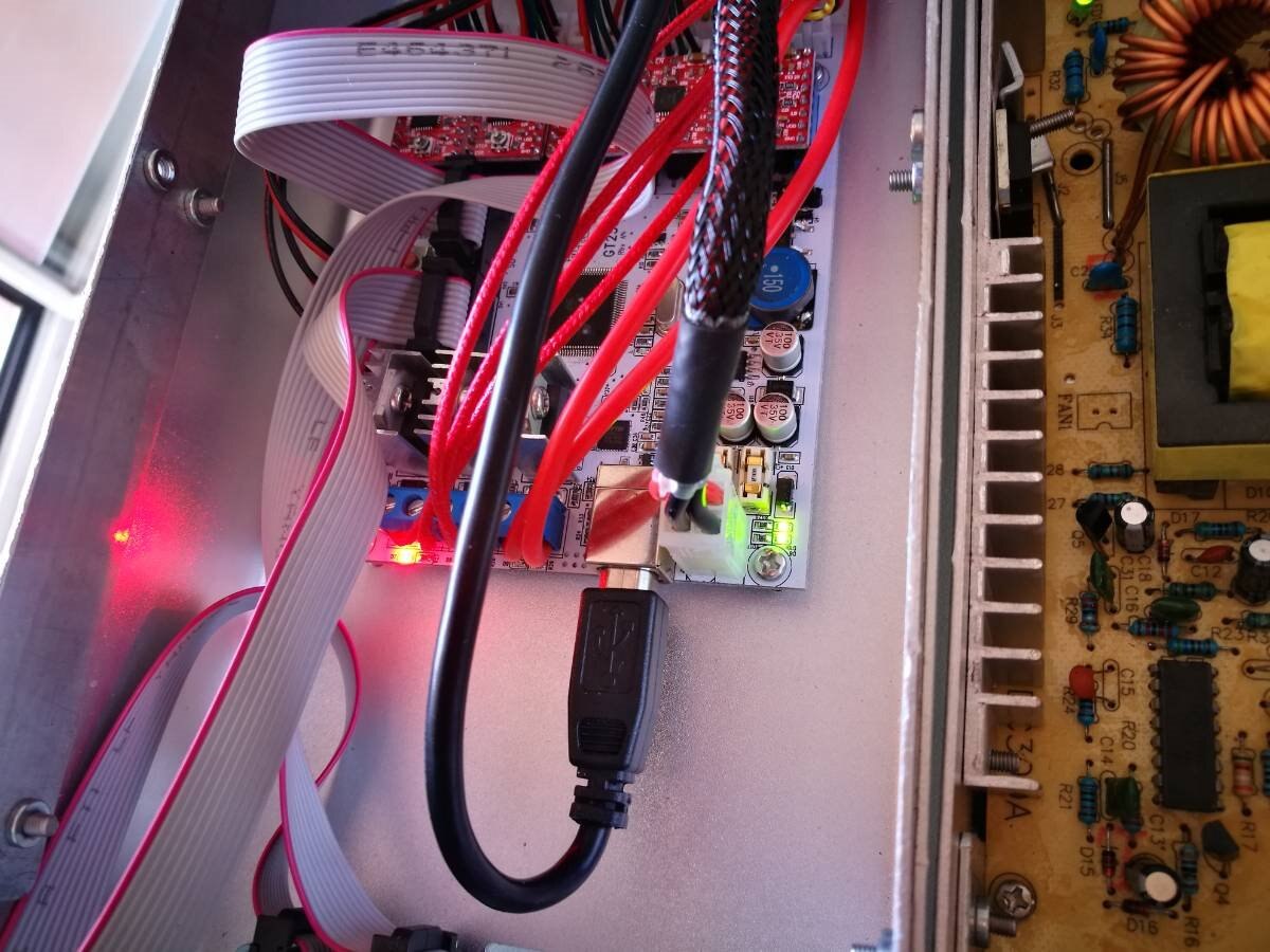

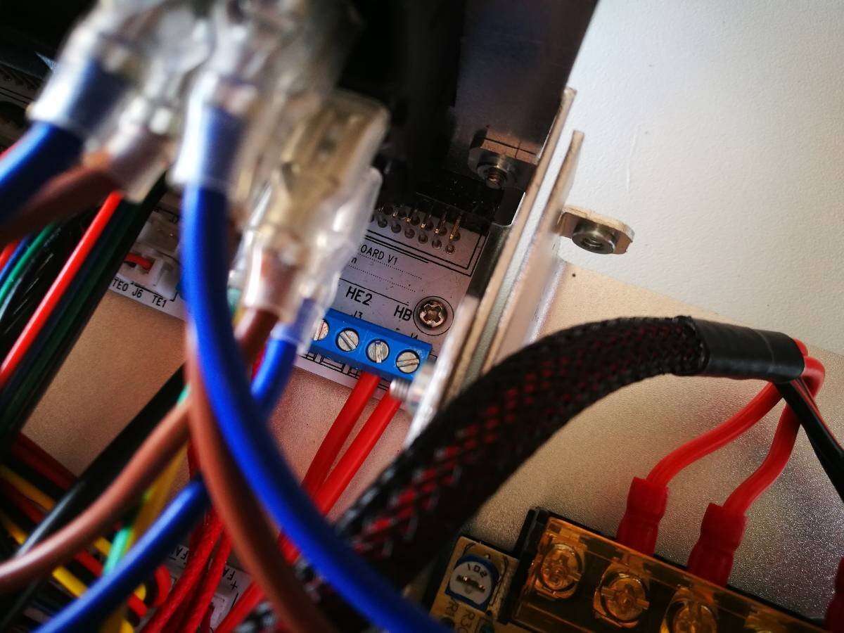

The electronic control box is shipped preset and preassembled. Obviously I have opened it. All the components are organised well with a good aeration. It is far from an "untouchable stuff"; any problem that will occur during the use of this 3D printer it is not easy to check the electronics and eventually replace the parts. I have appreciated the availability of the PCB  references almost clear for all connectors and test points, including a number of useful LEDs to monitor the activity of the device and the signals. As expected the main board - redesigned by Geeetech - is Arduino based and experienced users can manage the firmware without difficulties. In past I had no difficulty to ask to them for a copy of the sources to make testings and some improvement, adaptions etc.

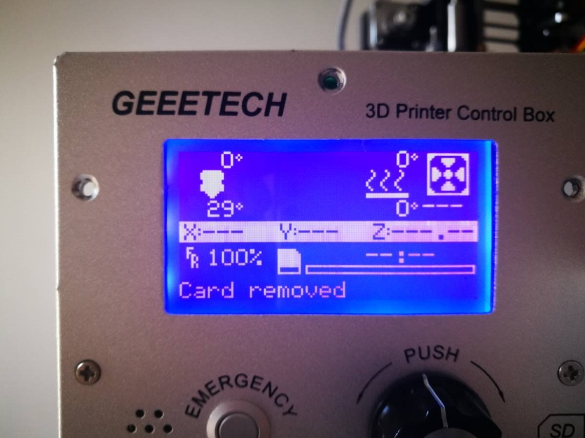

What I have found it is the case to review in some points is the board firmware. The printer works very well with the Repetier software and Cura (but I prefer Repetier with the Cura slicing engine) but the wide display has a lot of space that can be used to show some more information than those actually shown.
The lack of the firmware installed on the main board only affect the display so as a matter of fact there are not limiting or blocking problems in the system functionality.
The first issue is the auto home function: it works well if you launch from the printer menu but seems having only effect on the Z-Axis when it is launched by the printing script via G-Code
The second issue (almost annoying) is that after awhile the x, y, z axes positions are not updated correctly.
What instead I have appreciated is the correctness of the preset pint values on the board. You can start printing after the assembly is finished without trying to see if the steppers sequences are set correctly.
The gallery below shows the box open an running.
{gallery} Electronic box inside

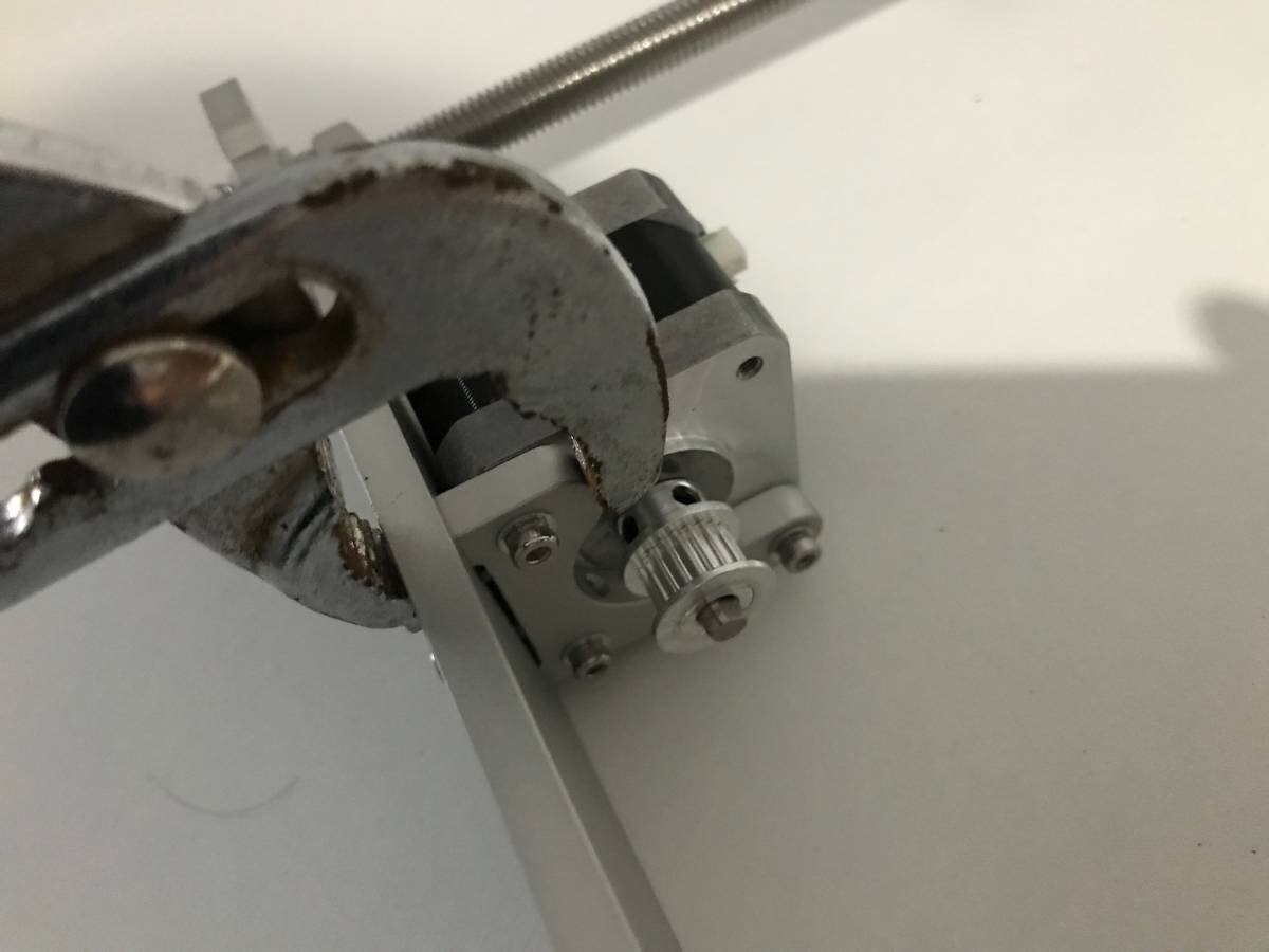

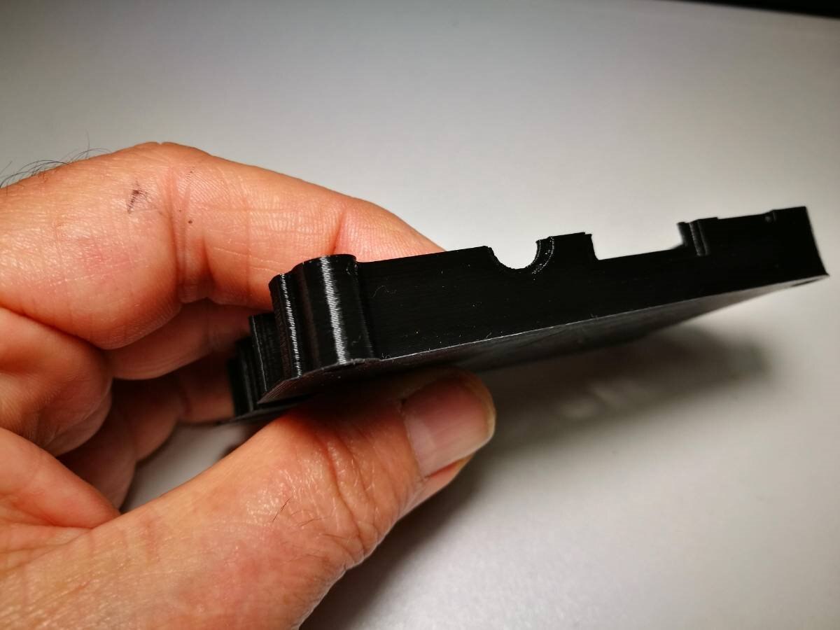

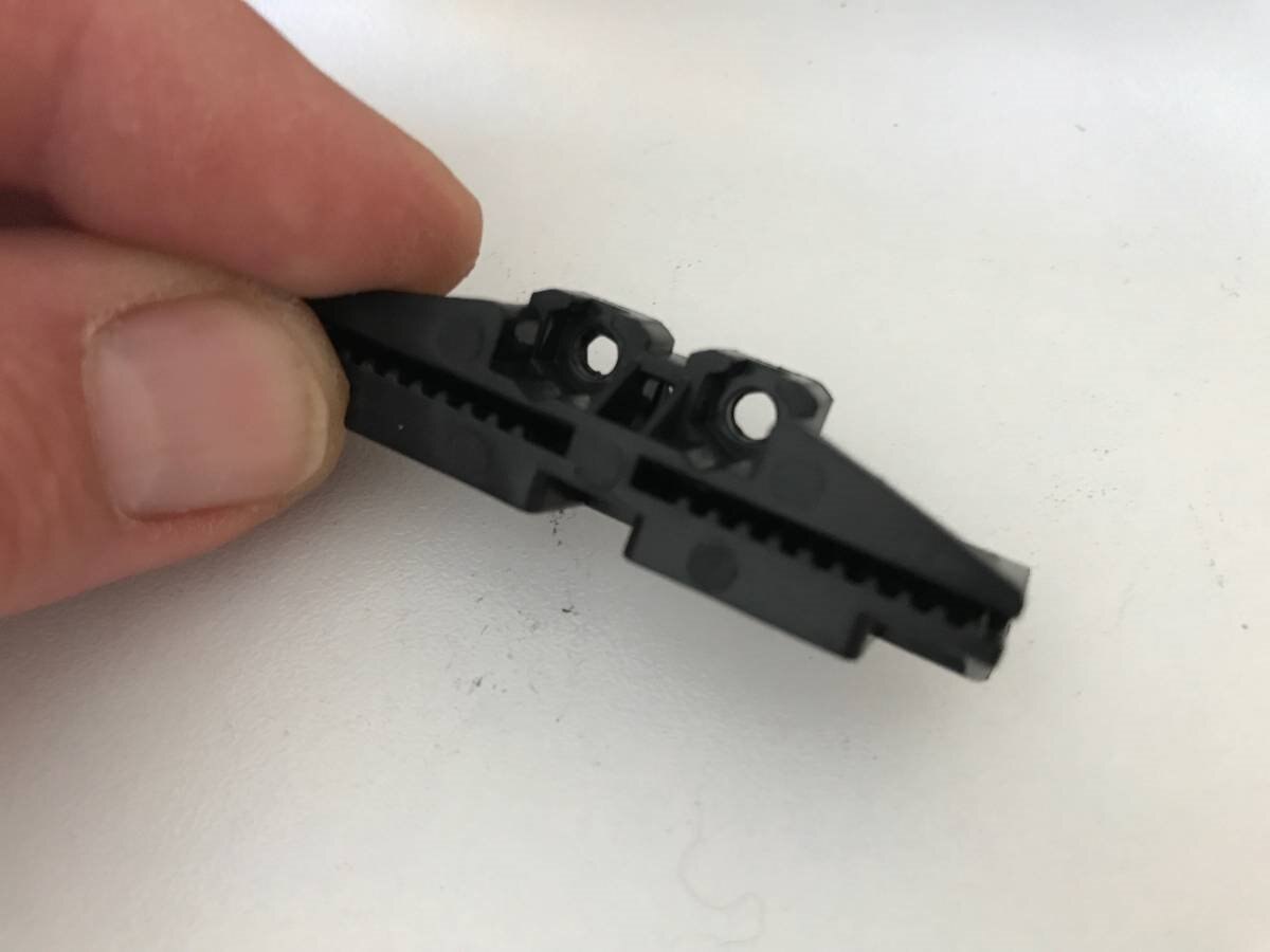

X-Axis belt lock
Usually it is a 3D printer component while in this case I see it is a robust plastic one. It influences the stability and tension of the X-Axis belt and the belt fixing and registration is extremely simple.

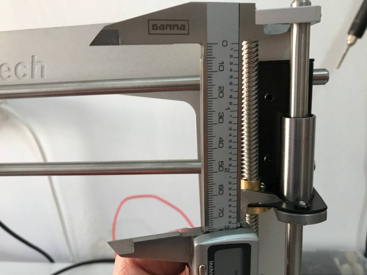

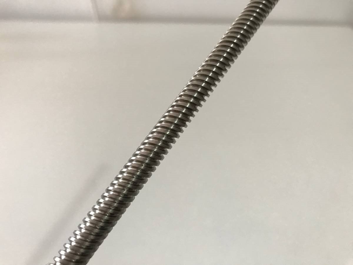

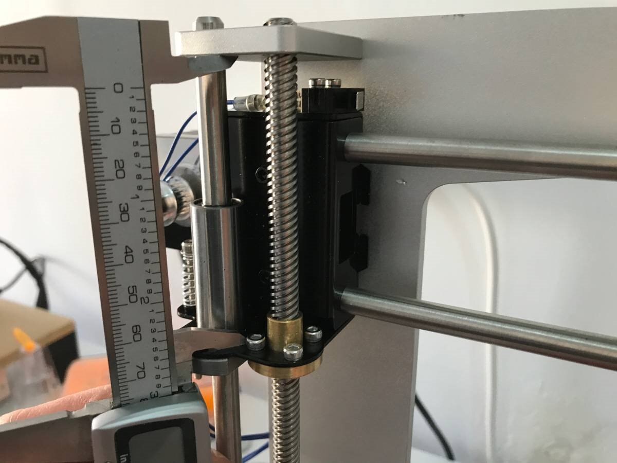

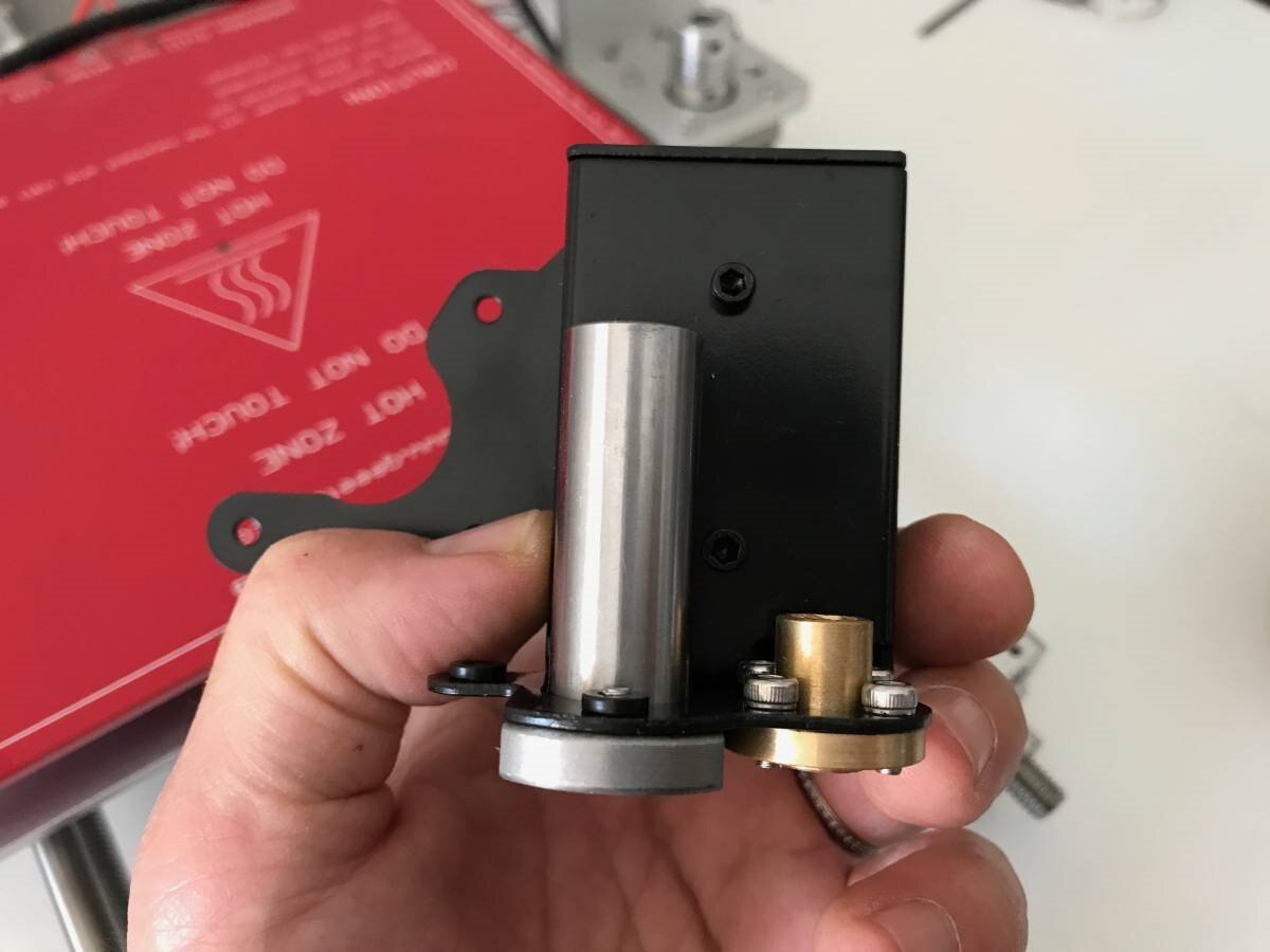

Z-Axis threaded drive screw

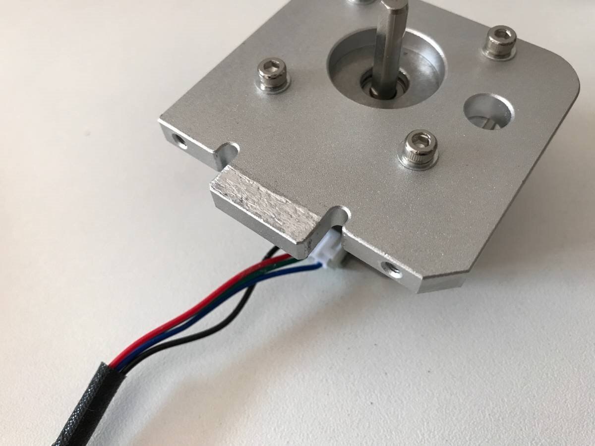

Similar but totally different than the more conventional M4 threaded bar. It is a robust and rigid inox threaded screw that gives an incredible precision to the vertical movements of the nozzle.

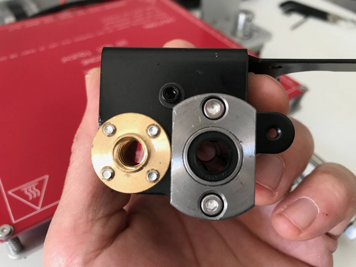

Bronze Z-Axis stepper guides
This component in conjunction with the vertical threaded bar make the Z-Axis perfectly stable while printing.

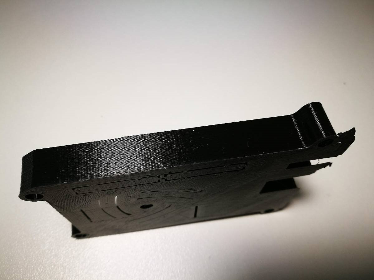

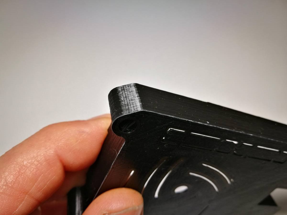

Print test
The images below shows a print test as it was done and removed from the heating bed.
Printing conditions:
Nozzle diameter 0.4 mm
Print speed 55 mm/s
FIlament Geeetech PLA diameter 1.75 mm
Layer thickness 0.2 mm
Type of support: Brim 5 mm wide

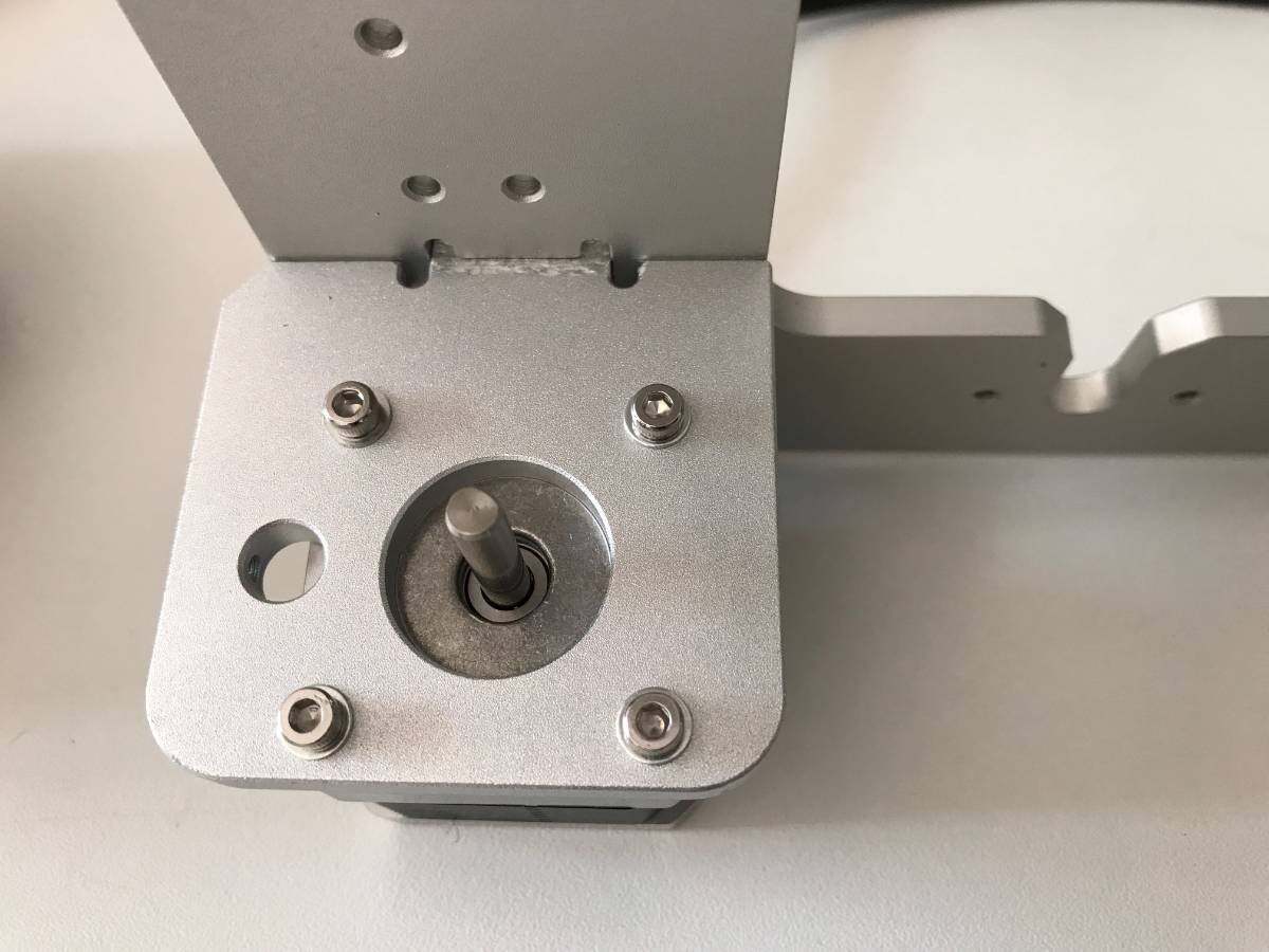

Also following in the best way the assembly instructions there are some details that it is better to know before (while mounting the mechanics) instead discover by yourself while using the printer. These are just some tips to take in account; all can be regulated in every moment and as far as I know these are also useful on the other Prusa models from Geetech and other providers.

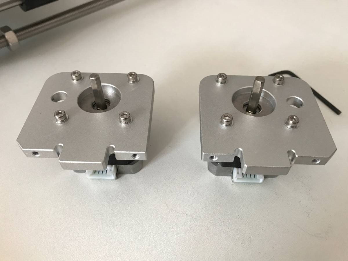

1. Some Aluminium part don't fit. Why?
Applicable to all the Aluminium Geeetech series of 3D printers and other providers distributing 3D printers with Aluminium frame
One of the most interesting aspects of the build structure of these printers in my opinion is the quality of the metal: solid Aluminium well refined in all the parts and sanded as a nice finiture. Due the exact measure cutting I found some parts are difficult to fit; as these parts should support mechanical movement and should be extremely stable frankly I prefer to spend some minutes filing and inserting it with the help of a clamp than having the piece unstable. The images below shows what I have done to the z-axis stepper motors supports inserted in the main vertical frame.

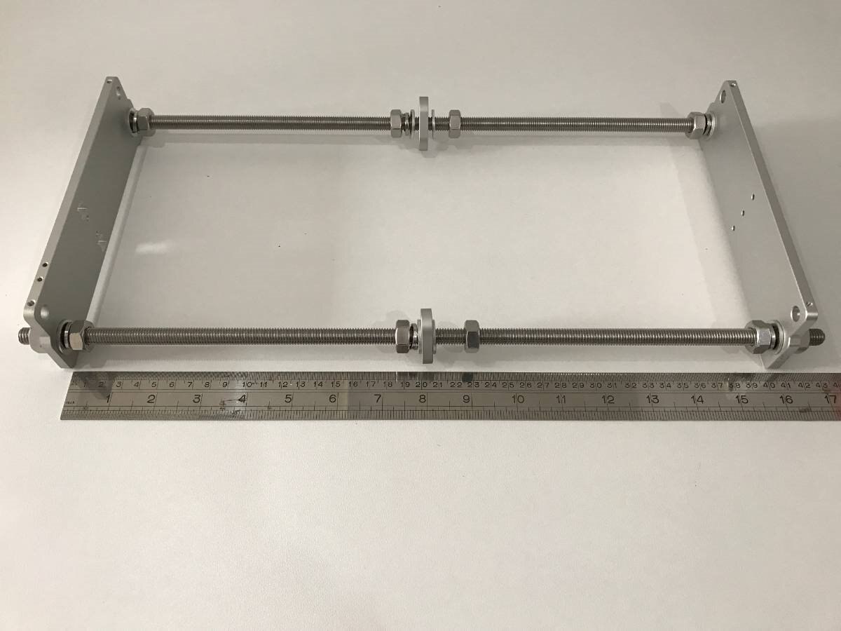

2. Y-Axis front and rear sides misalign when I close the nuts
This seems a stupid problem but it happens. We should take in account that when we lock the four nuts on the horizontal screwed bars there are two nuts on the right side and two on the left. But all the nuts closes rotating in the same direction (clockwise). To avoid misalignment while firmly closing the nuts you should use two keys and close them crossed. Not only but on the right side keep firm the most external nut and rotate with the key the internal one. Do the opposite to the other side.
Conclusion: the rotating (locking) nut should always be the one that has no influence on the locked plate position. The same is valid for the middle group locking the vertical frame of the printer.
The internal distance between the two Y-Axis sides should be 40 centimetres for the full use of the 200x200 mm printing surface. While closing the nuts check the distance on both sides.

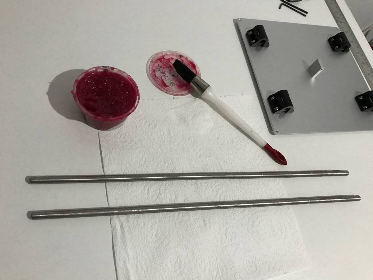

4. For a better duration of the moving parts
The bar screws and moving bars are not required to be treated as all the sliding parts uses linear bearings. I have experienced instead that for a better duration (and zero noise) it is the case to paint a thick Vaseline neutral mechanical grease. I have found this product investigating what is that white grease that last for years on the moving parts of the modern ink jet printers. It is sufficient a very thick paint to get a good result.

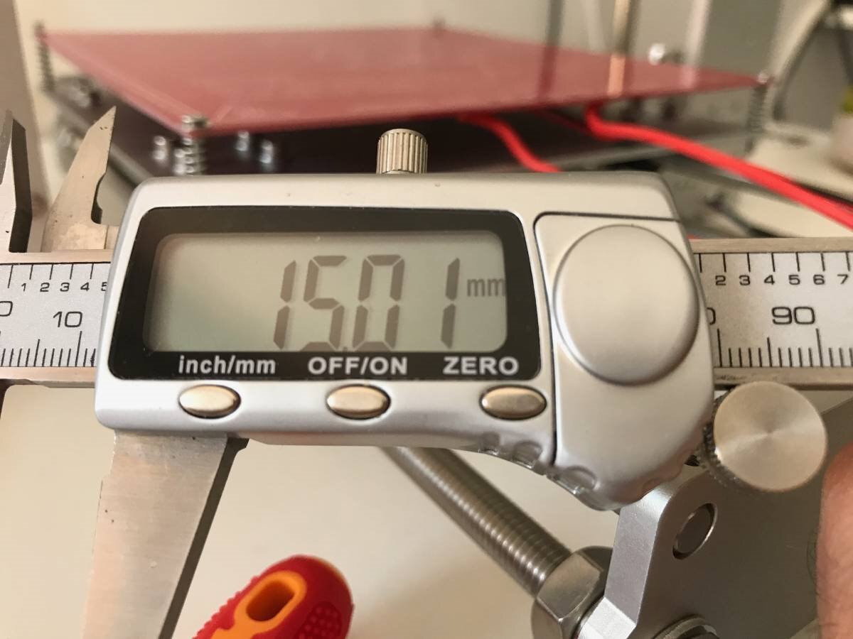

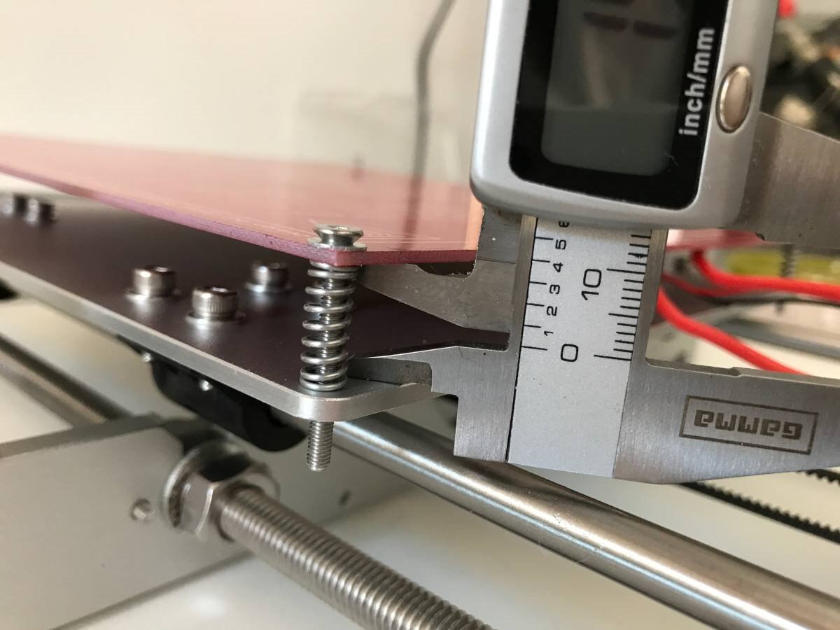

5. Fixing the heating bed in place
Despite there are many 3D printers that does not use the heating bed to stick the filament it is more complex getting good results without it; this is the reason that I always chose the heating bed included in the 3D printer. I see that there are lot of good - and some reliable - methods to stick the filament cold but I have experienced that with the heating bed it is incredibly easier to make good 3D printings, also large pieces and the presence of this small add-on (the Prusa original heating bed has a price of about 10-12$) is unvaluable.
One of the most important things to pay attention to avoid wrong 3D printings is just the bed calibration. Take in account that the heating bed is a PCB (heating) on top of which you will fix a 3 mm glass plate that is where the 3D printing will be built.
Calibration needs to be done almost frequently and it is an operation that it is not difficult to experience in few time. Placing the heat bed in the right place while assembling the 3D printer can make the difference; it is sufficient to follow these two easy steps:
  1. Fit in place the heating bed red PCB keeping the four spring in about the middle of their maximum compression. When calibrating if the springs are too high the bed become unstable while if they are too compressed you will have difficulties lowering the bed during calibration.
  2. After you have put the springs in an average identical position using a precision (metallic) ruler or - better - a caliper check that all the four screws keeps the heating bed at the same distance.
I have verified that the optimal distance of the heating bed from the Y-Axis driving plate is about 15 mm. It is not important that the distance is exact but it is important that you keep the same at all the four corners as much as possible. With the caliper, to do this make the first measure then lock the ruler and check the remaining corners as well.
6. Z-Axis: how to setup correctly
One of the most influencing aspect for the quality of the 3D printing is the correct alignment of the couple of motor screw drivers for the z-Axis. Following a similar method as explained in the previous point, after the Z-Axis mechanic has been set in place in an average way complete the alignment of the two motor screws using the most precise measure tool you have. Only if the two screws are perfectly aligned your tool will work perfectly.
