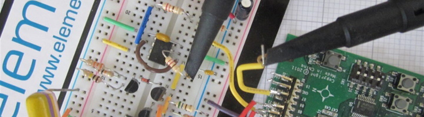

In the previous blog I took a simple 555 oscillator that had been adapted for voltage control and used it as a component part of a phase-locked loop (PLL). In this final blog, of what has turned out to be a series, I'm attempting to use the PLL I constructed to make a very simple frequency synthesizer.
Here is what it looks like as a block diagram:
I have a fixed divider down from the board oscillator to give a reference signal of 1kHz. That's fed to one input of the phase comparator. The other input comes from a divided down signal from the output of the VCO. The loop, if it operates correctly, will lock those two together so that they have have the same frequency and are in phase (the phase comparator itself is trying for 0 degrees between the negative-going edge of each waveform, but in practice it will be offset slightly). When that happens, the vco output will be the divide value (n) times the reference frequency.
The circuit has been elaborated a little.
There's now an extra transistor current source to inject a fixed current into the timing capacitor. That gives rise to the oscillator having a frequency offset at a control voltage of 0V (a minimum frequency that the oscillator can't drop below - to ensure that the oscillator keeps going and that there are always edges to lock to). I've also adapted the filter values to give better locking at 1kHz (they aren't optimum, though - I'm sure they could be tuned better).
For testing, I have a divide of between 2 and 10, so the frequency will increase from 2kHz to 10kHz in steps of 1kHz.
Here's a video of it running a test where I increment the divide value at one second intervals. The top trace is the 1kHz reference. The bottom trace is the timing 555 capacitor waveform, so we can see what the VCO is doing.
It's not perfect and occasionally will lose the lock it gains after the step in frequency and have to do it again. The plug-in breadboard is a very messy environment, with fast digital signals mixed with sensitive analogue circuitry, so I'm not surprised. In any case, even with better layout, I wouldn't recommend using this for anything serious other than looking at the general principles and experimenting.
