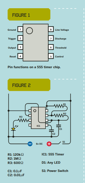

When C1 acquires 2/3 of the positive voltage powering the circuit, the 555 reverses its output on Pin 3 from positive to negative and forces C1 to discharge itself through R2.
(This last sentence is actually from Make Magazine issue 10 where Platt is explaining the same thing as in chapter 4 of his book - see image below)

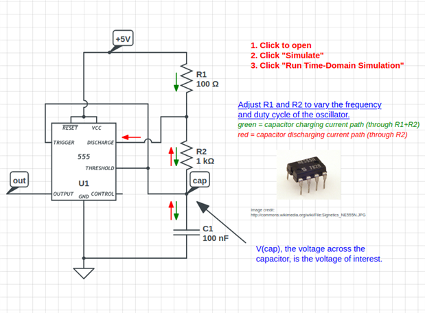

What I am confused about is the discharging through R2.  I am obviously stuck on what is going on with C1. As I understand it, it first gains a positive charge on what I will call the top plate in the picture above, and a negative charge on the bottom plate (next to where the label C1 is).  Maybe I have read too many analogies of water with electricity but I think of the capacitor as a balloon (in fact there are many analogies in Platt's book like this).  So how is the balloon releasing the pressure in what seems like a reverse direction back through R2?  Here is a similar circuit I found on circuitlab albeit the pins arranged differently and it shows that reversing of "flow":
Is there not +5V into R2 from R1 at the same time C1 is discharging??

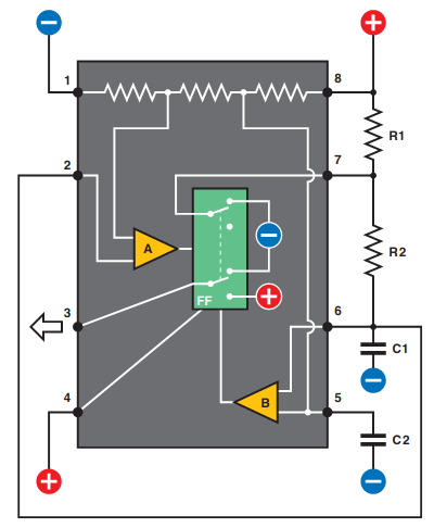

Finally here is Platt's "internal" view of the 555 timer in astable mode.  I assume pin 7 gets grounded to pin 3 but I am still confused about the seemingly reversal of flow through R2.

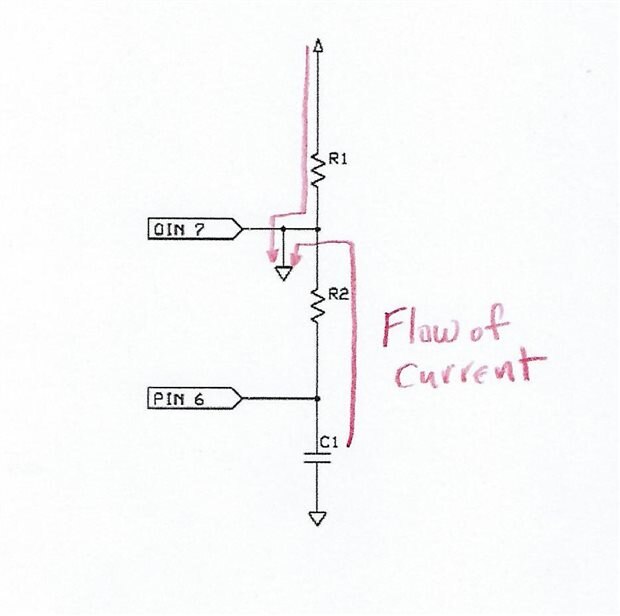

    jw0752 over 6 years ago +6 verified
    Hi Robert, During the discharge part of the cycle the Pin 7 is attached to ground. (see the blue - in the last picture). Once pin 7 is connected to Ground the electricity in C1 starts to move through R2…

    During the discharge part of the cycle the Pin 7 is attached to ground. (see the blue - in the last picture). Once pin 7 is connected to Ground the electricity in C1 starts to move through R2 and into the Ground. The grounding of Pin 7 does also connect R-1 to Ground but this has nothing to do with R2 and C1 at this time since there is a ground between them. The last picture also shows that Pin 3 is connected to ground at this time but here again it has nothing to do with R2 and C1 since there is a ground between them.
    See if this helps? Keep in mind that the ground that I drew outside of Pin 7 is actually inside the chip and it is temporary. As soon as the charge on C1 hits 1/3 of Vcc it once again goes open and allows the current coming from R1 to recharge C1 through R2.
