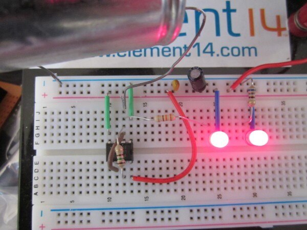

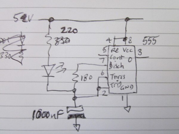

    So, quickly hacking together something derived from the sort of things suggested by John and Doug, would this do what you want?
    Needs a large electrolytic value to get the timing, though, and not really a 'good' circuit [far too finicky], but it's interesting to play with. By the way, it's a standard red led: the intensity, relative to the rest of the scene, overdrives the camera sensor and just makes it look white.

    0 shabaz over 5 years ago in reply to jc2048
    That looks very good, it seems perhaps the most component-efficient way to do it if using a 555!
    0 jw0752 over 5 years ago in reply to jc2048
    Hi Jon,
    Fascinating, it never dawned on me to use the control side of the 555 to do the job and not the output.
    Pretty cool.
  • 63stratman
    0 63stratman over 5 years ago in reply to jc2048
    I believe this is what I was looking for. Other than slowing down the frequency, I believe it's spot on. Thanks, Jon.
