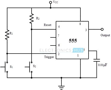

imageI have a question regarding some behaviour of a 555 timer circuit in bistable mode. I attached a photo I found off the internet that is the one I’m using, the output goes to a 440 ohm resistor and then to a red LED also I’m using 10k pull up resistors. I noticed when I push the trigger pin switch and the light comes on, that sometimes when my hand is hovering over the circuit the LED goes out. I got curious and made sure not to bang into anything or touch anything and I would slowly bring my hand near the circuit, and almost half or more of the time the LED would turn off. Being more curious now I took the breadboard set up like a “bridge” (basically I have two small bins and I had the breadboard laying across so each end of the breadboard is resting on those bins and there’s nothing touching the bottom of the breadboard) I noticed that if I put my hand under the breadboard (without touching it at all!) the LED light on the output pin goes out. Getting more curious I held the breadboard by the sides so there was minimal contact and the light would work perfectly fine until I ran my hand close to (but still not touching) the breadboard. I tried this on different surfaces such as plastic bins, slabs of wood, the floor (lol) and on a glass table. It did it the least amount of times when laying on the plastic bin. I’m not using a anti static wrist strap but I’m curious if this is an environment issue or like a workstation issue? Or a simple fix with a anti static strap? It was kind of neat to play around with it like that but now I wonder about the last 2 years and all the heart ache from circuits not working properly even though I was CERTAIN I had built them exactly as per the diagrams. Also I tried 5 different 555 chips and 5 different breadboards with the same results. Any ideas or suggestions?

    Not everything on the Internet is reliable. If you look at the datasheet of the chip, on page 10, you'll see the proper circuit.
    The clue (in case you're wondering how come I knew to check the datasheet) was the unconnected pins,, and the poor quality circuit diagram. Unconnected pins experience a voltage based on the environment (and your hand movement near it); not all chips work in a guaranteed expected fashion, unless the pins are designed to be left optionally disconnected.
    If you want to see decent 555 circuits (which I believe all function, i.e. 100% of them), this site is very good (there are some others too): https://www.talkingelectronics.com/projects/50%20-%20555%20Circuits/50%20-%20555%20Circuits.html

    It looks like you have discovered a way to make a kind of proximity sensor. Maybe if you connect an otherwise unconnected wire to pin 6 it will be even more sensitive.

    Thanks it’s funny cause after I posted this I went to lay down for a bit and as I was laying there I said to myself “you left pins floating” haha. I should of known better. I’ll check those links out though in a bit. Thanks again for the quick response. I love this community. I was always worried about asking questions that there would Be lots of nasty negative replies but so far seems like a very respectful group on here. Thanks again! Also sorry if I should be posting these questions in other forums let me know.
