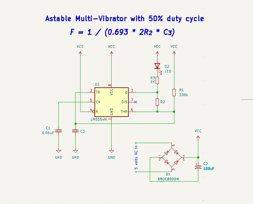

I'm looking to build an End of Train (EOT) circuit. The model railroad folks I hang out with, just purchased a commercial unit. After gagging at the price, I figured why not build one.
My search found this resource https://techlib.com/area_50/Readers/Lennie/End%20of%20Train-1.pdf complete with PCB. Unfortunately all the links are dead so I had to generate a schematic from the PCB layout.
Question: Will the circuit work? Are there any reasons for the design?
Instead of bread boarding the design I figured the folks that hang out here are great and offering solutions. Tapping into the experience of the members surely helps. Nothing like experience to find a solution fast.
I have some concerns with the circuit. I couldn't found a 555 circuit that uses pin 7 as an output. I took a look through Cabe Force Essential 555 IC book (Cabe hangs out here:) and found nothing like this beast.
I'm not sure of the design. It looks like nothing I have found.
I'm thinking it would have been easier to just start from scratch.

    0 colporteur over 2 years ago in reply to scottiebabe
    Now that changes the water on the beans.
    Thank you for your insight.

    Isn't it just an astable mutli-vibrator you are looking for? LED need to flash on a particular interval right?
    https://www.electronics-tutorials.ws/waveforms/555_oscillator.html

    I think what you are looking for is an astable multivibrator.

    I believe the design I was hoping to use was riddled with errors.  scottiebabe pointed out the chip position error and your drawing suggests a number of other errors. Pins 6 & 7 are connected to together on the PCB and there is no capacitor on Pin 5. your drawing also increases the filter cap.
    I have seen designs were there are caps on pin 5 and some where there are none. What is best practice?
    In your frequency formula there is a constant (0.693). I've seen constants in formulas before. I can't recall if they are the same. Where does this constant value come from.
