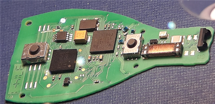

I opened an end-of-life smart car key.
It uses radio for locking / unlocking and IR to switch the vehicle off and on.
A deep dive is available here.
The type of key here is one that you can use from a distance to open or close the car, but that you have to physically plug into a dashboard slot to start the engine.
When the key is removed, the engine stops.
The locking /  unlocking mechanism works from a distance. A few 10s of meters. It's a radio circuit powered by a coin cell.
(true story: if you press the key against your temple when using it, the range is extended by several 10s of meters)
To activate the car and be able to run the engine, you have to insert the key into a dedicated receptacle in the dashboard.
A bidirectional infrared bridge communicates between dashboard and key. That circuit is powered via induction.
The coil on the key gets power from a coil in the receptacle.

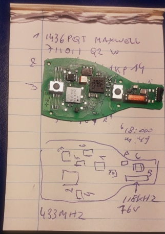

Let's see how many components can be identified. Chime in if you have more info.
1: unknown function
Maxwell 1436 PQT 711011 Q2 W
The only reference I could find was other similar keys.
2: unknown
ROBINIE 441KP14
I saw the following different codenames on the internet: FICHTE, APFEL, WEIDE
All are German names for trees:
Acacia, Fig, Appel, Willow
Probably an ASIC or mistified OEM.

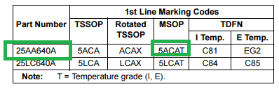

3: memory
5ACAT 439YTHS
This is a Microchip 25AA640A SPI EEPROM:
4: Schottky diode
45 SOT-23 package is a jellybean Schottky
5: tantalium capacitor
476 6K 430
47 µF, problably 6.3 V, 1411 package
6: oscillator
manufacturer: Nihon Dempa Kogyo Co., Ltd. (NDK)
18.000  :49
Crystal or resonator, 18 MHz?
7: NPN transistor
H1 SOT-23 package is a jellybean NPN.
A: red LED
B: inductor: extracts power from the car. Powers the IR circuit when starting and while driving. Takes care that the IR circuit doesn't need coin cell power. 190 µH.
C: I saw this before and forgot what it was. I bet it's a fuse. edit: no a TVS. edit no it's a 6.7 nF capacitor.

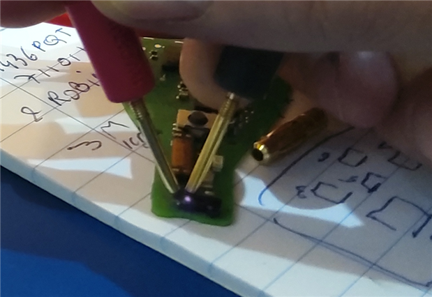

D: IR sender and receiver. There's a matching inverse pair in the dashboard of the car.
Using my tablet as a detector (digital cameras see iR), I found that the left 2 pins are cathode and anode of the LED.
The two buttons are to open and close the door locks.

    Some pictures with the components removed (click to enlarge)

    Looks to me like the Maxwell chip is doing the radio function [the name 'Maxwell' might be a bit of a clue, I suppose]. Now you've shown us the bottom view of the board, we can see the loop of the aerial…
