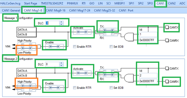

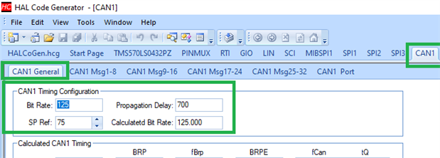

The program sets up CAN1 for interrupt driven communication, both ways.
box 1 will be used for sending messages with ID 1. We listen to box 2 for messages with ID 2.
For this exercise, I gave incoming traffic notification a higher priority than notification when a message is sent.
For showing that it can be done. Not really necessary here.

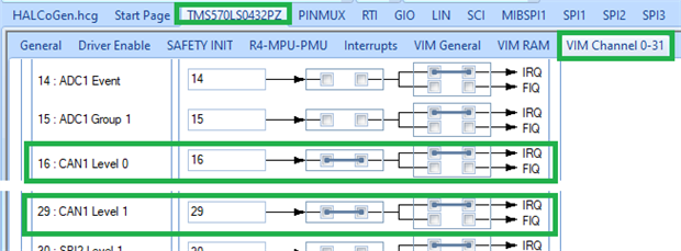

The interrupt system will deal with a complete send or receive:
Because I used high and low priority interrupts in the CAN setup, I need to enable handlers for both.
In the end they will call the same code, shown below:

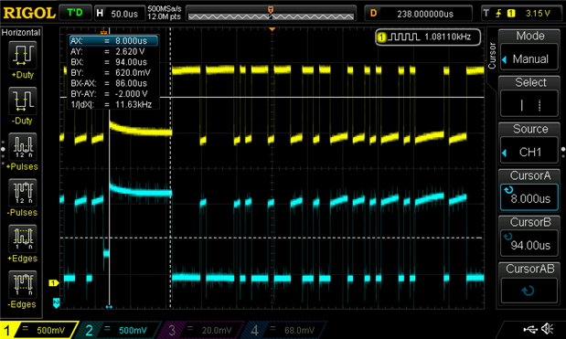

The program manages to spawn messages with less than 90 µs gaps (if you remove the for(y) loop) when it's alone on the bus.
The best I do can with the TMS570LS04 is to put a loop of y<100. That gives a 100 µs between two messages, and gives the controller enough time to deal with interrupts.
Any less, and the controller will not have time to deal with incoming traffic interrupts.
The Hercules controllers that support DMA don't have that issue, because they have plenty clock pulses free when communicating....

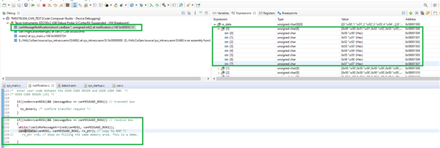

If you want to see if your package made it through the buzzy bus, run the firmware with a debugger and put a breakpoint in the CAN  interrupt (in the if() loop of message box 2).
If your message passed safely through the bus, you can then see it and inspect the data:
I use my Linux device here to generate a message with ID-2:
The firmware will break when the receive trigger fires. An API function retrieves the data from the CAN peripheral:
You can see that the data sent matches the data received....
