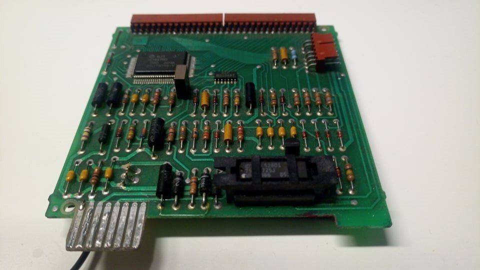

Hi Community
I have some few q´s about a board there inside this vintage car.
My car have the digital dash

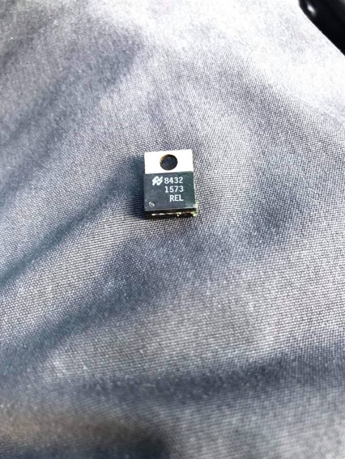

The board have a broken componet that i can´t find out what is so i have replace it:
Here it is? what is it? where can i buy a new one?
Sits there with five legs.
i want to keep the electronics alive for longer and now its starts to become old so want to replace what needed to be replaced.
can the community help me telling me the componets so i can buy new ones.
Hope you alle can help me.

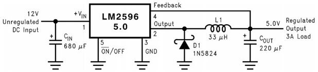

    dougw over 6 years ago +2 suggested
    This is a National Semiconductor part (which has been acquired by Texas Instruments). The package type is TO-220-5. TI may be able to help identify it. Most TO-220-5 parts are switching voltage regulators…
    Most TO-220-5 parts are switching voltage regulators.
    The big chip on the card probably needs 5 volts, so if you have a pinout from that chip you can trace back where the 5 volt power comes from.
    This is a typical circuit for a National Semi switching regulator: (the tab is connected to pin 3 - GND)
    You can check to see if the circuit around your chip matches this. In particular, look for an inductor.
