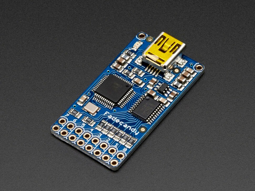

SK: Can you tell us about the LED controller you designed for these kinds of projects?
MS: Fadecandy is an LED controller that I designed originally for my own art projects, but I wanted to make it into a tool that other artists could use.
I packaged a lot of that tool up into a little microcontroller firmware platform. That platform incorporated a lot of what I learned in previous projects about how to make LEDs look good. How to give them good gamma correction so that they have nuance and brightness and how to try to make all the flickering that you see less offensive by evening out with patterns. And this was work that I started in one form for the equilateral triangle sculptures that I did in early 2013 which I turned into something I could then use for larger scale art for a project called the Ardent Mobile Cloud Platform. By the time we built the Ardent Mobile Cloud Platform, it used basically what would be the Fadecandy firmware in its current form. But we didn’t have any custom hardware, and it all ran on these Teensy 3.0 boards. It worked pretty well, but it seemed like there were a lot of improvements I could make if I designed my own circuit board.
So Fadecandy was the culmination of the desire to lay out a board for this project, the desire to polish up the firmware that I'd written for the Ardent cloud and the desire to build enough of the higher level infrastructure that artists and software engineers could use it from a variety of languages to control LEDs without having to know much about firmware or about engineering or electronics.
Fadecandy product photo from Adafruit.com
SK: How does this work for you in the sense of a product?
MS: I originally built them myself, when I did the design, I did a small manufacturing run of about 100 on a hotplate. I needed to do that to get them out there and get feedback. I didn’t want to just launch a product without testing them. So with the help of a couple of friends, I made a few and starting getting them out to people. I put them up on Tindie, it was the sort of thing where I'd go to Meetups and bars and give people boards, and tried to get as many of them out there as quickly as possible so that I could get feedback. I mostly didn't hear much though. It was the sort of thing where you have to hope that no news is good news. I think armed with a little bit of confidence, I ended up in New York with a suitcase of LEDs demoing the stuff to Phil and Limor at Adafruit. Honestly, at that point it was hard to tell if they were interested. So Limor asked me to write a tutorial. What she wanted to know was that her customers could build something with the Fadecandy controller. And for that she needed to see the documentation.

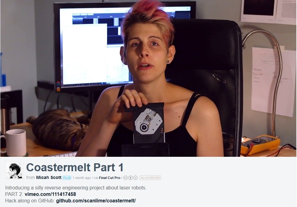

SK: Let's talk about the things you've done with reverse engineering, what are you reversing in your Coastermelt project?
MS: Coastermelt is a project where I am reverse engineering a common Blu-Ray burner so I can figure out how it works in as much detail as possible. I don't want to know just what goes in and what goes out, but enough of what goes on inside so that I can start to change it. And in this case, I change it by making modifications to the firmware. The firmware is the code that is actually running on a system-on-a-chip on this Blu-Ray drive. And I think that by modifying the firmware and possibly by making other changes, the theory that I have is that I can use the Blu-Ray burner to create specially patterned Blu-Ray discs that have these patterns that aren't actually data that are actually...when illuminated by the right kind of laser light turn into holographic projections.
SK: I can't wait to see that! That's going to be amazing.
MS: I hope it works out. I think it’s one of those things--it's very pie in the sky, there's so many things that can go wrong. Maybe the dyes on the disc aren't high enough contrast, maybe it's difficult to write patterns that aren't already in the spiral groove that's already in the disc. Maybe it's not really bright enough and it requires a 10 Watt laser to be strong enough to see. So a lot can go wrong, but it is one of those things that is plausible enough that maybe I'm crazy enough to try. So since I'm going to try it, I'm going to document it. Because I've always done these sorts of projects and lamented that no one else gets to see what goes on inside them. So I've been also trying to take this is on as a video documentation project and turn it into a series of behind the scenes videos. I've never done reverse engineering professionally, but it's something that I have been interested in all my life.
SK: How do you approach a reverse engineering project like that?
MS: I don't so much have a set of steps as I do an overall philosophy. I feel like reverse engineering is about psychology and pattern matching than anything else. For me it’s about knowing how someone would build a thing like what I'm reverse engineering and then use that knowledge to extrapolate what I see. I think part of why I have a lot of experience doing this is because I think I use some of the same techniques while I’m building things.  I can see part of the project and that pretty easily recalls how the rest of it must work. When I open something I have never seen before, I can still apply those pattern matching skills to it. I can look at a circuit board and think about why they would have laid out the traces that way. And also I can think about what functionality the entire system must have had.
I would put myself in the design engineer's shoes and start thinking about what that board needs to do. So in the case of Coastermelt, I opened up the optical drive and I looked at the board and they have some chips that are positioned with heavy traces right next to the power supply, you can trace some of them to go to the motors. And so it’s obvious that those are motor drivers but then you wonder what the motor drivers do. Would it make sense to have the motor drivers have a serial interface and if so, where would that have been? Then you go there and see if you find one. And then think about what kind of processing functionality it would need. So in the case of Coastermelt it has a USB port, it has all the lasers and
photodiodes. And looking at the board, you can see that there is nothing else on there, all of those are connected to the system on a chip, so now you have two end points and if you know how the system- how the optical drive- would work, which maybe you already know or maybe you would research this, and you can kind of start to find the exposed bits, all the little rough edges. Maybe someone put up a presentation on an ftp server then forgot about it, or use markings on boards, test points, things like that.
