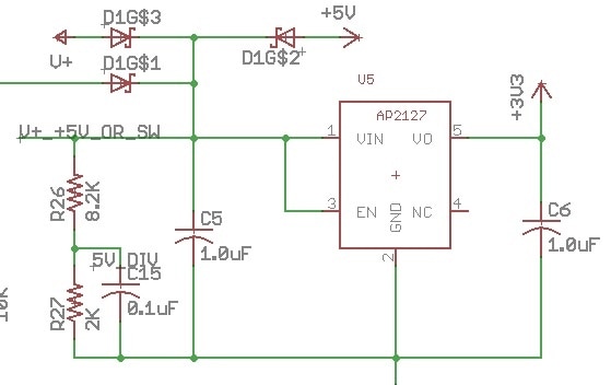

    Sean,
    I typically place a schottky diode inline with each potential power source.
    In this case, there are three potential sources of input to the voltage regulator (AP2127).
    • V+ (D1G$3) is the charger input (5 volts) that can power on the circuit to charge the battery
    • .unlabeled input (D1G$1) is a switch inline with the Li-Ion cell, that can power on the circuit - This is a momentary switch, that allows the circuit to power on long enough to verify proper battery voltage levels.  If everything is OK a boost converter is enabled which output is shown as +5V (D1G$2).  The highest voltage input (either V+ or +5V) will override the Li-Ion (through switch) input.
    This approach prevents any of the sources from becoming a load to the others by having a reversed diode in the path.
    I have used this approach several times (including on commercial devices) with no issues or problems.

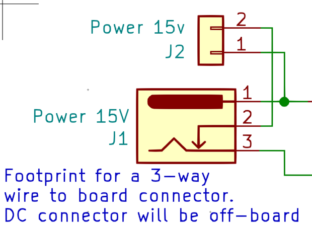

    Sean,
    I don’t know the set up you have, but if it is currently powered by a battery and you can modify it to add a diode AND you want to power it with a wall wart which implies you need to alter it to have a DC jack to take the wall wart plug then it may be easier.  DC Jacks tend to come with 3 pins, one of which is a switchable ground.  This ground is connected to the battery ground and when a DC plug is inserted it automatically disconnects the battery.  When the DC plug is removed, it remakes the contact to the battery.
    Take this example - Product LinkProduct Link - in the datasheet you will see the 3-pin diagram with pin 2, connected to pin 3 (sorry, I’m on my iPad and can’t copy).  All you would need to do is solder pin 1 to Vin at the same point as the battery, pin 3 to Vout at the same place as the battery; desolder the ground pin of the battery connector from Vout (where you just soldered pin 3) and resolder it to pin 2 of this connector.
    As I say, it depends on what you can do to your circuit.
    EDIT: back on my computer.  Here's a circuit I'm creating:
    J2 will be for banana plug sockets from, say, a bench top supply; J1 is the connector for a DC barrel Jack.  J1 Pin 1 is Vin; J1 Pin 3 is Vout.  In your case J2 is your battery and its Pin 2 would have been connected to the same point as pin 3 on J1.
    • Vote Up +6 Vote Down

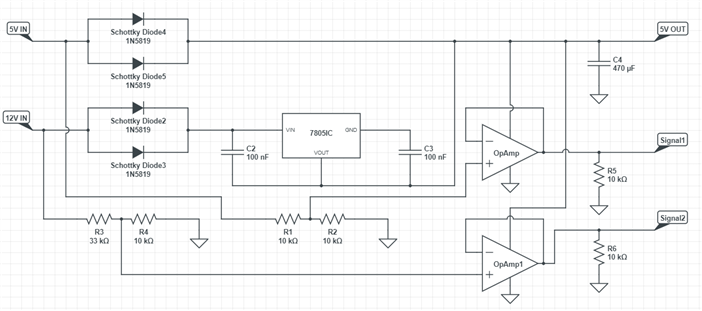

    milosrasic98 over 5 years ago
    As genebren already said, using Schottky diodes is the way to go because of their low drop voltage. This principle is also used for power switching on some of the Arduino boards. I made a circuit similar to this recently and it worked great for lower power devices, but struggled on something more power hungry like the Raspberry (due to the drop on the 5V rail and the 7805 not being able to handle such current).
    Milos

    Andrew J over 5 years ago in reply to Sean_Miller
    Hi Sean,
    Sorry for the delay, I went to bed!!
    That’s a good question and I don’t know the answer.  I believe they are designed so that pin 2 is disconnected from pin3 before pin 1 and pin 3 connect but I don’t know for sure - you may need to test or google or perhaps someone else reading this knows for sure.  If it does break before make then even though measured in small milliseconds, there’s likely to be at least a glitch on the circuit.  However, if you think about things like a laptop, Arduino, other dual powered device they usually stay active on a power switch - I don’t know if they have something else in circuit to cope with that temporary disconnect, a capacitor perhaps??
    I’m going to have to look further into that as it is an interesting question.  It’s not something I need for my circuit but it’s good to know!
    I would add that you may still want a diode on pin 1 of your battery (referring to my schematic) to prevent any potential charging attempt or damage if something fails.  One thought I had here was the reverse leakage current of the diode - it feels like you want something with as low a leakage current you can find.  Further, because the diode will be reverse biased with the DC plug in it will have a reverse recovery time: that would want to be as small as possible.
    Again, maybe someone else can confirm if I’m talking rubbish.
    I should also add that you wouldn’t want your battery connected at the same time as an external supply as it will still draw from your battery - that’s just a waste.  These jacks are specifically designed for use in a dual battery/DC barrel jack circuit.  It’s probably worth searching for example circuits and more information.

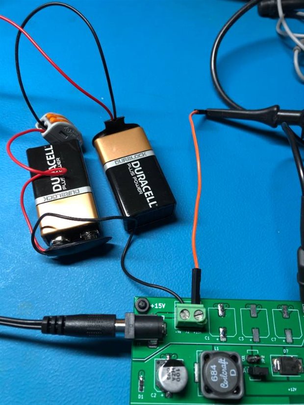

    Andrew J over 5 years ago in reply to Andrew J
    I remembered I had a circuit that I could test with.  I tied two 9V batteries in series to get 18V and tied into a board-to-wire terminal alongside a DC jack that I can use a 15V wall wart with.  The build follows the schematic I showed above and I have no diode in front of the battery:

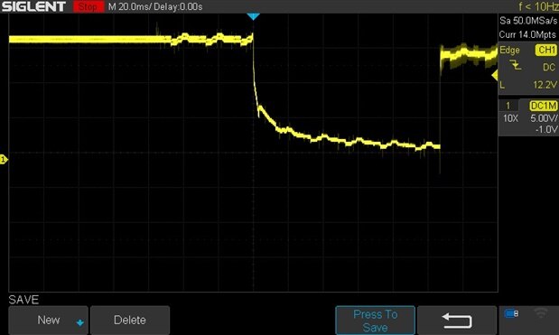

    The batteries are in series with my multimeter reading current draw.  In the image both the wall wart and batteries are attached.  In this scenario, 0Amps are being drawn by the battery; when only the battery is connected 70mA are drawn.  So what happens when I have the batteries attached and plug in the wall wart:
    You can see a voltage drop from 18V to 0V and back up to 15V.  It's not clean due to the nature of making the DC jack connection which will bounce somewhat.  That is taking circa 110ms to complete.

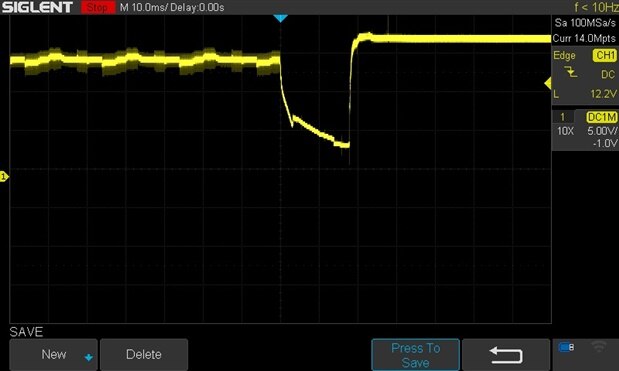

    When I remove the plug:
    You can see a voltage drop from15V to circa 3V and back up to 18V.  This is taking circa 20ms to complete.
    Ok, so these are not definitive tests but do give an idea of what is happening.  If you need to ensure your device remains constantly powered I think you should look at solutions for that scenario.  I still believe having the battery/DC Jack connected together is the right answer so as not to draw power from the battery when the wall wart is connected.
