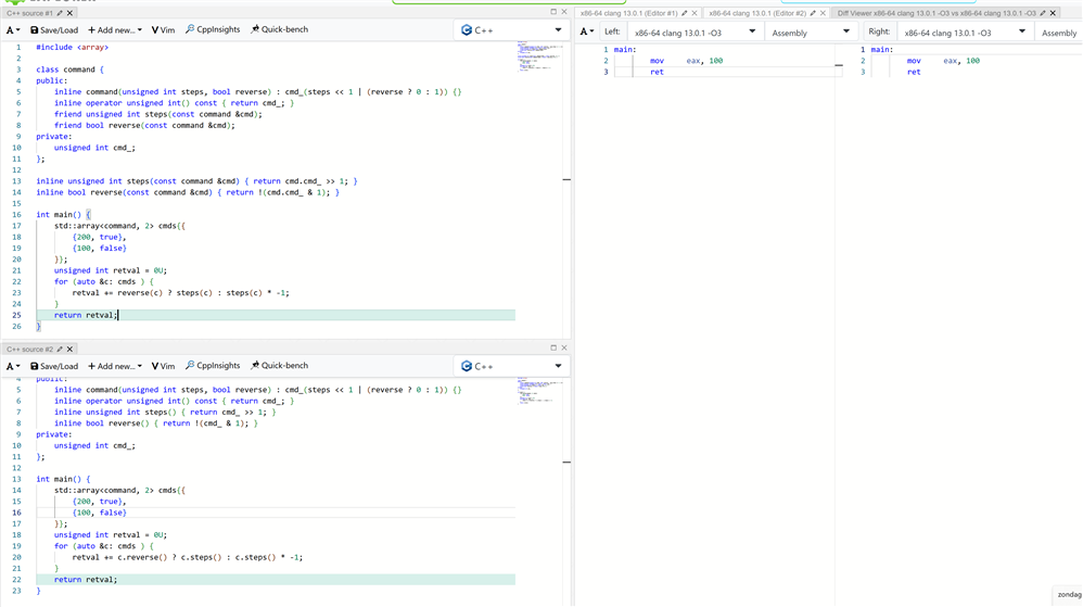

    Jan Cumps over 1 year ago in reply to Jan Cumps
    That optimiser is awesome Slight smile. Here it is in action with an array of command objects
    It also shows that an stl array is a very cheap object. Perfect container for use in an embedded program.

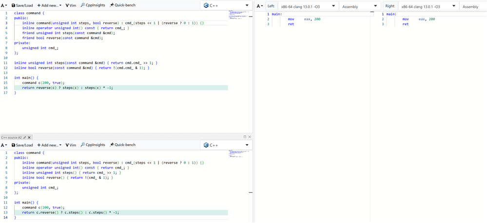

    For the compiler (with optimisation on) it doesn't matter if you use a friend or an inline non-virtual class member
    Isn't it amazing how much abstraction you can get for free? The compiler translates both examples as if you just wrote this:
    int main() {
        return 200;
