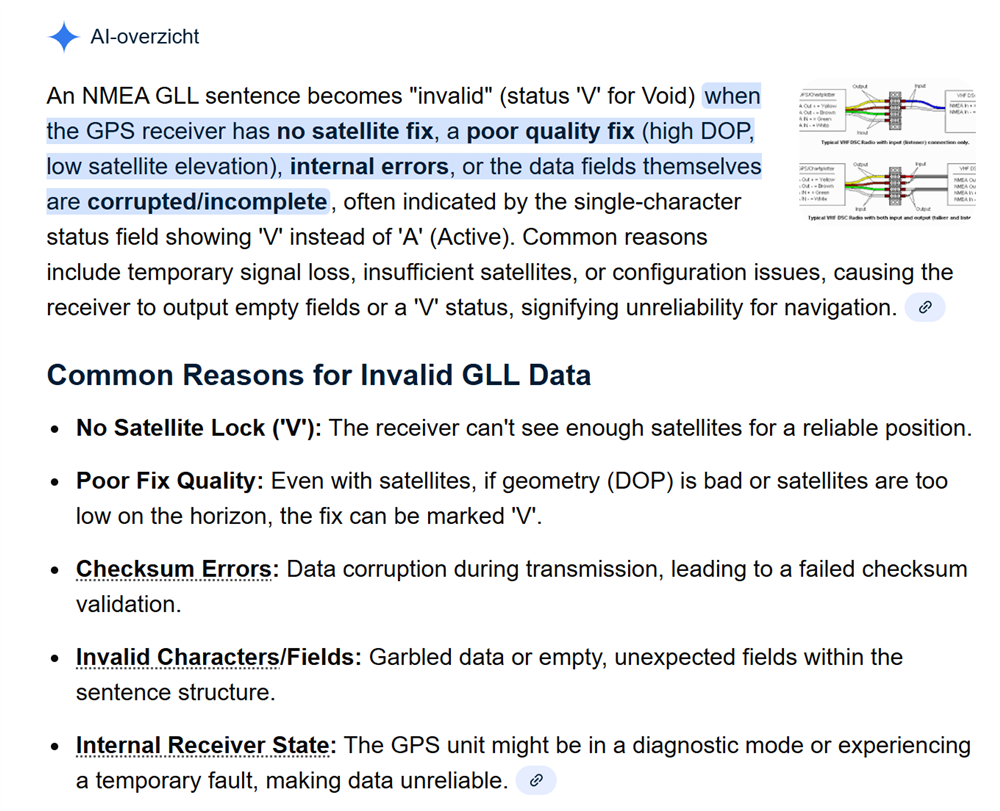

this image is a capture of AI generated content
I wrote a data parser for GPS data, that gets 30 messages per minute. In a debug session, I want the debugger to break when the GPS reports the issue. This info comes as one of many attributes of a payload string. So there is no interrupt, or unique code path, that indicates this situation.
