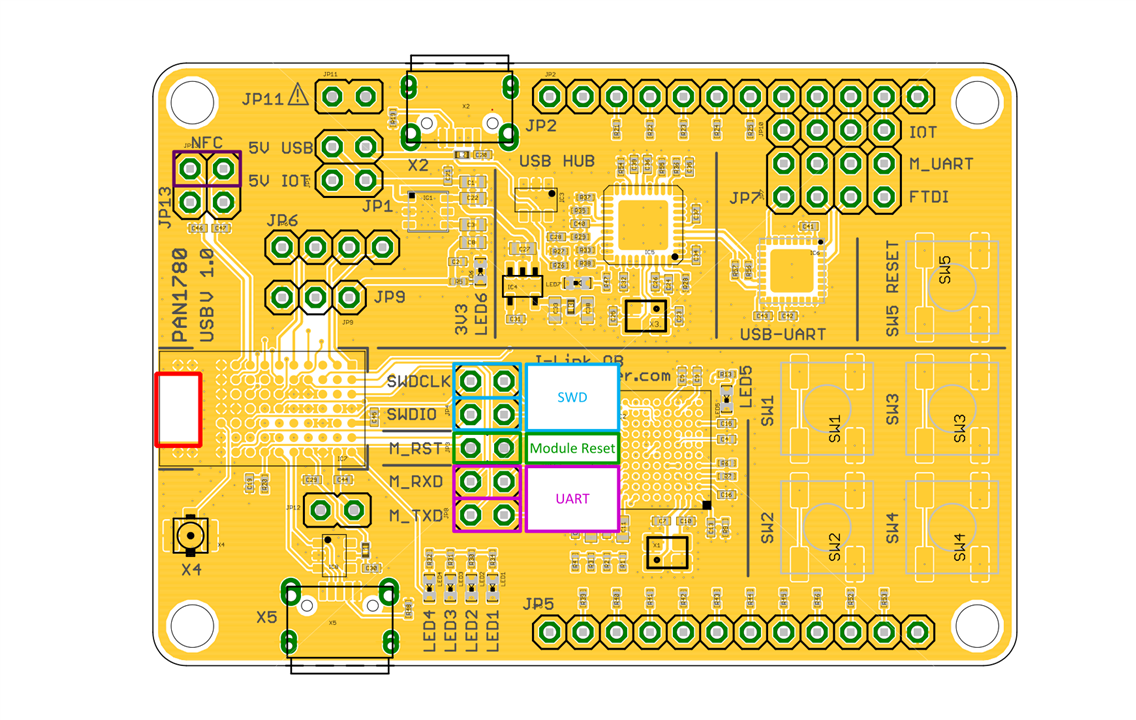

I used the Panasonic PAN1780 (nRF52840) development board as my microcontroller. I have also road tested this evaluation kit, so if you want to learn more you can click here to read the review.
As you may have noticed, from the above picture, I used a SWD compliant Particle.io DAPlink debugger to flash the PAN1780, as Mbed Studio cannot use Segger Jlink by default. The nice thing about the PAN1780 development board is that the SWDIO and SWDCLK pins are broken out for you so it is very straightforward, as shown here:

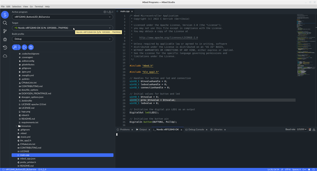

The code for my Mbed OS example was developed on Mbed Studio version 1.4.3 with the Target configured as Nordic nRF52840-DK, as shown here:
My code example is based on a flat-file architecture or design approach and makes use of a modified ble_app.h header file, which I’ve named ble_app2.h, can be found here: https://github.com/Gerriko/mbedOS_blebuttonleddemo).
This modified header file includes Gatt Server event handlers to inform you when a central client device connects or disconnects, when notifications are enabled or disabled, and when there is a read or write request or when data is updated/sent.
With this new header file, developing the rest of the application code is very straightforward.
But before I get to the detail of my application code, there is some housekeeping needed to get the BLE code project to work, i.e. a mbed_app.json file is required to provide the compiler with the appropriate settings.
My mbed_app.json file contains parameters for enabling serial output via printf statements, BLE trace logging (disabled by default), maximum desire att mtu size, and then finally adding the BLE feature to the target board.
