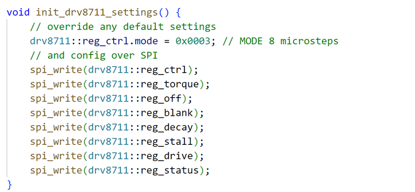

    Jan Cumps over 1 year ago
    The approach allowed me to restrict the code in my firmware to just this:
    At the same time, I used way less clock ticks and other resources (init time, memory) than TI's example. Without adding any costs to their (good, I think, but aged) code.
