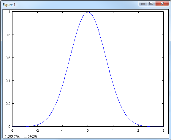

Plotting
This is another one of Octave’s strengths.  The ability to quickly and easily plot your data.  Take an example like this:
octave> x = -3:0.1:3;
octave> y = e.^(-x.^2);
octave> plot(x,y)
Just looking at the data in the variable y, it would be difficult to see its shape, but it is very clear when plotted:
