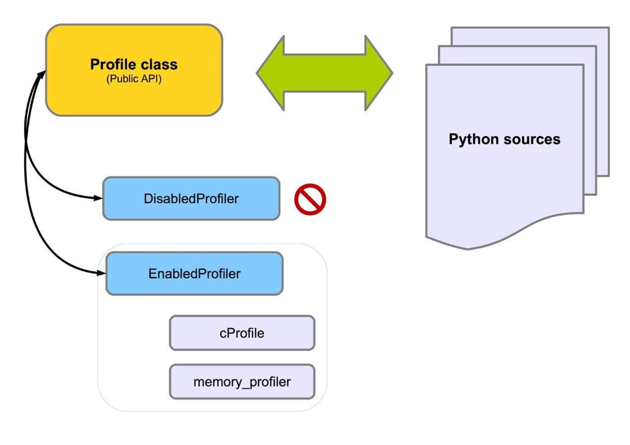

Profiler architecture
Profiler package consists of a main Profiler class exposing the API to profile timing and memory consumption used in the Python code. When the profiler is instantiated the initialisation class accept a boolean parameter. The Profile class APIs uses the EnabledProfiler class if the parameter is True or the DisabledProfiler class if the parameter is False. This permit to disable the code profiling without changing the specific profiler methods.
External references
The profiler package uses the sProfile Python profile class simplifying the calls and the creation of the output report.

Then in the blocks of code that should be profiled need to be included in the profile enable / disable APIs
def method_to_profile()
     profile.enable()
     [function code]
     profile.disable()
In the same source file can be created multiple blocks of profiled code to focus the timing profile just in the parts that are needed.
Exiting from the profiling, the profile_module method generate the the output report sent to the console.
     profile.profile_module("Function name", "Comment")
