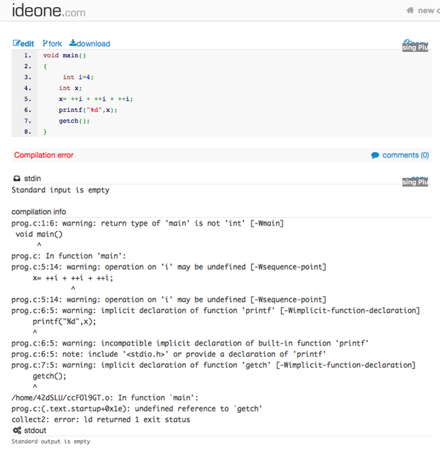

    Hi Paul,
                   My code is pretty simple and its bug free. I just want to know the logic behind both the above cases for giving different outputs. I executed them in Turbo C compiler and got two different outputs why??

  • gadget.iom
    0 gadget.iom over 11 years ago in reply to dr.akshay_1980@yahoo.com
  • dr.akshay_1980@yahoo.com
    0 dr.akshay_1980@yahoo.com over 11 years ago in reply to gadget.iom
    Hi Paul,
    I have just compiled them in codepad.org and ideone.com     just see the following links
    http://ideone.com/wxl59o
    http://codepad.org/X8PGNWlp
    The answer comes out to be 19 but in turbo c++ 3.0 IDE it is 21
    How could you please explain step by step.
  • gadget.iom
    Ahhh... Complete code usually helps image
    As for the problem...
    You have fallen victim to undefined behaviour as a result of each compilers interpretation of ambiguous code.

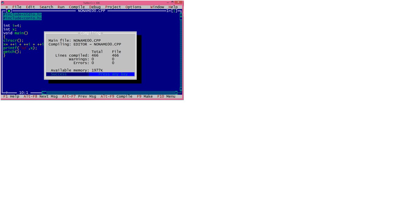

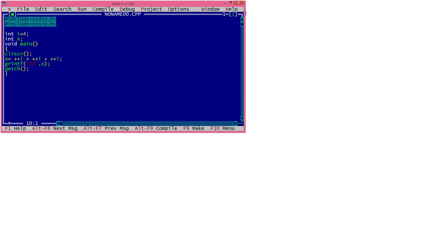

    0 shabaz over 11 years ago in reply to gadget.iom
    Am I seeing right? That's a 24-year old compiler and IDE?
    Akshay, GCC is free, and can run in a Linux VM (I presume you're running a VM since you performed a screen capture of the Turbo C++ IDE).
    0 dr.akshay_1980@yahoo.com over 11 years ago in reply to shabaz
    yup thats true shabaz, its old compiler, I just want to see the behaviour of two different compilers for same query , other one GCC under linux.. but could not understand the answer... still puzzled.. how its 19.
