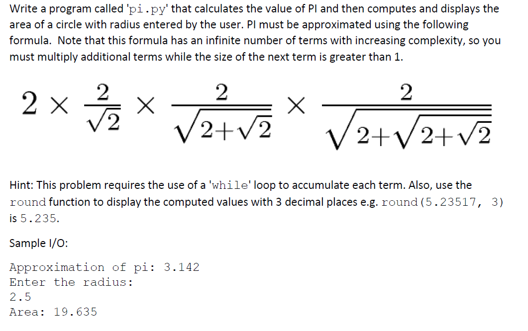

I was given an assignment question requiring the use of Python 3 and a while loop to find an approximate value of pi (we aren't allowed to use the function).
I was able to work something out but it does not approximate the correct value. This is the code that I came up with:

Any ideas?
  • beacon_dave
    0 beacon_dave over 8 years ago
    Your algorithm doesn't appear to match the equation provided.
    You appear to have missed the first '2 x ' in the accumulator
    root = math.sqrt(2)
    accum  = 2
    accum = accum * ( 2 / root )
    and then in the loop it is not:
    foo = 2 / math.sqrt(2 + prev)
    but more like:
    bar = 2 / math.sqrt(2 + prev_denom)
