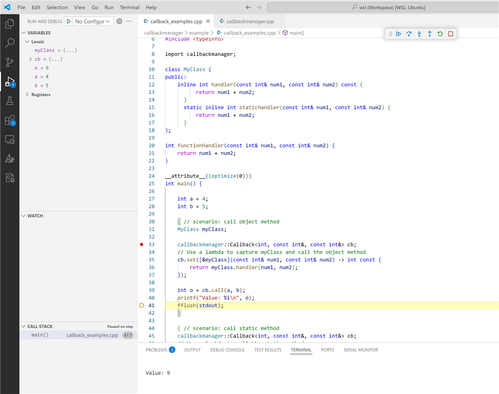

I tried out this exercise: how does VSCode integrate with WSL and the GNU toolchain? it turns out that this is straingtforward. Assumption is that you have VSCode installed, and have a WSL with a C++ toolchain (I have an Ubuntu with GCC) and GDB.
There are only a few steps required. You
  • install the VSCode Remote Development extension,
  • connect to a WSL share
  • install  C++ Extension
  • create a cpp source file.
  • run it
It's that simple to get started. I had buckled up for a difficult experience, but this worked right away.

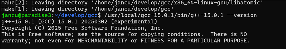

    Also: this was an excuse to get a GCC version 15 development environment available on my laptop: works
    Jan Cumps over 1 year ago
    works Slight smile
    works Slight smile
