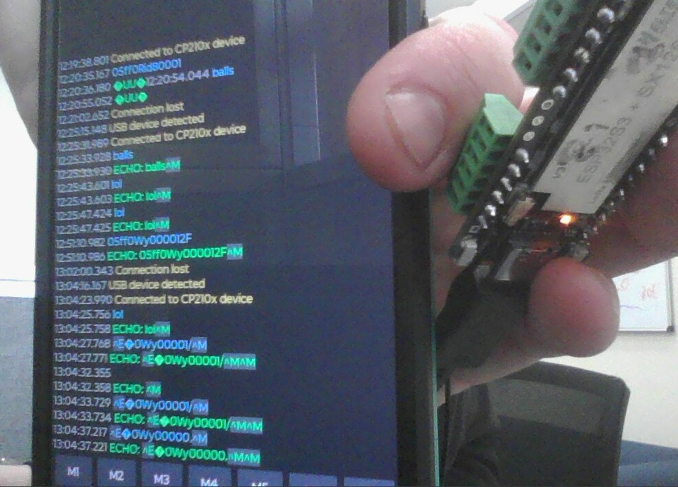

well anyway, the app I want to write would send my PLC IO control commands to a PLC via USB.
which commands formatted in hex? The commands below for IDEC series PLCs.
This app:
https://play.google.com/store/search?q=usb%20serial&c=apps&hl=en_US
has macros, and I am really ansy to test it.
I wrote an arduino echo back program:
void setup() {
Serial.begin(115200);
while (!Serial) { } // wait for a connection
Serial.println("READY");
void loop() {
// connect phone and see if you get transmission interactions
if (Serial.available()) {
String input = Serial.readStringUntil('\n');
Serial.print("ECHO: ");
Serial.println(input);
which works great!
but I want to talk to the PLC now!
05 FF 30 57 79 30 30 30 30 31 2F 0D
05 FF 30 57 79 30 30 30 31 31 2E 0D
05 FF 30 57 79 30 30 30 32 31 2D 0D
05 FF 30 57 79 30 30 30 33 31 2C 0D
05 FF 30 57 79 30 30 30 34 31 2B 0D
05 FF 30 57 79 30 30 30 35 31 2A 0D
05 FF 30 57 79 30 30 30 36 31 29 0D
05 FF 30 57 79 30 30 30 37 31 28 0D
05 FF 30 57 79 30 30 30 30 30 2E 0D
05 FF 30 57 79 30 30 30 31 30 2F 0D
05 FF 30 57 79 30 30 30 32 30 2C 0D
05 FF 30 57 79 30 30 30 33 30 2D 0D
05 FF 30 57 79 30 30 30 34 30 2A 0D
05 FF 30 57 79 30 30 30 35 30 2B 0D
05 FF 30 57 79 30 30 30 36 30 28 0D
05 FF 30 57 79 30 30 30 37 30 29 0D
So i wrote some macros to send commands. but I'm stuck until 5 because I don't have some adapter.
