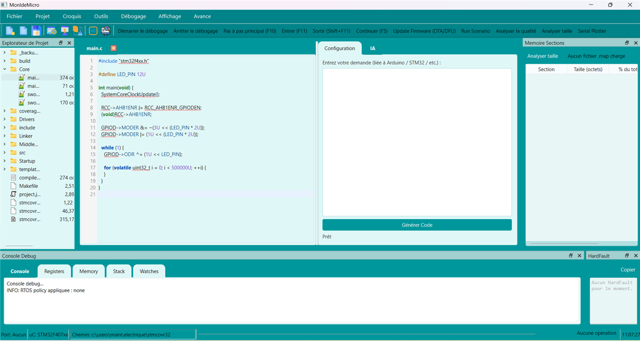

Hi everyone,
I’m building an open-source desktop IDE for microcontroller learning and prototyping, mainly focused on Arduino and STM32.
The goal is not to replace professional tools like STM32CubeIDE, PlatformIO, Keil or IAR, but to provide a simpler learning-oriented workflow for students, technicians and training centers.
Current / planned features:
- Arduino and STM32 project creation
- Build / upload workflow
- Serial monitor and serial plotter
- STM32 debug with GDB/OpenOCD
- Register / memory / stack views
- Basic SVD peripheral view
- Static analysis with cppcheck / MISRA-light
- Coverage reports
- Crash / HardFault reporting
- Power profiling demo via UART/SWO-style events
- QEMU/Renode simulation experiments
I’m looking for honest feedback:
1. Would such a tool be useful for education or training?
2. Which feature would be most valuable?
3. What would make you trust or not trust this kind of tool?
4. Would it be better as a VS Code extension, standalone IDE, or educational toolkit?
5. What pain points do you have with current embedded IDEs?
I’m not trying to promote a paid product here. I’m trying to validate whether this project should continue as an open-source educational tool or pivot toward a smaller specialized utility.
Thanks for any critical feedback.

    Curious what's motivating this, because I cannnot see a real need. The Arduino IDE has the benefit that there are thousands of tutorials and YouTube videos, showing that IDE in use, so that's the IDE that beginners will find easiest to get up to speed with.
    The STM32 doesn't have anywhere near the same traction for beginners, so a simple IDE for that might not be very popular (is the aim to make STM32 more popular among beginners? If so, to what benefit?). Advanced beginners/enthusiasts will be comfortable using existing IDEs.
  • BigG
    BigG 6 months ago
    You have listed some interesting features, but before diving into these, ask the simple question: "what problem am I trying to solve".
    So, if you are educational focused, what are the pain points. Explore these first before coming up with a list of features.
    It's already a crowded market, so determine the gaps between what is currently on offer and what is lacking. All products have strengths and weaknesses.

    Thanks, fair point.
    I’m not trying to replace Arduino IDE directly. My idea is more about the step after Arduino: helping users move toward STM32 and other microcontrollers with less friction.
    Two things I’m exploring as differentiators are:
    1. AI-assisted workflows: helping users understand compiler errors, suggest fixes, explain faults, generate starter code, and guide debugging.
    2. Multi-microcontroller support: not only Arduino or STM32, but gradually supporting other families in one learning-oriented environment.
    That said, I understand the risk: if it becomes just “another IDE”, it may not be useful enough. Maybe the real value is an AI-assisted educational/debugging tool rather than a full IDE replacement.
    Do you think AI-guided debugging and learning would make this more useful, or would existing tools still cover the need well enough?

    You’re right. I was thinking too much in terms of features.
    The problem I’m trying to validate is whether learners get stuck when moving from Arduino to STM32 or more realistic embedded workflows: toolchains, OpenOCD/GDB, linker scripts, registers, faults, and build errors.
    Before adding features, I need to identify the real gaps in existing tools and understand what students, teachers, or technicians actually struggle with.
    Maybe the answer is not a full IDE, but a smaller learning/debugging assistant.

    Thing is, you're almost teaching them "how to program".  Arduino is so well served and the IDE and environment already simple for beginners I wouldn't focus on that segment - remember, the Arduino environment has already abstracted away the complexities of programming the ATMEL MCU (read the data sheet and you'll get an idea of how well they've done!)  My first thought was how to translate what I know about programming an Arduino into developing on another MCU.  The complexity of that problem though lies in the abstraction and the reality is beginners are not going to be using those MCUs - they will stick with Arduino, ESP etc.  Compiler and linker settings, environment configuration, MCU specifics etc all require a good degree of problem solving developed from experience, e.g. my first foray into a Renesas MCU from Arduino  didn't require me to know that MCU specifically, but it did require me to spot, troubleshoot, research etc etc, all skills obtained over 30 years in IT.  And that was with a Renesas developed C compiler hooked into Eclipse. I don't think your target market overlaps: beginners are well served by the Arduino environment and when they are ready to move to other microprocessors they will have the experience to not need the level of handholding.  I admire the idea though: perhaps asking on the Arduino forum what people might like to see might give you some ideas?  Certainly, I think a focus on helping people to transition from a simplistic Arduino environment to a more complex one might have some legs.

    Thanks, that makes sense. I think “beginner IDE” was probably the wrong way for me to describe it. The more realistic target may be people who have already used Arduino and now want to understand what happens underneath when moving to a more complex MCU workflow.
    So the focus would not be “teach programming from zero”, but help with the transition: build systems, compiler/linker messages, MCU-specific configuration, registers, debugging, and fault analysis.
    I agree that beginners are already well served by Arduino. The gap I’m trying to validate is the step after that.
    Your suggestion about asking Arduino users what they struggle with when moving beyond Arduino is a good one. That may give me a clearer picture of whether this tool should exist, and what problem it should actually solve.

    BigG 6 months ago in reply to Moussa1492
