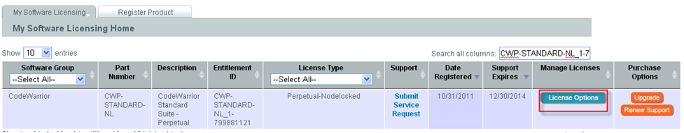

Click on Software Licensing under My Secure applications menu. — "My Software Licensing Home" page will appear showing your currently licensed products.

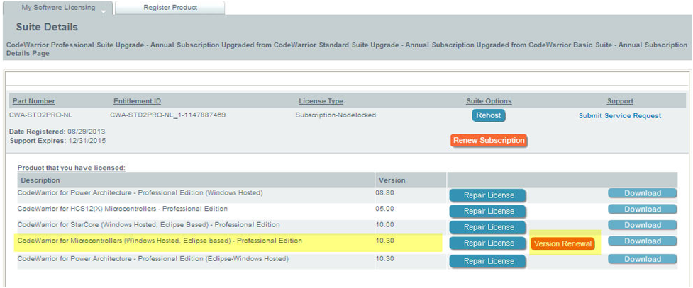

Look for the entitlement ID for the license you wish to use, and click on License Options.
Look for the version you want to renew version for, and locate Version Renewal button. This option will be enabled only for those versions which have a new released version. Additionally, in order to have access, your yearly Technical Support/licensing  must be active. You can review your expiration date under Support Expires Colum on your Software Licensing Home page.

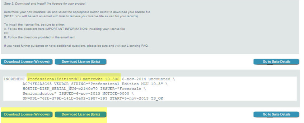

After clicking on Version Renewal, the Display License page will appear showing you the latest license file for the new version, in this case license version for 10.5 Eclipse Based SW CodeWarrior.  It will also provide you with a “click here” link to download the current v10.5 release if you have not already installed it.
Click on Download License link and save the new license file to the MCU folder of your CW for MCU v10.5 installation.  After re-launching CodeWarrior, the new license.dat file should function as expected.
