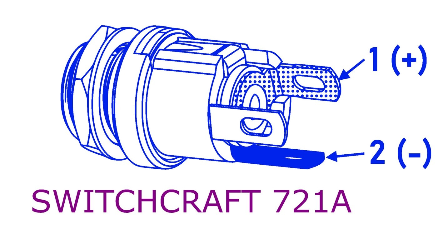

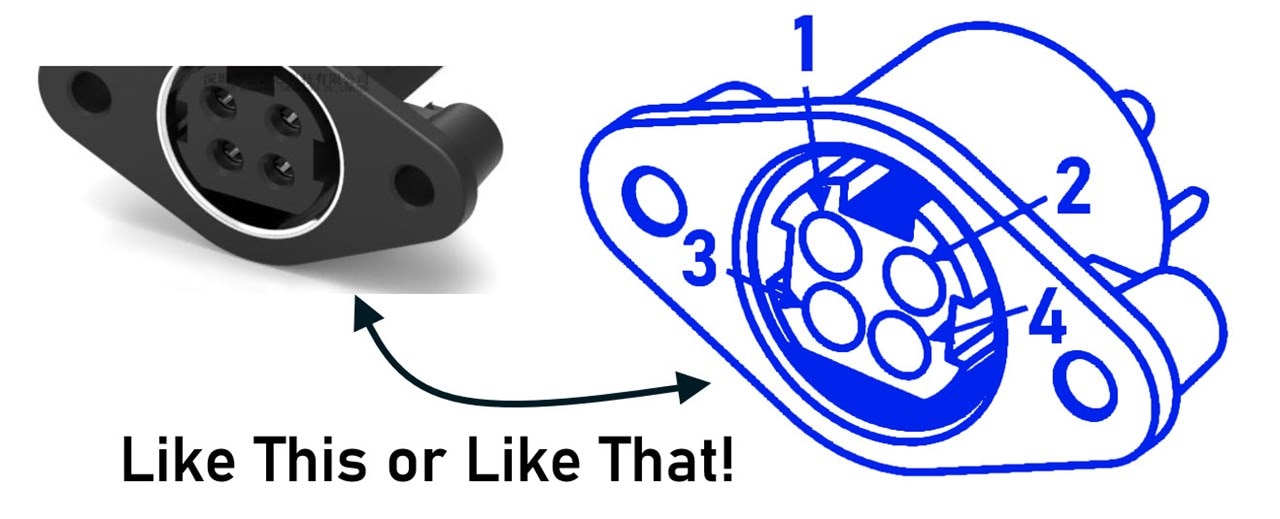

I always find it annoying figuring out connector pinouts, and so I sometimes place an illustration of the connector directly into documentation. However, sometimes it is hard to find a decent illustration!
This very short blog post describes a method I recently tried using, which relies on the availability of a 3D CAD file for the part in question.
In brief, the process involves viewing the 3D CAD model using FreeCAD, orienting it to the desired view, then displaying it in black-and-white outline form, and saving it as a vector format (SVG) that can be easily edited using InkScape.

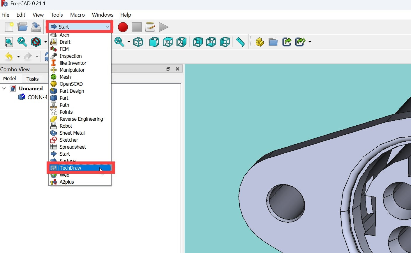

FreeCAD uses the concept of WorkBenches, which are essentially sets of tools for different tasks. Near the top of the FreeCAD window, you can click on a Start drop-down and change to the TechDraw workbench.

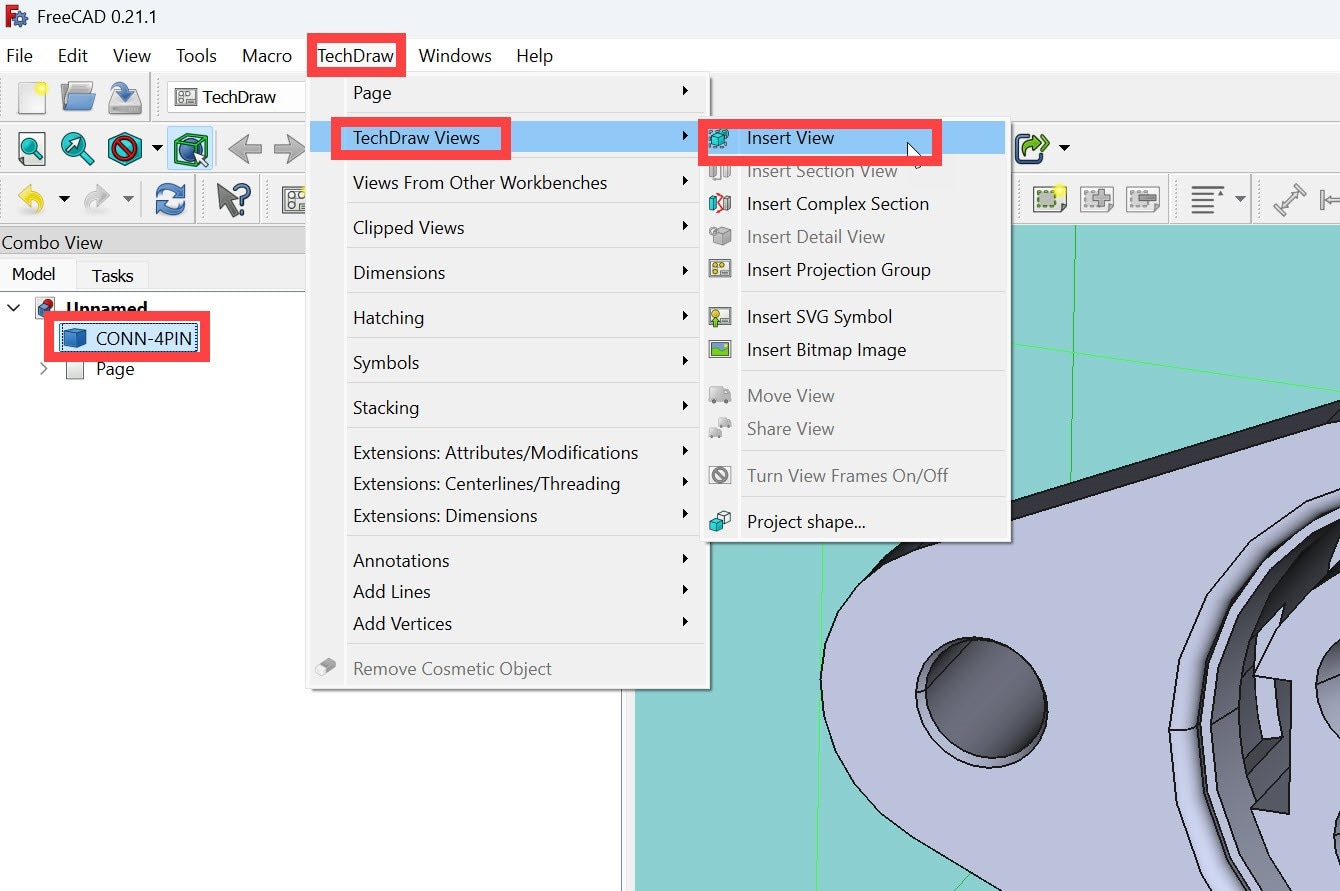

The aim is to create a technical illustration page, and place the 3D model onto it. To do that, click on TechDraw->Page->Insert Default Page (or Insert Page using Template and then select any template, such as A4 or Letter paper. A blank page will appear.
On the left side, you’ll see the Page object appear in the tree view. Above it is your 3D model name. Click on the 3D model name once to select it, then go to TechDraw->TechDraw Views->Insert View.

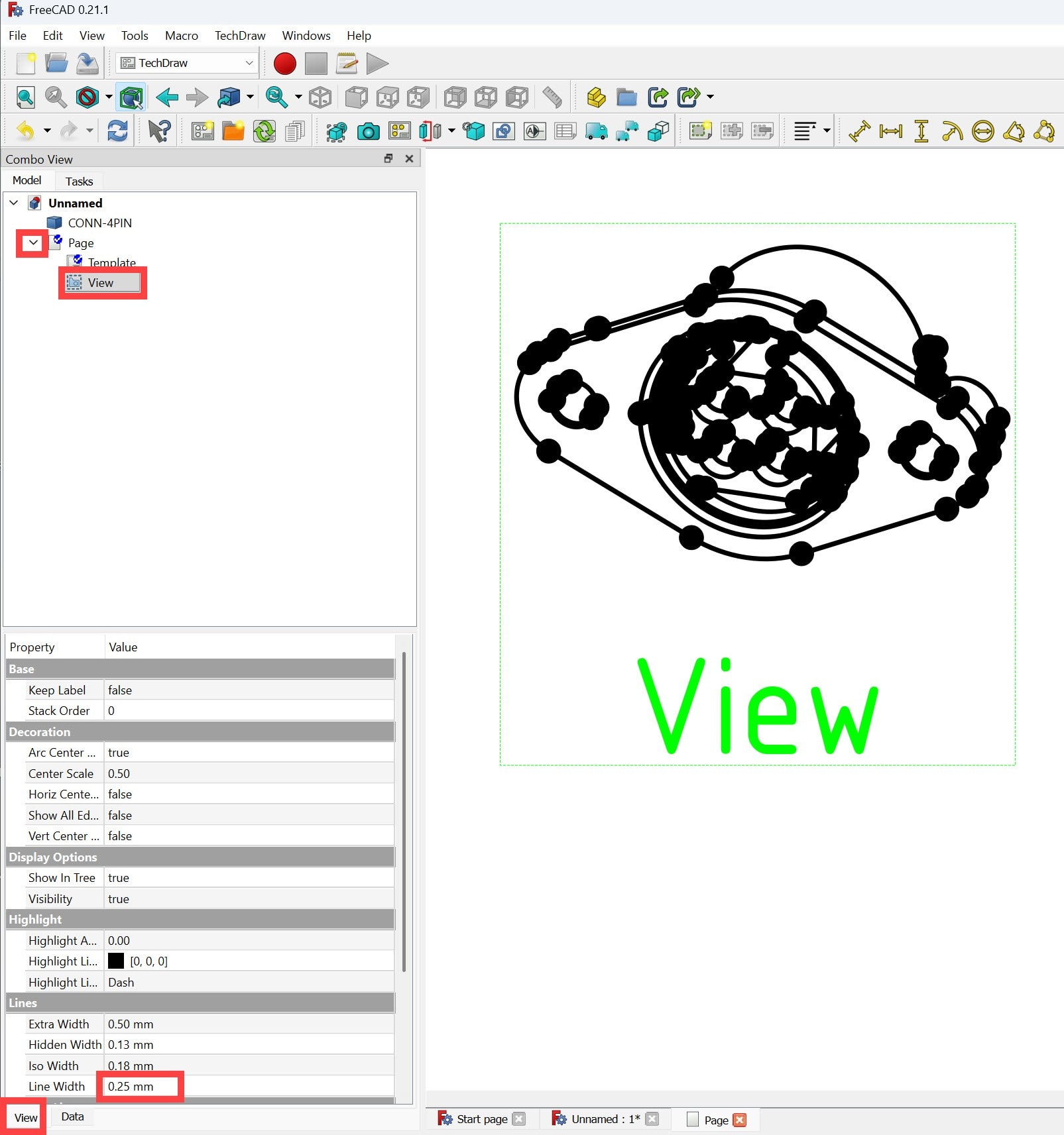

Next, expand the Page in the tree view, then select View in the expansion as shown in the screenshot below. You’ll see a black-and-white illustration appear in the main window, although it might be small and you’ll need to zoom in. The lines may have round blobs on the ends. If the lines look too thick, then on the left side, in the Property list, click on View at the bottom, and then modify the Line Width property to (say) 0.1 mm. You’ll still see round blobs, possibly, but that will be automatically resolved in the next steps.

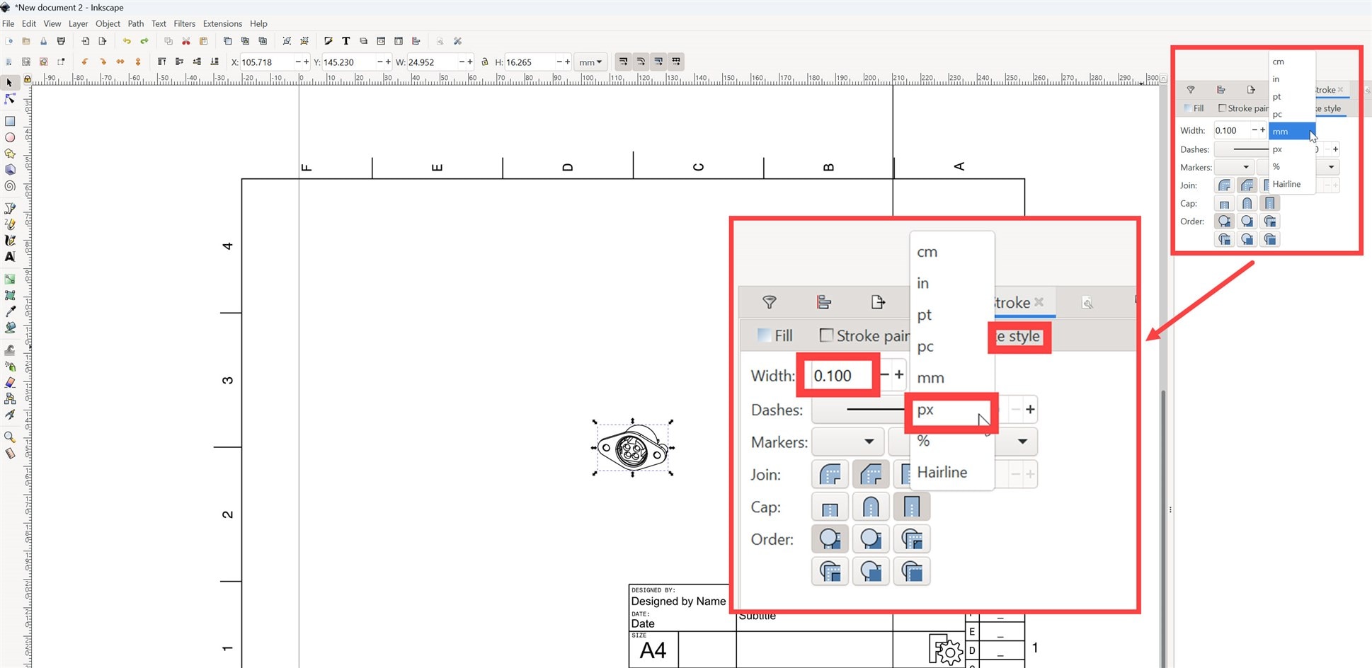

Launch Inkscape software, create a new document, and then go to File->Import and load in the SVG file. It might appear small, so zoom in. Any round blobs have hopefully disappeared.
With the SVG illustration selected (you could just type Ctrl-A to select all), click on Object->Ungroup
Note that if your illustration has a technical drawing border around it, you can select it and delete it at this stage if desired.
Click on Object->Fill and Stroke and select the Stroke Style tab in the pane on the right. Now you can change the line width as desired (it’s easier by doing it using px rather than percentage, and trying fractional values like 1.2 or whatever.

Once you’re happy, save the illustration in PNG format (I simply did a print-screen, rather than use FreeCAD for that) and then add any annotations using whatever editor you’re comfortable with (I used PowerPoint, and then did print-screen again to save to the final desired PNG file).

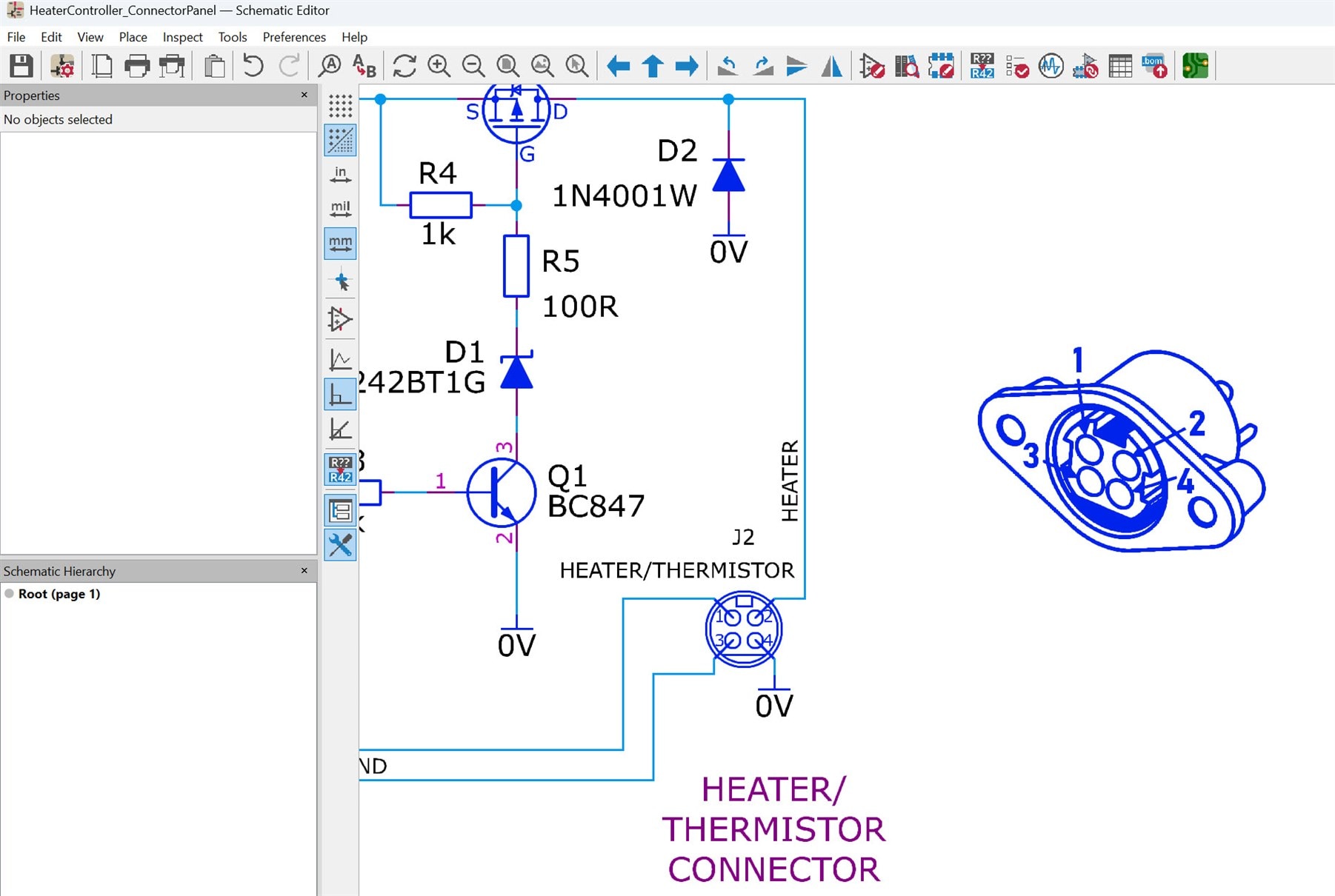

The PNG file can be used directly in documents such as Word files. If you wish to insert the image into the source schematic file, then that can be done using KiCad’s Image Converter program from the KiCad Control Panel.
Launch the Image Converter, go to File->Open and select the PNG file. On the right side of the Image Converter, select the desired image size, then choose the Output Format to be Symbol, and then click Export to File, and choose an appropriate name.
Next, open up KiCad’s Symbol Editor, and choose a user library, and then right-click on the library name and choose Import Symbol. Locate the file, name your symbol, save the result, and you’re done; it can now be added as a symbol into any schematic.

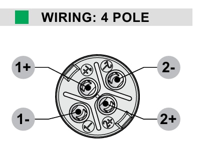

    These type of illustrations are often very useful for installing connectors whilst out in the field where poor lighting can make it hard to read the tiny embossed markings next to the terminal and you have to rely more on the physical geometry to orient them correctly.
    This week my 'office' was 8m up in the air on the underside of a ceiling, where the lighting provision was less than favourable. Unfortunately the assembly instructions had omitted the positions of the mating keys on the shell on the 2D outline drawing and the design is otherwise symmetrical.
    Luckily I had spotted this earlier and penned them in.
    The Knipex bootlace ferrule crimps got a good work out - I'm glad I got the more comfortable handles in the end !
