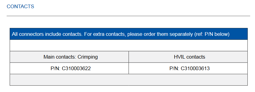

anywone knows if those connectors: HVSL630062A10610(farnell code:2806702) and HVSL630022A106(farnell code:2806701) includes pins and sockets? I'm not able to find the contacts specified on the manufacture documents so I hope they are included. Right?

    I don't work for element14 - but I believe they do as on Page 40 of the datasheet at http://www.farnell.com/datasheets/2372588.pdf
    The first line states "All connectors include contacts."

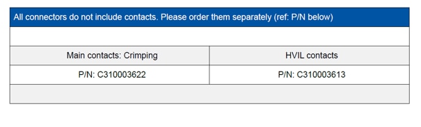

    Hoping this brouchure is refering exactly the selling products because Amphenol sent me a similar one with the opposite sentence:

    That's quite tricky, but seeing as the data was obtained by clicking through from the element14 product page, I certainly hope it is accurate. I would expect most connectors to have contacts, especially when the type of contact is listed on the page as "crimp type" and "2 contacts".
    If not, you will probably have to contact your local office about it. Unfortunately I haven't had any experience with this product myself.

    Please also make sure that you are looking at the right page. Note that even the catalogue I listed shows HVSL630 series including contacts, whereas the HVSL633 just a few pages down does not include contacts despite having the same part number for contacts.
    Hope this helps?
