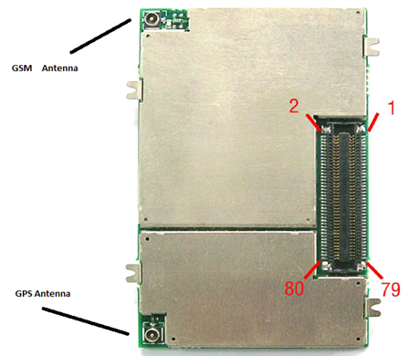

We're developping an appliance that's uses the sim548 GSM/GPS module.
However we're having some trouble by finding a GPS antenna or connector that fits the sim548 module.
The technical datasheet states that we should use a MXTK92XXXXX murata connector.
After som searching we've discovered that the IPEX (IPX13) or GSC connector's also fit the module.
We were however not been able to find a GPS antenna that uses one of those connectors.
We currently have a GPS antenna WI-SYS  WS1357-15-HFLWS1357-15-HFL ANTENNA GPS that has an HFL connector
but this does not realy fit as it should be.
Are there any suggestions?

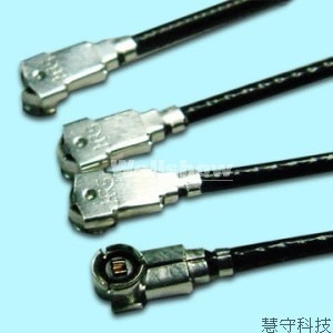

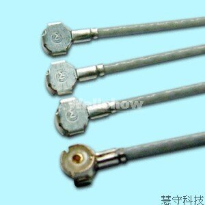

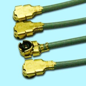

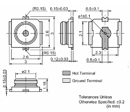

    0 e14 Contributor over 16 years ago in reply to e14 Contributor
    This is the sim548 module:
    This is the male connector from the SIM548 module:
    This is a picture of GSC connector (murata) wich the manufacturer of the SIM548 module advices
    This is a picture of a IPEX connector that also fits the connector:

    We have found a solution,
    it seems that the connector is also know as an U.FL connector..
    And when we searched for gps antenna's with such a connector we found a few.
