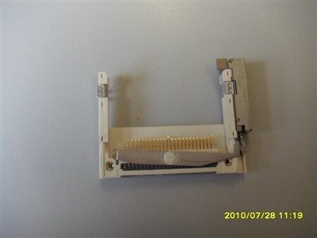

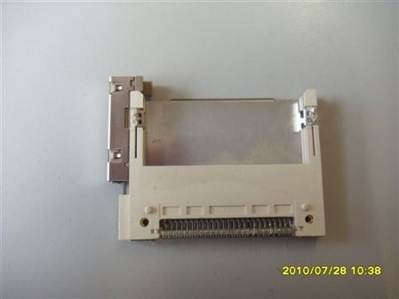

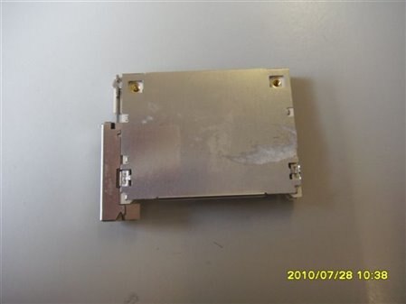

I was wondering if anyone out there can help me to identify  a CF card Header. I need to purchase more of these, but i'm are unable to work out who the manufacturer is or any part numbers. The only number on the unit is 82LCC. Below are some pics
Any help or assistance is appreciated

    This does not appear to be a Molex part number but all CompactFlash Card connectors and headers are made to a certain standard. I have provided to you a link to our CompactFlash site. You can download the drawings of a part that looks similar to yours to make sure that all the dimensions are the same. Once you have the part number you can then order it from Farnell/Newark. You can even order samples of it right from the Molex.com site to make sure it is the correct part. I hope this helps and good luck.

    without a manufacturer's part number it would be very difficult to trace the souce of this since so many manufacturers produce compact flash connectors.  Please feel free to browse the Farnell CF profile online for a suitable alternative:

    Many thanks for your reponses. I think i have  worked out the part, its a 3M N7E50-M516RA-40-C. Does anyone know where i can purchase this part from  in small quanties <100  or can recommend an alternative part...

    The closest alternative 3M part available on Farnell's website is N7E50-M516RB-40-WF.N7E50-M516RB-40-WF..

    You can buy the RB version of this connector (N7E50-M516RB-40-WF) connector from the Element-14 E-store, Part# 93K6316. No minimum buy and 1050pcs in-stock!

    The difference between the RB and RA is the plating option.
