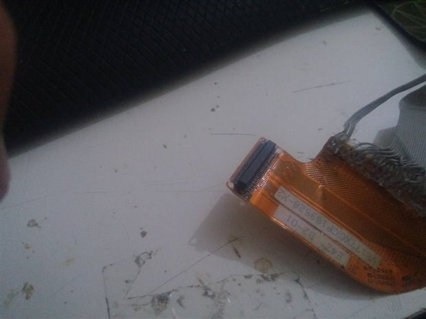

Hello,
i want to order some connectors but i dont know what type is it!
this is a notebook IDE extension cable to connect to the hard drive(http://goo.gl/mQJCQc )
it is a 60 pins smd connector
this is the connector i want:

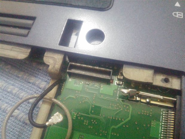

and this is the oposite one:

    Looks similar like connector on Intel Edison. Pretty sure its from Hirose. Is it 0.5mm pitch? Maybe something like this:
    DF12A-60DS-0.5V(81) HIROSE(HRS), Board-To-Board Connector, DF12 Series, 60 Contacts, Receptacle, 0.5 mm, Surface Mount, …

    Thank you very much!!! i finaly found what i needed!!
    male is: DF12C (3.0)-60DS-0.5V (81)
    female is: DF12E (3.0)-60DP-0.5V (81)
    and again Thank you very much!!
