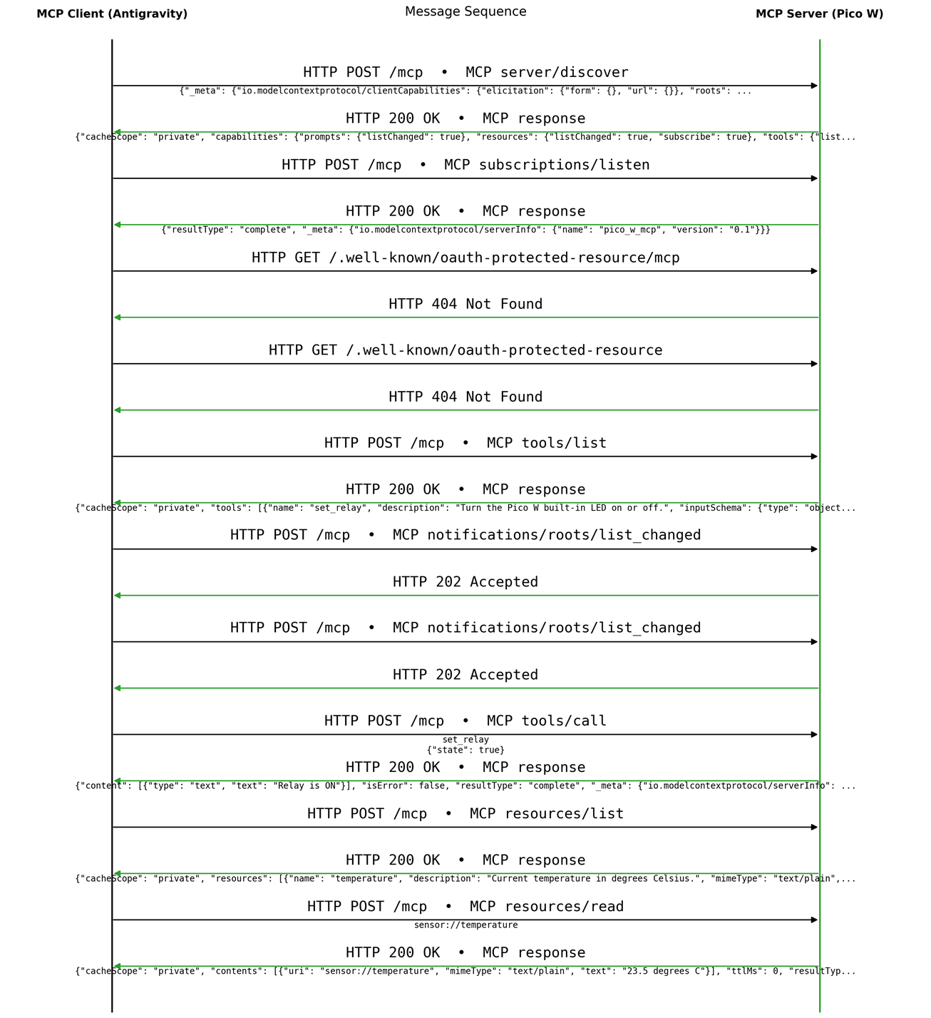

MCP is ridiculously simple in theory. The AI agent (which acts as the client) can be configured with the server details (such as IP address), and then on startup, the agent will send a server/discover message to learn what categories of things the server supports. The server responds back with “capabilities” which are essentially “tools” and “resources”.
Next, the client asks for a list of tools and the server provides that in a response. An example tool could be as simple as a relay.
The client then asks for a list of resources - a sensor could be a resource.
Later, when the agent wishes to activate a tool (a relay in this example) the agent (client) will send a “tools/call” message with the required relay state, and the server responds accordingly. If the agent was curious to know the resource value (such as temperature) then it will send a “resources/read” message for the server to respond to.
That’s it pretty much. The secret to why this works as well as it can, is that the responses to the tools and resources list requests contain verbose descriptions about what the tools and resources are about. It gives the agent useful information it can stick in its context, and include that when making decisions.
There are a few more MCP messages not mentioned here (there's a ping-pong diagram of real network traffic later), but the important ones are covered.

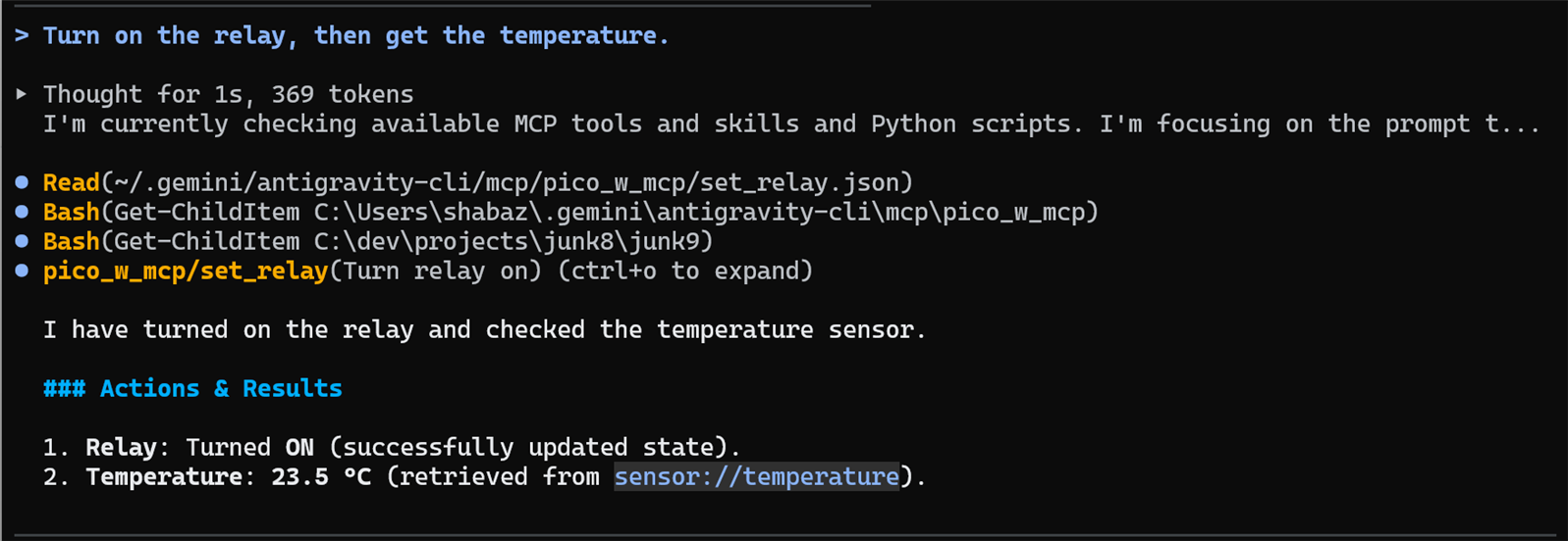

Consult the documentation for the system you’re using. With Antigravity CLI, all that needs to be done is to type the following in a Linux shell or Windows PowerShell (change the IP address to match the Pi Pico, and notice that the pico_w_mcp name that was used in the source code is used; I’m not sure if that is essential, but it’s what I did):
agy mcp add --type http pico_w_mcp http://192.168.1.159:8000/mcp
Next, run Antigravity, and try typing in something that needs interaction with the MCP server.
If you’re curious, run WireShark at the same time. The diagram here shows the interaction I saw on my PC (click to enlarge).

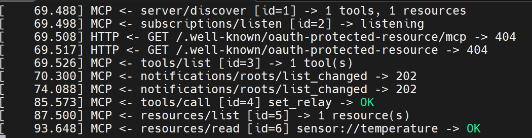

Here's what the serial console revealed from the Pi Pico point of view:
