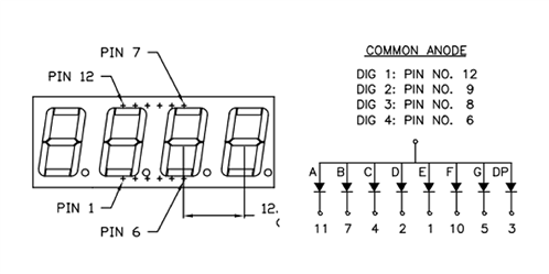

Without specifying the exact four digit seven-segment display, step one of this tutorial may vary by user but focuses on connecting the project components. Below you can find the pinout for the seven-segment display used by our team, with important pins called out for quick connection reference.
Reading from your seven-segment display reference sheet, use the jumper wires to begin connecting your Cmod A7 and display as illustrated alongside the connection table below.
