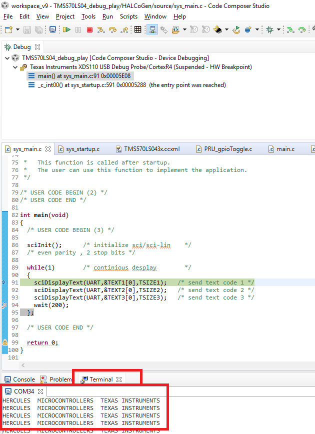

UART
This is a fairly standard function when you work with an evaluation kit. Most manufacturers provide debug and UART support over USB.
In a test situation, also when your design does not need serial communication, you can use this to exchange data between the harware and the debugger.
You can embed debug specific UART commands in the firmware that aren't part of production firmware that help the automation.
You first load the debug firmware and run test cases that rely on that feature.
Then you load the production firmware and run the tests that don't need this interaction.
For designs that have serial communication as a production feature, you can use the debugger to test that.
The debugger's TX connects to the controllers RX and vice versa.
