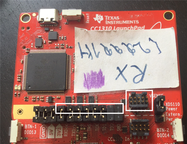

You can still get by for early prototypes of your device. Several dev boards allow to tap off the debugger signal and use it to program other devices.
While working on your bench, you can use the original dev board's debugger and wire it up to your early proto's JTAG (and optionally serial RX/TX) lines.
In particular the SimpleLink CC1310 LaunchPad is handy. It has a dedicated 10 pin debug output  connector and most pins can be tapped of via the jumpers in the middle of the board.
But these emulators don't have all debug pins - it's a subset. And it's not an officially supported debug/program device for production use.
Given these constraints, they are still excellent for home and early design.

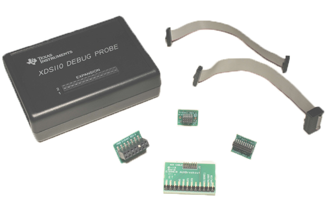

What's in the Package?
The debugger comes with a few add-ons. These allow you to adapt the pin-out of the probe (see TI Compact 20-pin in the table below) to a few popular configurations.
source: product page
There's an auxiliary output with configurable I/O pins and a supply that can be used to power your target design.
These are the main parts:
  • debugger
  • TI 20-pin debug cable
    • TI 20-pin to TI 14-pin converter adapter
    • TI 20-pin to ARM Cortex 20-pin converter adapter
    • TI 20-pin to ARM Cortex 10-pin converter adapter
  • 14-pin auxiliary cable
    • Breakout board for auxiliary cable

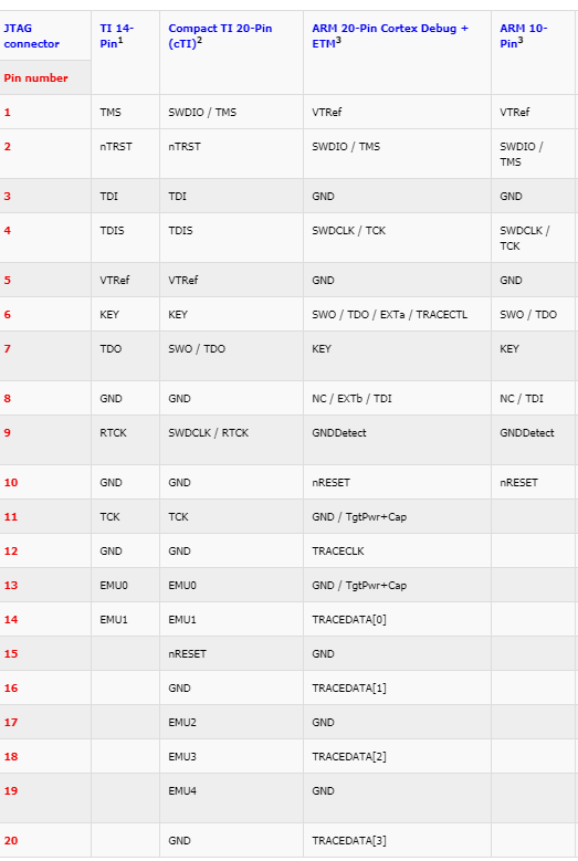

The layout of the JTAG types supported by the device are shown below.
source: TI Resource Explorer
Column 2, 4 and 5 are supported by the 3 adapters. Column 3 is the pinout of the default flat cable.

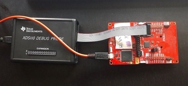

Tests

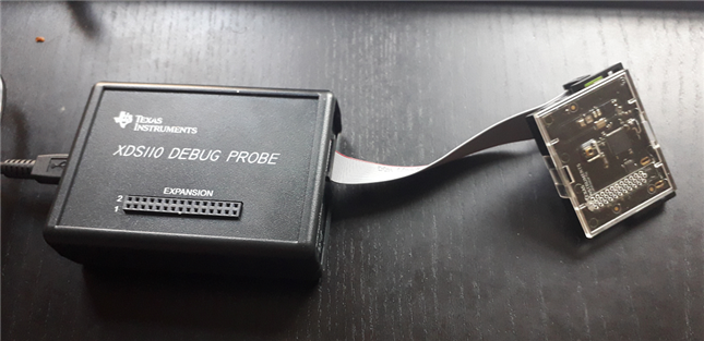

I've tested the debugger with three different ARM microcontrollers.
The SimpleLink CC1310 shown above in the blog header.

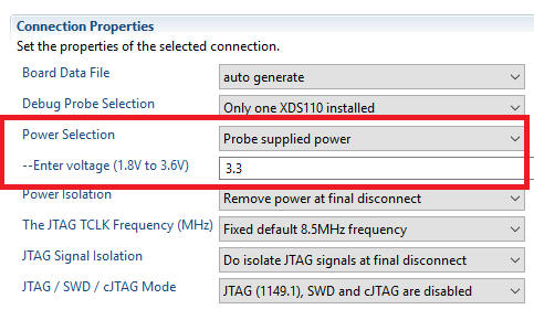

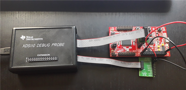

A Hercules TMS570LS04 automotive device. This time I used the debug probe's aux to power the target design:
The third device was a CC2650 SensorTag.
In all situations, the debugger worked straight away.
I used Code Composer Studio to load firmware and run a full debug session with breakpoints, stepping, watches and expressions.
I also used the UniFlash loader to test a firmware load from command line and SmartRF Studio to talk to the on-board radio of the CC1310 and CC2650 devices.

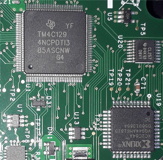

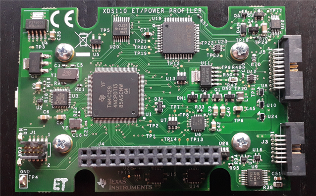

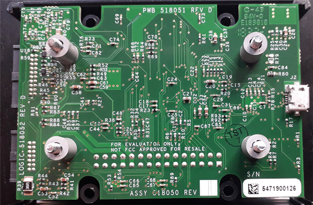

Inside
I've taken some pictures of the internals.

    That is odd. Maybe the evaluation board passed with flying colours and the decided to churn them out without updating the silkscreen. "Nobody would open it up anyway." I'm not sure why but I'm surprised…

    This is strange on a not-for-evaluation product pcb

    drac98  wrote:
    I need to debug the Beaglebone Black (BBB) using debug. I got a TI Lanuchpad CC1310
    BBB has a cTI 20 pin.
    Launchpad's XDS out has a (ARM) 10 pin.
    Can I wire them up point to point by looking the pin layouts in here?
    Will it work or do I need an adapter or a breakout borad (I don't know the difference)?
    I remember trying to use a Launchpad's debugger by soldering a ribbon cable to the BBB, failing to get it working, and then buying an XDS110. I think the problem ended up being something else and the Launchpad should (in theory) have worked. I'm afraid I can't remember anything more than that though. It's certainly worth a try if you have the time to try it.
