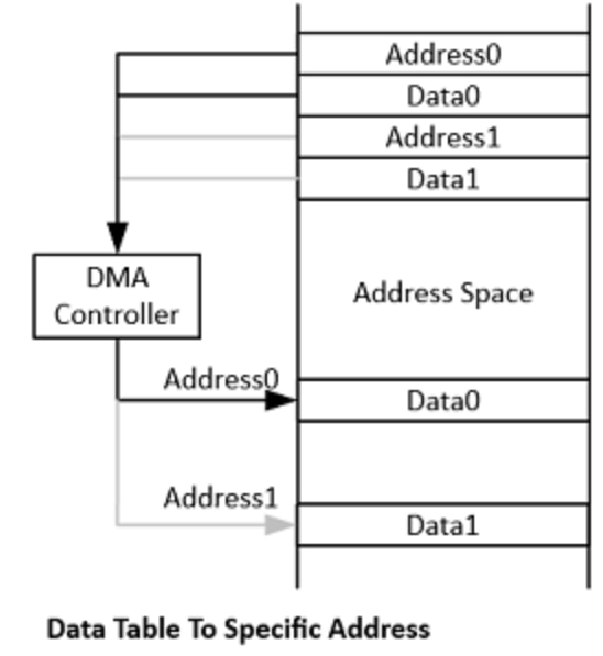

The DMA engine of the MSPM0 can move data between memory locations. In this example, a table of data is DMA-moved to address locations in SRAM. The name of the example in TI resource explorer is dma_table_transfer.
DMA is set up in extended data table transfer mode.

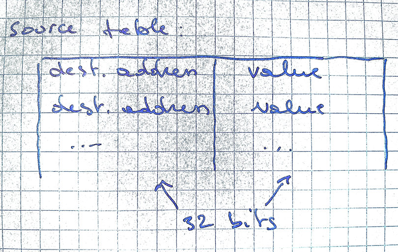

In this mode, the source table exists of records that contain the data value, and the SRAM destination address where DMA should copy the data to.
image source: MSPM0 Academy
The destination are 4 variables. This is where the DMA engine will eventually copy the table data to.

The source table is memory array with each time a value and destination address:
__attribute__((aligned(8)))
const uint32_t gTableData[DMA_TABLE_ENTRIES * 2] = {
    (uint32_t) &gDstData1, 0x10101010,
    (uint32_t) &gDstData2, 0x20202020,
    (uint32_t) &gDstData3, 0x30303030,
    (uint32_t) &gDstData4, 0x40404040

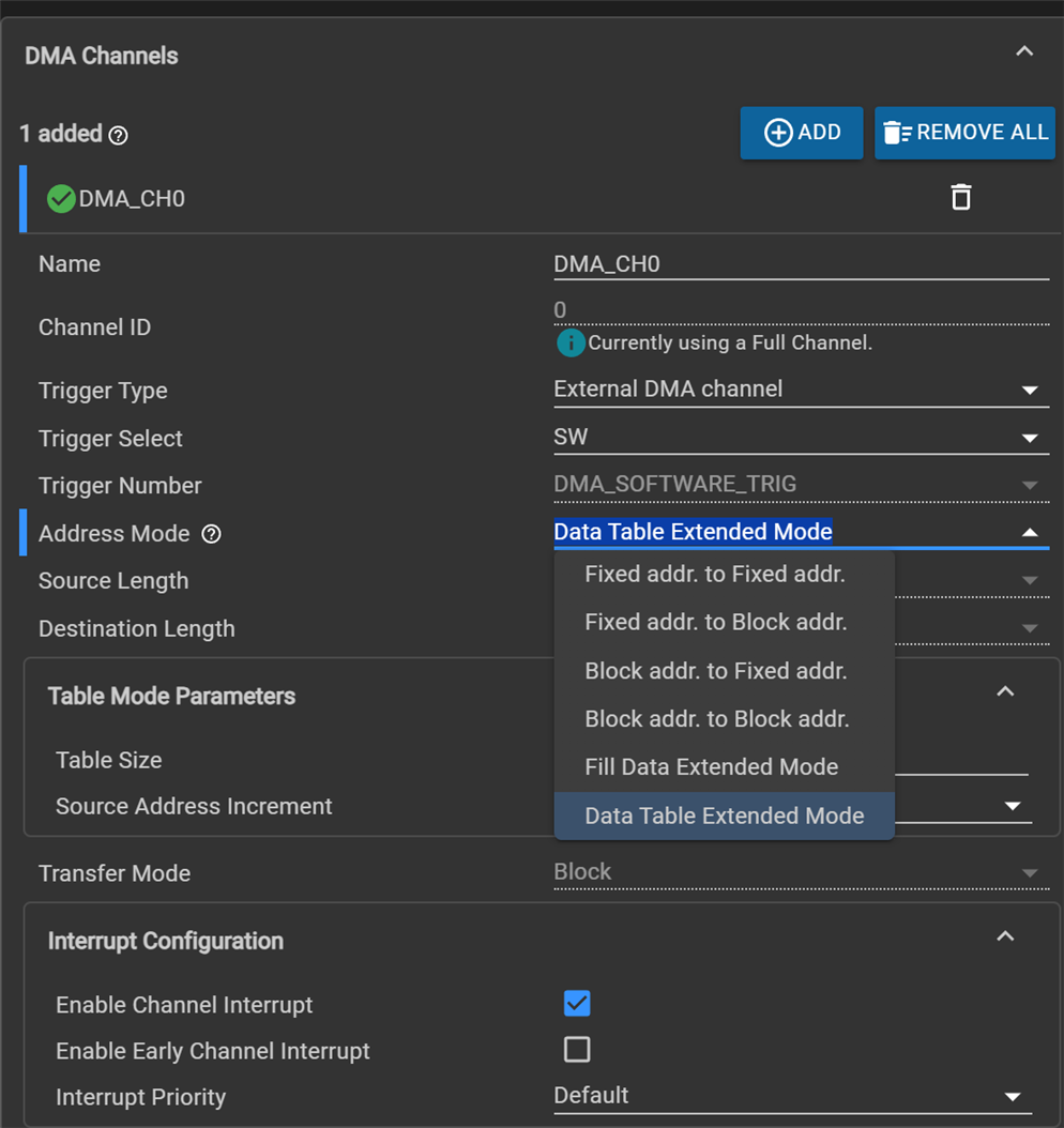

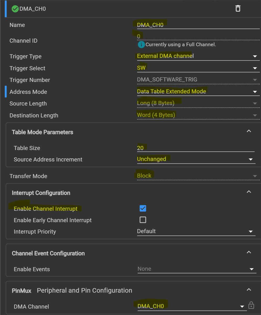

The DMA engine initialisation code is simple. Note that there are other initialisation settings done in the system configurator.

In the config, source length is 8 bytes and target length 4. In reality, the data size is 4 bytes for both. But the source record also contains the destination address.

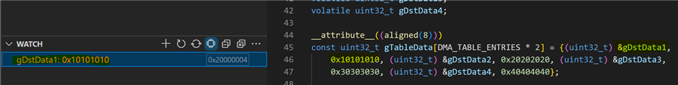

That's it. TI's example code includes integrity checks, for demo purposes. Read the full code in the resource explorer.
