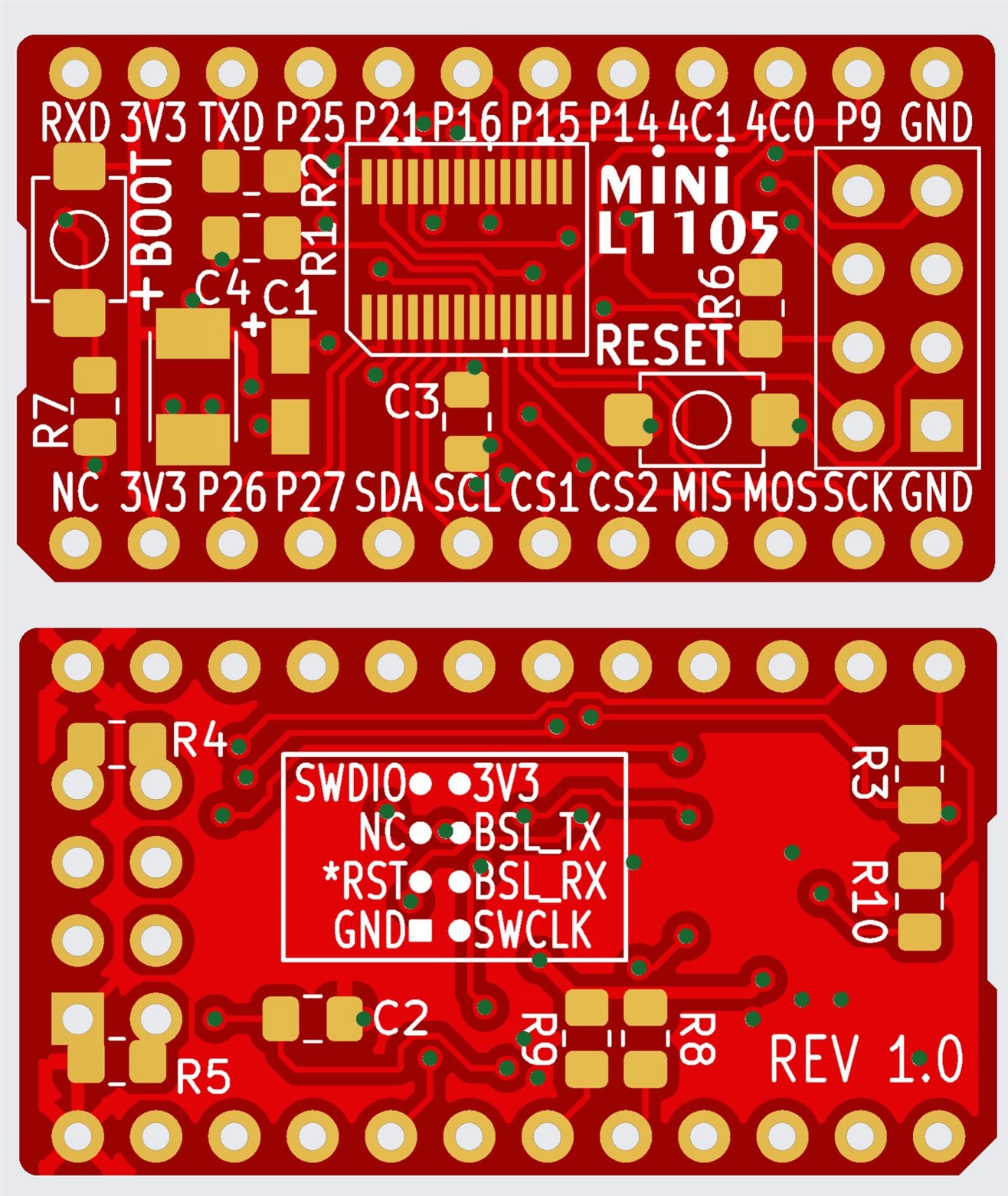

Circuit Board
An approximate render of the circuit board is shown below; it is about 60 x 40 mm.
Underside:

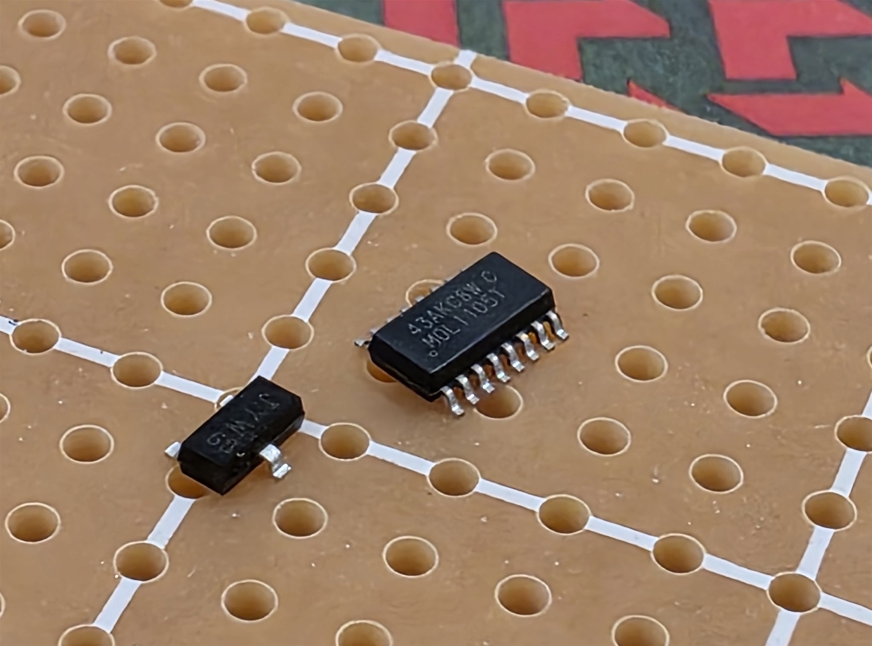

    shabaz 6 months ago +1
    Maybe worth mentioning how I'm soldering this. Apologies for the low-quality photos, they were taken with mobile phone. I used a small bent-conical tip, but it's not that critical. First step, apply…

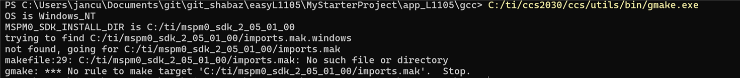

    Jan Cumps 6 months ago in reply to Jan Cumps
    I found TI's github repo for the SDK. That has the imports.mak* files

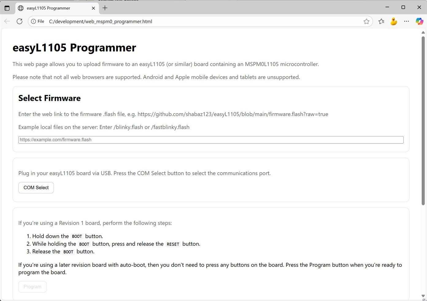

    shabaz 6 months ago in reply to Jan Cumps
    I forgot to add a link earlier, the Python programmer is here.
    Also, preview of the web programmer (kind of on hold for now, in principle it can work, since the code does currently successfully send a message to the MSPM0 chip's bootloader and gets a message back, but I need to implement the rest. Plus the web page looks ugly and not end-user-friendly, it needs a serious look at ease-of-use.
    fixed with the latest make file version

    Opened serial port COM19 at 9600 baud.
    Hold down the BOOT button and then RESET the chip, then release the BOOT button. Press Enter to continue...
    Sending Connection Command (0x12) to MSPM0 chip
    Waiting for response from MSPM0 chip
    Issuing Get Device Info Command (0x19) to MSPM0 chip
    Received Device Info: 000819003100010001000000000100c0066001002001000000010000004961578c, length =33 bytes
    Unlocking Bootloader (0x21)
    Bootloader unlocked successfully
    Performing Flash Range Erase (0x23) operation(s)
    Entry 0: Address: 0x00000000, Length: 608 bytes, Erase Start Block: 0x00000000, Erase End Block: 0x00000000
    Erasing Flash block: Address 0x00000000, length 1024 bytes
    Sending Flash Range Erase command: 800900230000000000040000ebfd83a5
    1 Flash Range Erase operation(s) completed successfully
    Programming Data (0x20 operations) to MSPM0 chip
    Programming Data Entry 0: Address: 0x00000000, Length: 608 bytes
    1 Data Programming operation(s) completed successfully
    Sending Start Application Command (0x40) to MSPM0 chip
    Application started on MSPM0 successfully
    Closed serial port COM19.
    Programming complete.
    The blinky started immediately after that.
    Windows PowerShell Experience
    locations:
    GCC_ARMCOMPILER_MSP: "C:/Users/jancu/Documents/toolchains/arm-gnu-toolchain-14.3.rel1-mingw-w64-i686-arm-none-eabi"
    MSPM0_SDK_INSTALL_DIR: "C:/ti/mspm0_sdk_2_05_01_00"
    make: C:/ti/ccs2030/ccs/utils/bin/gmake.exe
    Looks like an SDK difference, although the version and location seem to be identical to the one you refer to in the github README: C:\ti\mspm0_sdk_2_05_01_00 .
    The SDK root I have doesn't contain imports.mak.windows, or any another imports.mak* file...
    I added some log messages to the makefile. It gets the correct OS, knows the SDK root, but fails because the .mak.windows file or .mak file isn't there
